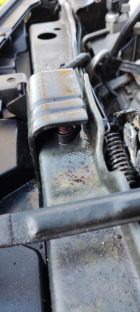

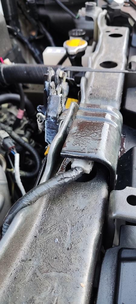

What's this "sensor" for? Attached to cross member in front of radiator under the ribbed cover.
It isn't physically attached to anything other than cable and plug. Looks to be proximity? Checked for any warnings with bonnet open, non.
My first guess was a 'door open' switch, but as mine isn't triggered by the bonnet being open I expect it's not. I have just been out in the car and noticed the front few inches were in the sun whilst the rest was in shade, in the garage and the outside temperature was reading 15c, so that's my next guess, the outside temperature sensor.

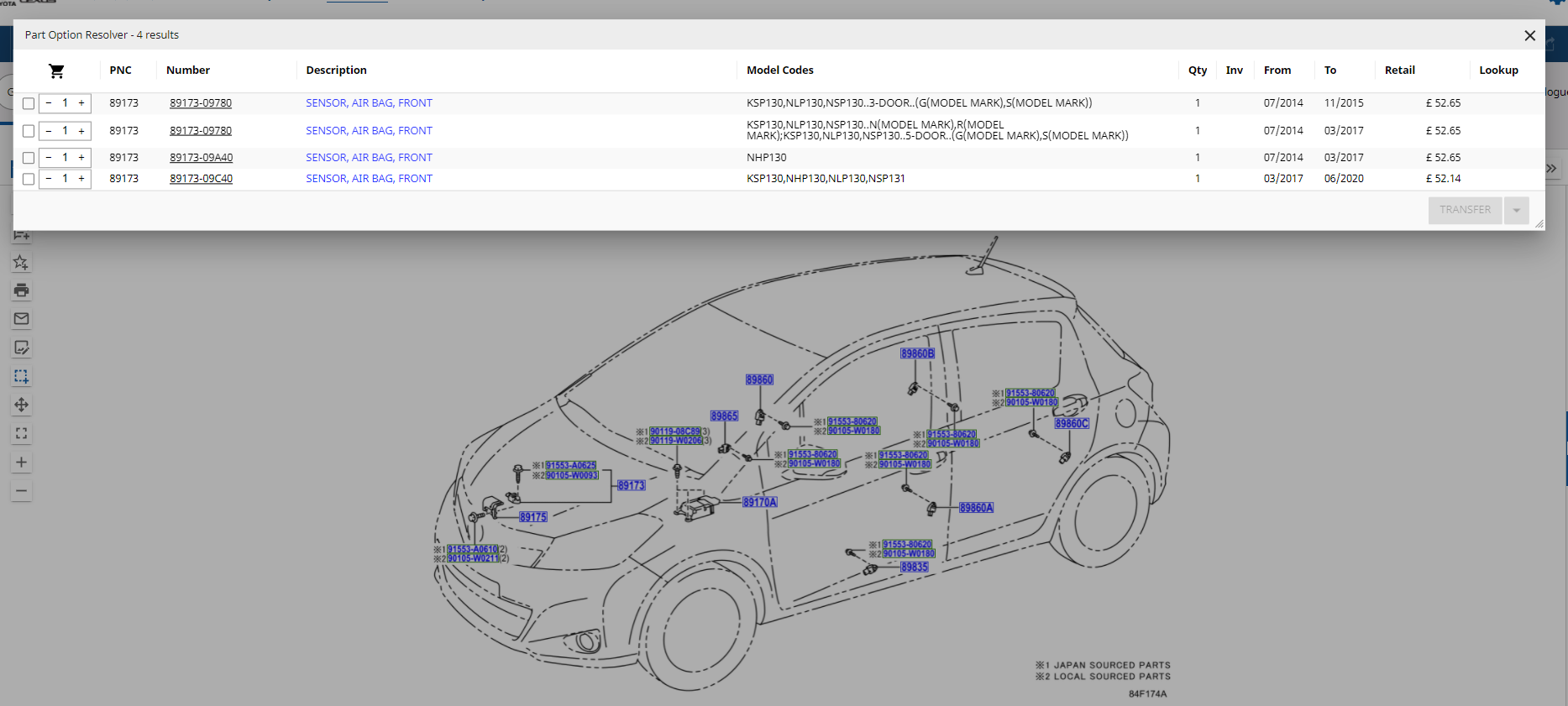

The sensor at the front is a "crash" sensor, it detects impacts and g forces for the airbag system
any sort of suspension work can throw the tracking out
Thanks for the replies. I hadn't even considered a "crash" sensor! Makes sense. I thought initially a proximity sensor for the bonnet.
Yes, I was always under the impression that any work to suspension etc. could affect things. I'm surprised they didn't advise checking. I partially blame myself for not enquiring too.
I'll be phoning them tomorrow to organise an alignment check and adjustment.

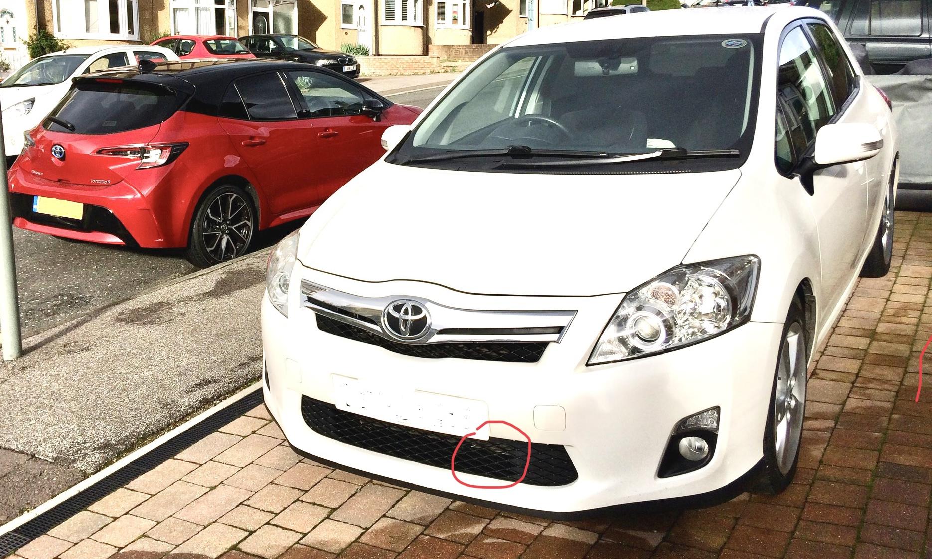

I wonder where the outside temperature sensor is?
Front bumper , front of the radiator somewhere.

Its an impact sensor for the SRS airbag system
