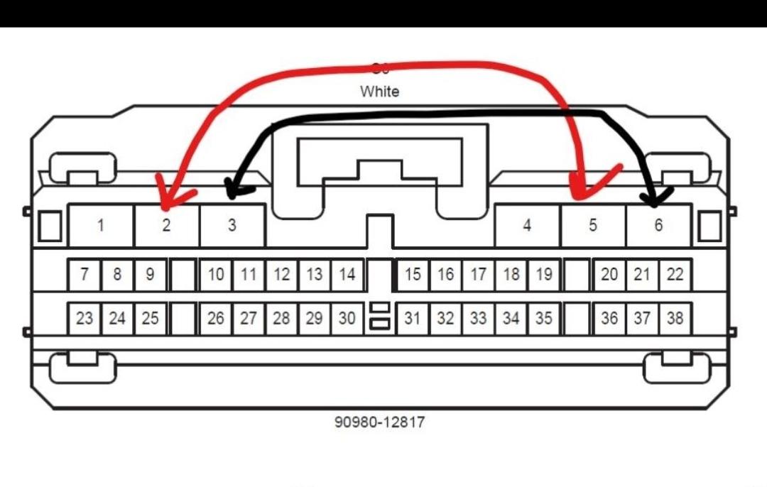

Have you tried it, tho ? If the module passes thought the audio it just needs a bypass
sos usually has its own speaker
19 minutes ago, flash22 said:
Pins 2 and 3 input, 5 and 6 output
modules are usually the same pin out, but colours may be different
C-hr DCM pinouts
https://www.tochr.net/379/terminals_of_ecu.html
This can be done in headunit part or directly in DCM after unplug,
The second thing I can't understand these code pins, how to find ?
Thanks
Look at the link ? its at the DCM - pinouts are as you look at the connector or wire side of the plug

As i stated, un plug it and link the speaker
C-hr DCM pinouts

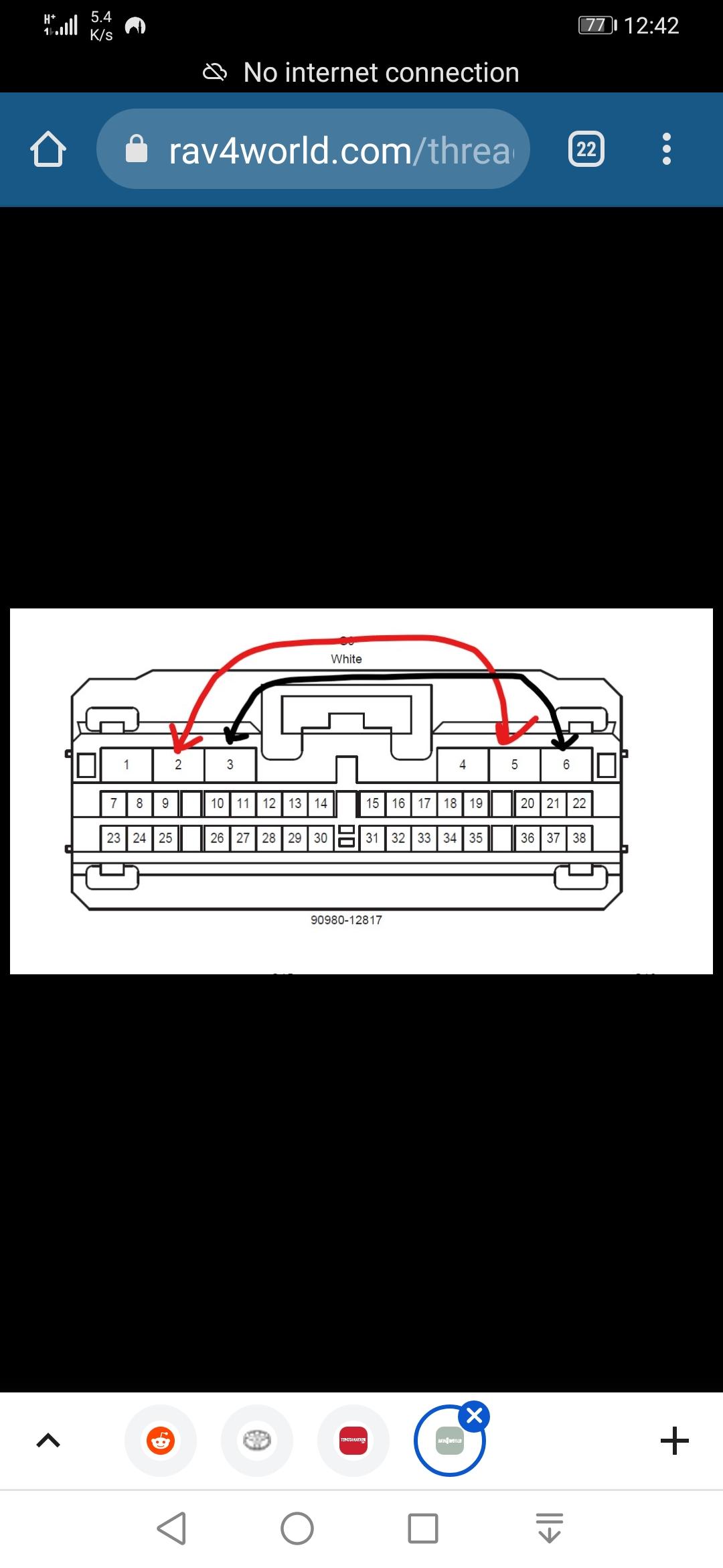

In another place has been mentioned and claimed has been tested to join the folllowing pins as in the picture but that might be of another toyota model?
yes, un plug it and wire it as you see, the modules are the same design across the range
