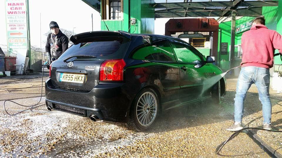

Pete,
The standard T-Sport and Compressor shocks are different and Toyota will charge you the earth for a set of Compressor shocks.
I wanted a set 6 years ago and they quoted me £1500.00!
So, I bought a set of BC's... Car handles and looks 100%
https://gt4-play.co.uk/shop/bc-racing-coilover-suspension
Toyota know how to charge, the springs are the expensive part, the shocks are more than likely KYB i cant see them being much different as there is not much weight difference
The BC shocks fit the T Sport
Eibach springs should give you the same ride height as factory with standard shocks
