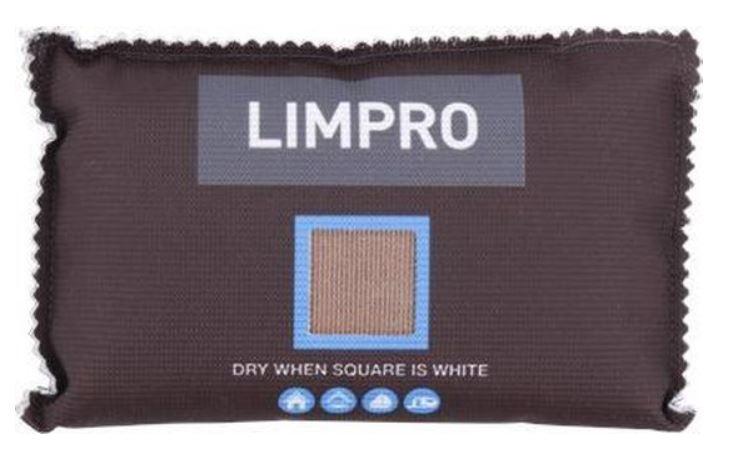

I wrote about almost the same problem since I had the car for the first day at the start of this winter. SInce the car was brand new, I don't suspect any leaks inside.
A few people here and in my neighbourhood adviced to put some bag near the front window with silicon gel or just a self made one with rice.
When it gets saturated you can put it in the microwave oven for 6 minutes and the moist is all gone.
As an extra, I cleaned my window well with a alcoholic solution (every grease removing product will do) and that has been enough to get me through the entire winter.
Greasy windows (dirty in general) attrackt a lot more moist and that also makes a big difference.
Here's a photo of the thing I bought. Seems to have gone in a new message..Sorry about that.

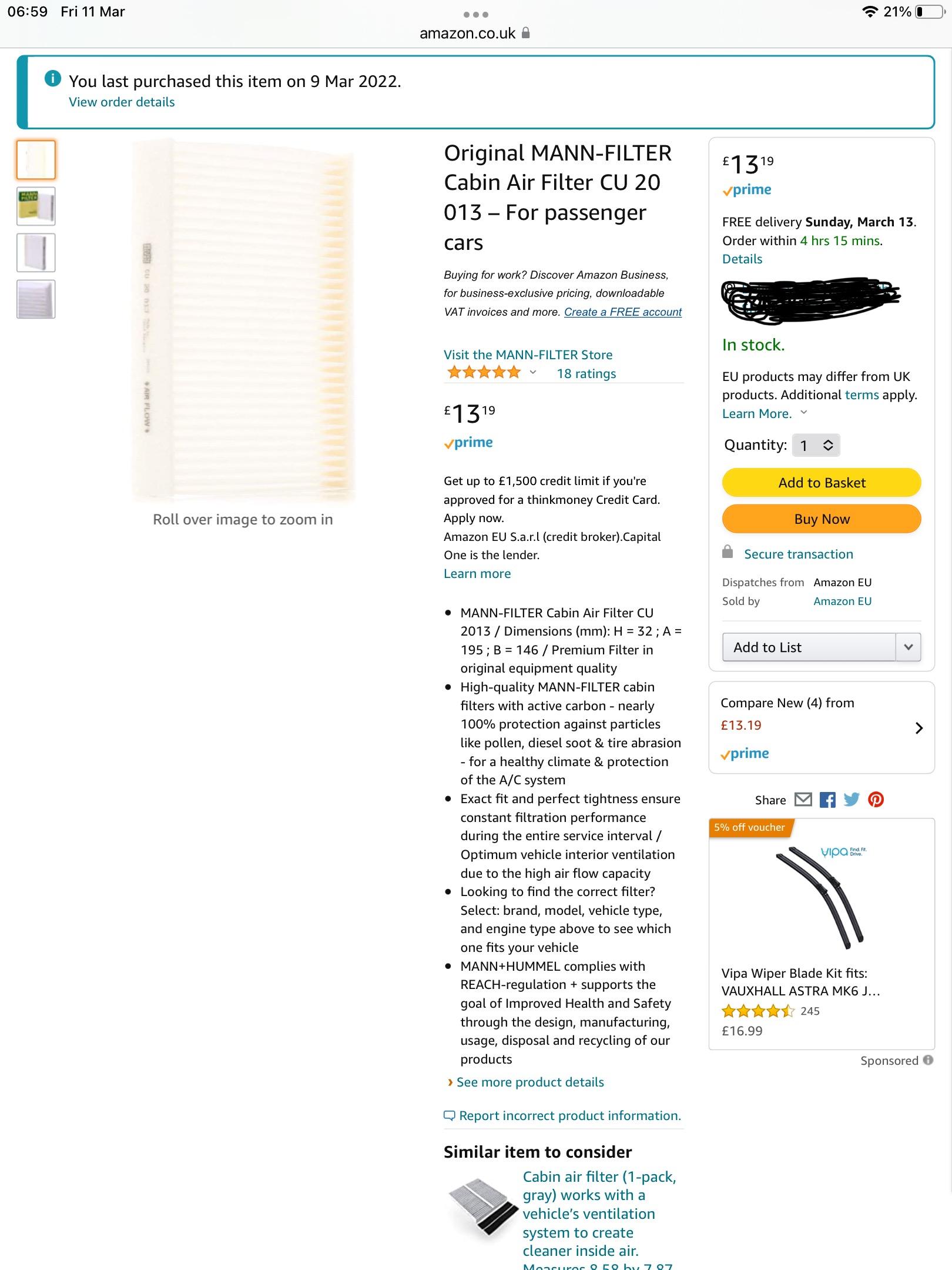

The new  cabin filter arrived Today …it has no marking on sides to show which way to put in ….
any help please
I got this one
