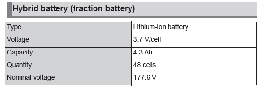

Spot on! I was a bit confused when I found out the Mk4 has a SMALLER Battery than the Mk3 (I think the Mk3 is 1.3kW NiMH, but the Mk4 only has a 0.7kW Li+! :eek: ), but I can't argue with the results! It does seem to cycle more often than previous hybrids, and I guess that, the beefed up motors and the weight saving have all helped!
Battery tech has come a long way in the last 10-15 years - not sure what voltage the MK4 pack runs at, but the cells are lighter and more energy dense
Yea, the blurb I have says it went from 144v in the Mk3 to 177v in the Mk4, so a bit of a jump but not huge. Pack is 10-15kg lighter and a lot smaller!

Sorry it is in Kw but, using Hybrid Assistant, I have seen 25Kw being fed back to the Battery during Regen braking... I never saw that kind of figure on my Mk3 Yaris...
Using good old Ohms Law, that means that 141 Amps was being fed to the Battery during that recharge period of regen braking (probably about 20 secs) and looking at how quickly the battery's SoC rose at the same time, I believe it to be true. (40% to 52% SoC)
Note that this is being spread across 48 cells of 3.7v each...
