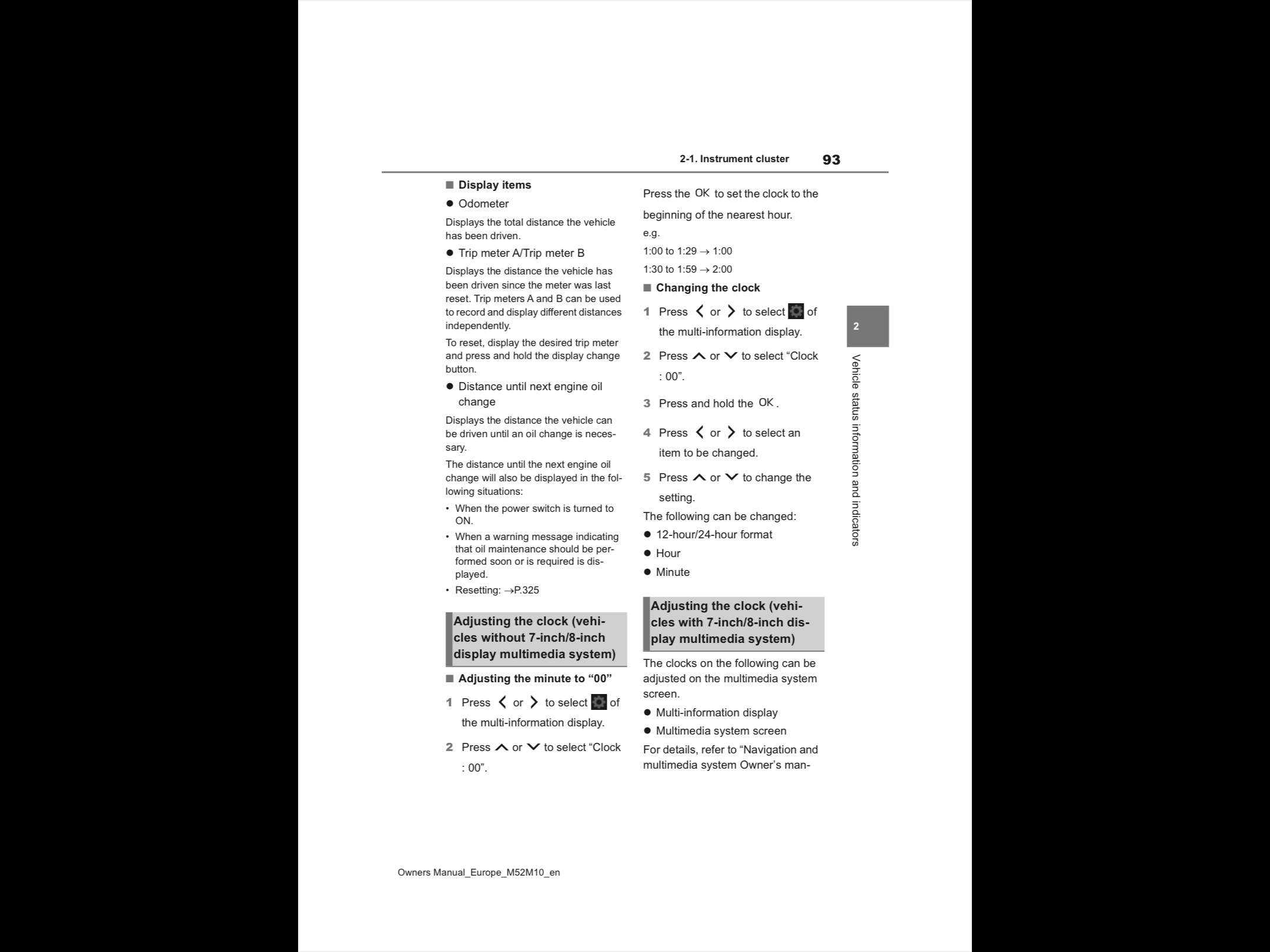

Any ideas how to change the time on a 9” multimedia screen. Manuals are throwing us back and fourth. Car is a Yaris Cross LX hybrid 2022.

I put an enquiry in to Toyota UK over a week ago pointing out that it was not covered in the car or 9" multimedia manual, this was their reply -
Thank you for your email regarding your Toyota Yaris Cross.
The clock can only be adjusted via the steering wheel within the multi-information display.
Many apologies for the owners manual not being clear as the multimedia manual for the Smart Connect system advises you to refer to the owners manual.
I will make sure to share your comments to the relevant team.
Thank you for contacting us at Toyota.

Checking in the online manual for the 9” unit (TAS600) there isn’t any mention of changing time via the smart connect system.
I changed the time on mine via the centre MID screen as per the reply from Toyota GB.
In the settings cog it’s actually the first option in the horizontal list but is partially hidden by some text so is easy to miss.
Try again and you should see it and then make changes.
