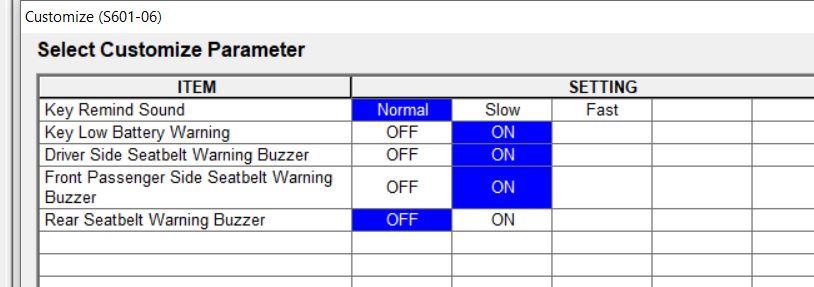

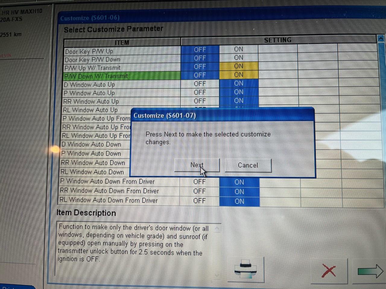

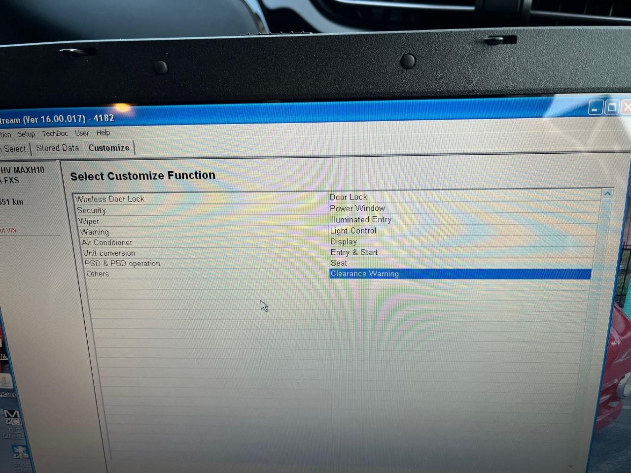

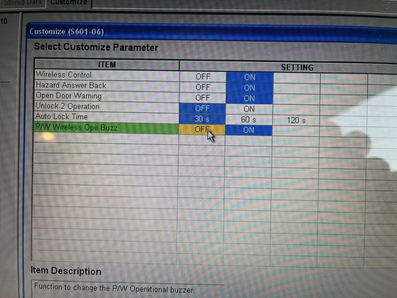

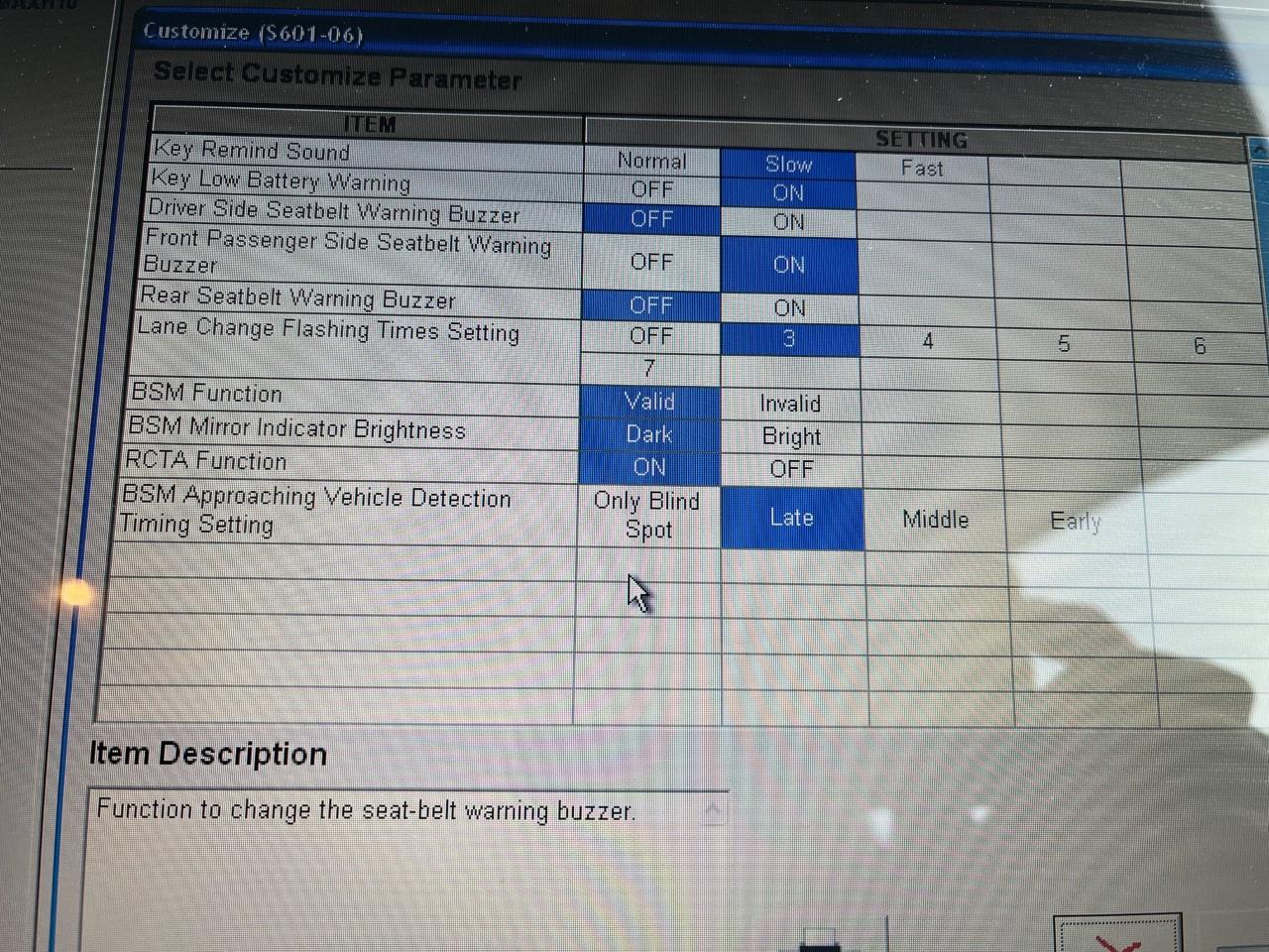

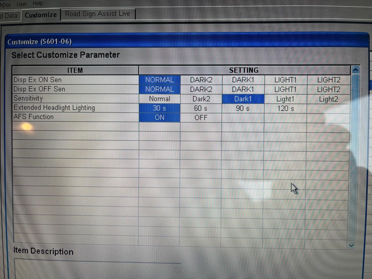

Hi guys,
Not sure if you know, but global open/close of the windows can be enabled using techstream.  Also other settings one could play about with.  See (poor quality) pics...
