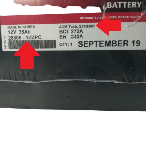

you supplied the Model number  S34B20R, what is Toyota part No. 28800YZZPC see the pic below (click to enlarge)
TOYOTA-AURIS-HYBRID-12V-BATTERY-28800-YZ

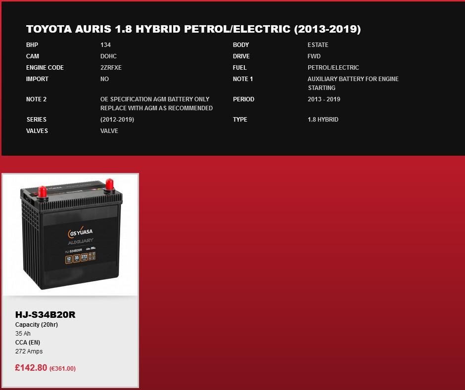

That's the incorrect Battery for the op's car, as the L is a left hand negative (HJ-S34B20L-A) - the car is a hybrid, so it doesn't have stop/start, the aftermarket information is very hit-and-miss
from Yuasa's site

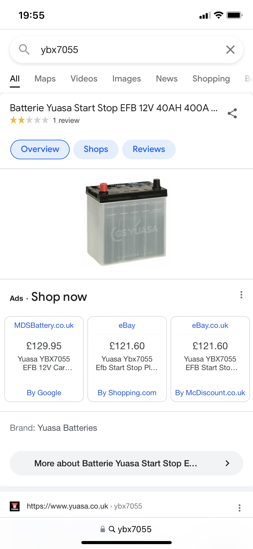

Sorry , just been on phone to a friend at yuasa and part number is ybx3055 should retail from £68.77 or it does up north

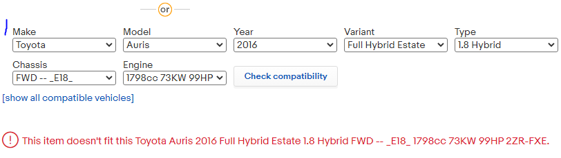

Flash22 - i went on the eBay page and after putting in my details -  it says it isnt compatible for my model?
You are not going to get a new 12v AGM Battery for your hybrid car for under a £100. Normal price for a Yuasa is £150+.

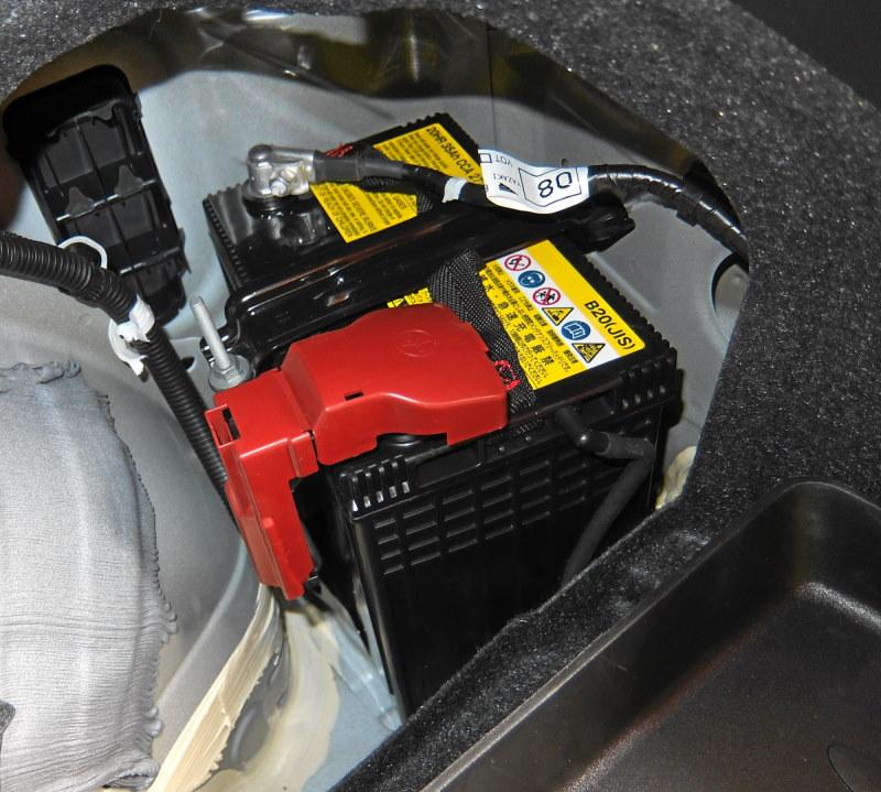

This is our 12v Battery in an 2013 Auris hatch.  It's the same one as yours, isn't it?  (Negative to the left, positive to the right.)
The B20 (JIS) number displayed on these batteries is the Japanese Battery size code, I think.  JIS = Japanese Industry Standard, fwiw.
Please read this thread as you clearly have not, YBX3055 is a lead acid, As i posted above, a snip from Yuasa's site for the correct AGM Battery

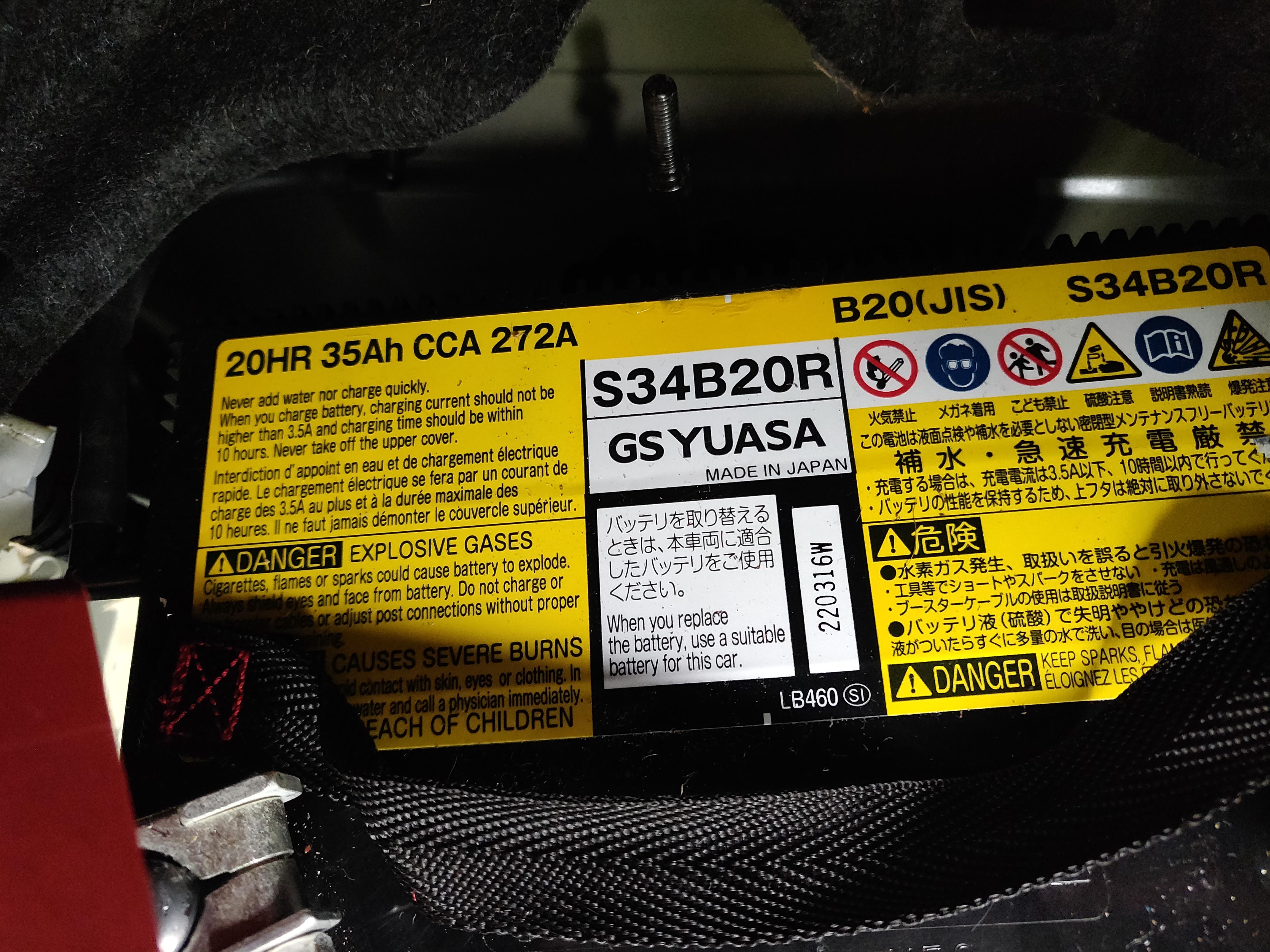

The OP has posted a picture of the Battery
IMG_20220404_122924.jpg.2b29f68ee3c67db8
S34B20R, what is listed as Toyota part No. 28800YZZPC - the original Toyota part number was 28800-21181
to further clarify, i posted the picture of the actual Battery - numbers now high lighted
TOYOTA-AURIS-HYBRID-12V-BATTERY-28800-YZZPC.thumb.png.556f8933f9804cfa8764b8b1d5661527.png

Flash22 - i went on the ebay page and after putting in my details -  it says it isnt compatible for my model?
those forms on eBay are just generic, so don't catch every model if in doubt ask the seller, i will drop you a PM
