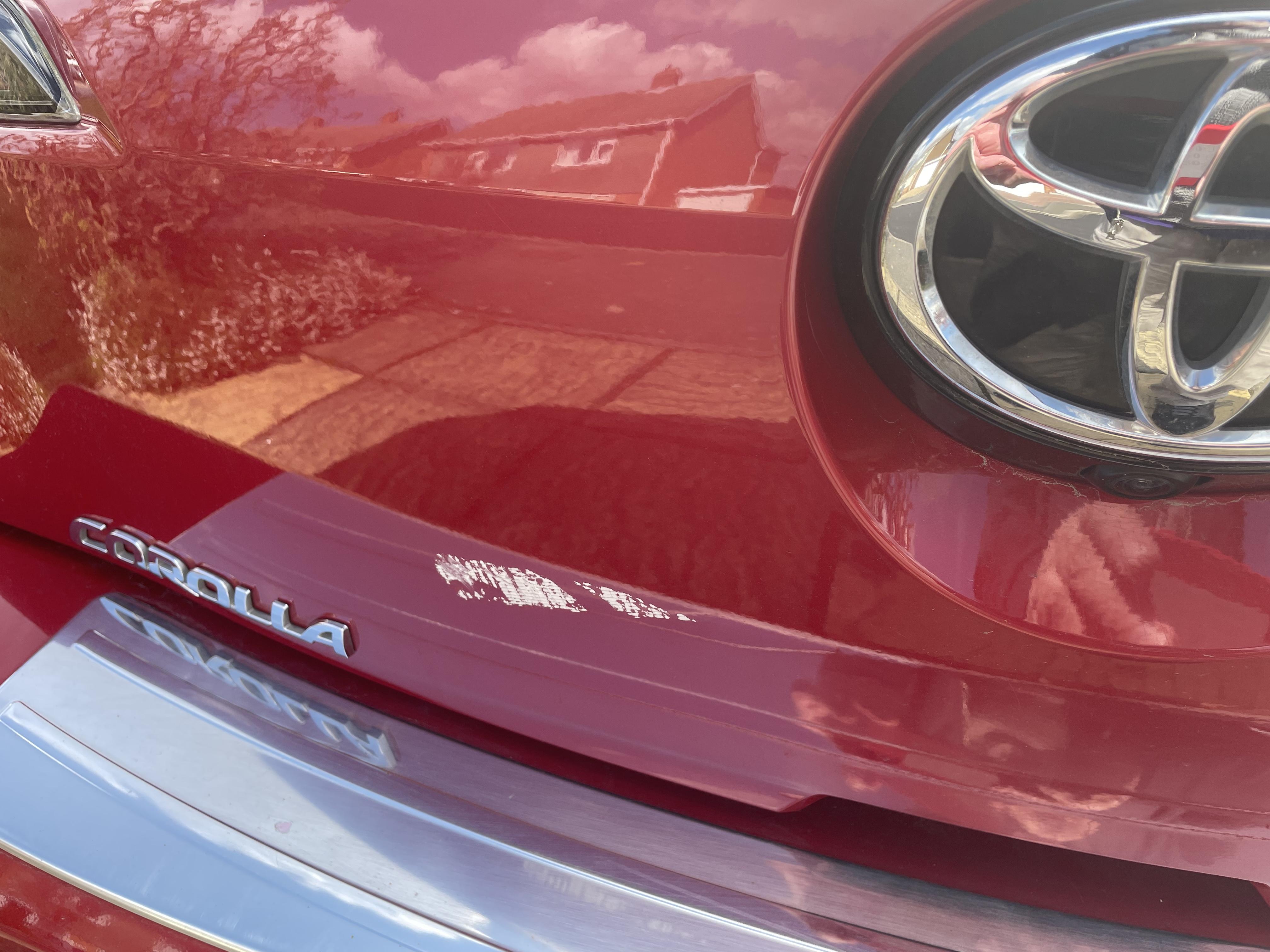

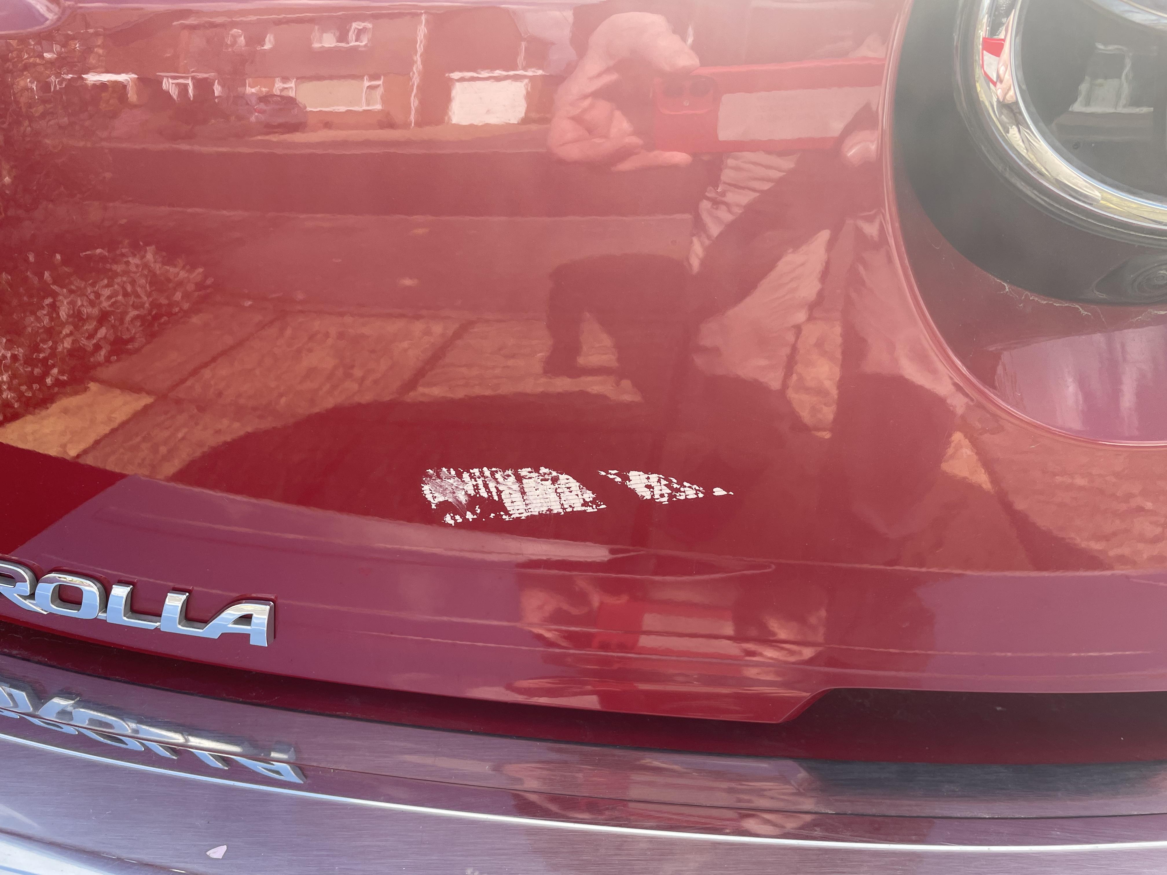

A while ago I posted an issue I had trying to stick magnetic L plates on my Corolla bonnet and boot lid. So having nothing to hand apart from a gobby daughter I used gaffer tape to fix the problem. I then set off a new chapter in my life in trying to remove the residue without damaging the bodywork constructed from unknown composite. Any suggestions gratefully accepted.🤔🙄 See enclosed pics.

WD40 seems to remove most sticky stuff, maybe worth a try.
Definitely WD-40, exactly as @50p says
13 hours ago, TonyHSD said:
If wd-40 can’t help you may want to try with tar and glue remover, this is also good for any paint contamination from road works. Trade Chemicals Tar and Glue Remover Car Valeting Ultra (500ml) https://www.amazon.co.uk/dp/B08ZN8MFJW/ref=cm_sw_r_cp_api_i_A7TNAP0KSZDY42N5N784
Tar and glue remover is very handy to have around, perfect for a job like this as Tony said.
