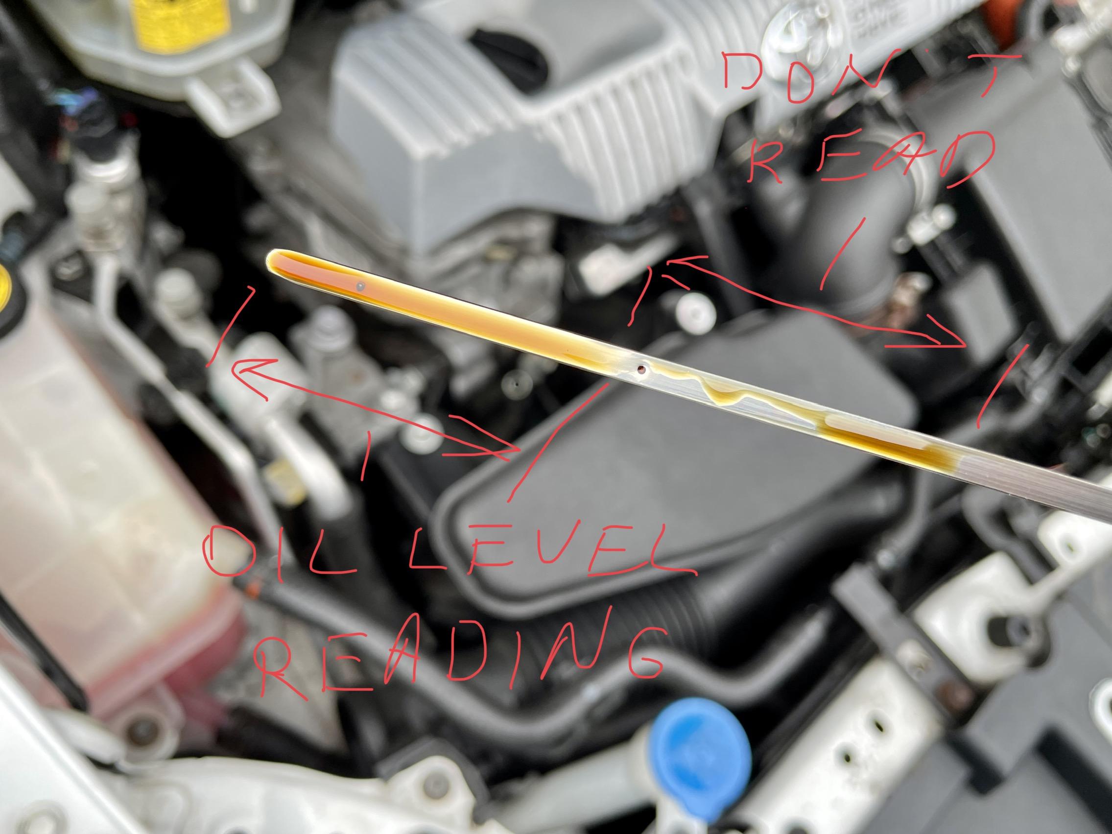

I am finding it hard work to check the oil level on the dipstick of my D4D 2010. The side facing the engine is showing just below minimum dot. Side facing radiator is smeared 2 inches above maximum dot.
The orange oil light has come on a for just a few seconds on the motorway before I topped it up.
Which side do I believe?
Thanks
Cyclopse
Yeah it's a bit of a pain that; I usually went with the lowest one but I checked my oil regularly so it was fairly easy to figure out which side was lying.
Also, the correct side should be level and even; The smeary side usually has several streaks, esp. near the edges, whereas the correct side will have a nice level line across the width of the stick.
You may have to wipe and re-dip a few times to get a better reading if there is a lot of oil smeared up the pipe!
Just be glad you have a D4D so the oil is visible - The 0w8 on my Mk4 is practically invisible!!
As per Cyker description only read the first continuous marks on the dipstick, anything after is just an oil marks left from the dipstick tube. 👍
Mine doesn't indicate like your picture Tony. the two "smears" of oil are connected when I check, usually the engine side. However, the other side has the oil up to the full dot. I go off that one.
No matter how long it sits 5min, 10min a day, and no matter how many times the dipstick is wiped it's always the same!
It must be the shape, length and size of the tube which allows oil to stick to it's sides when the dipstick is withdrawn.
It can't help that the tube extends to the bottom of the sump and always contains oil. Of course it has to be like that because the dipstick is so flexible.

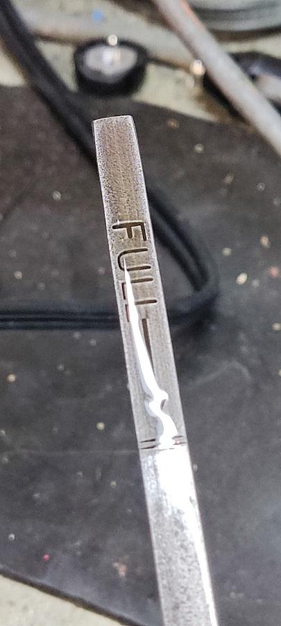

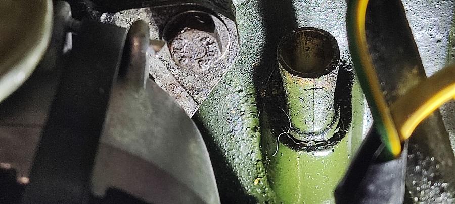

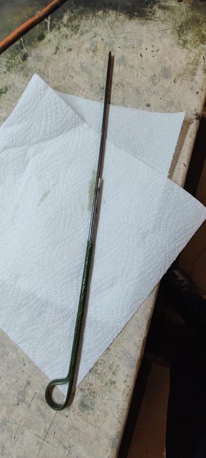

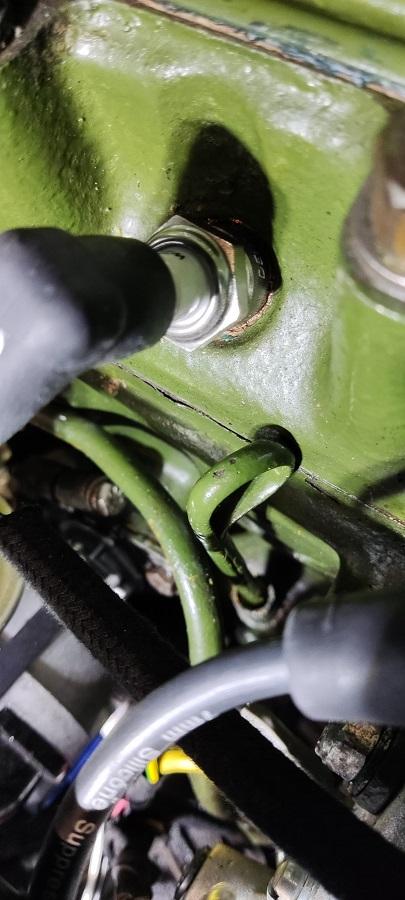

Here's a "proper" arrangement from 60 years ago.:laugh: The tube doesn't extend into the sump, no need, because the dipstick sits directly in the oil and is rigid. A perfect reading every time, on both sides of the dipstick.:ph34r:
