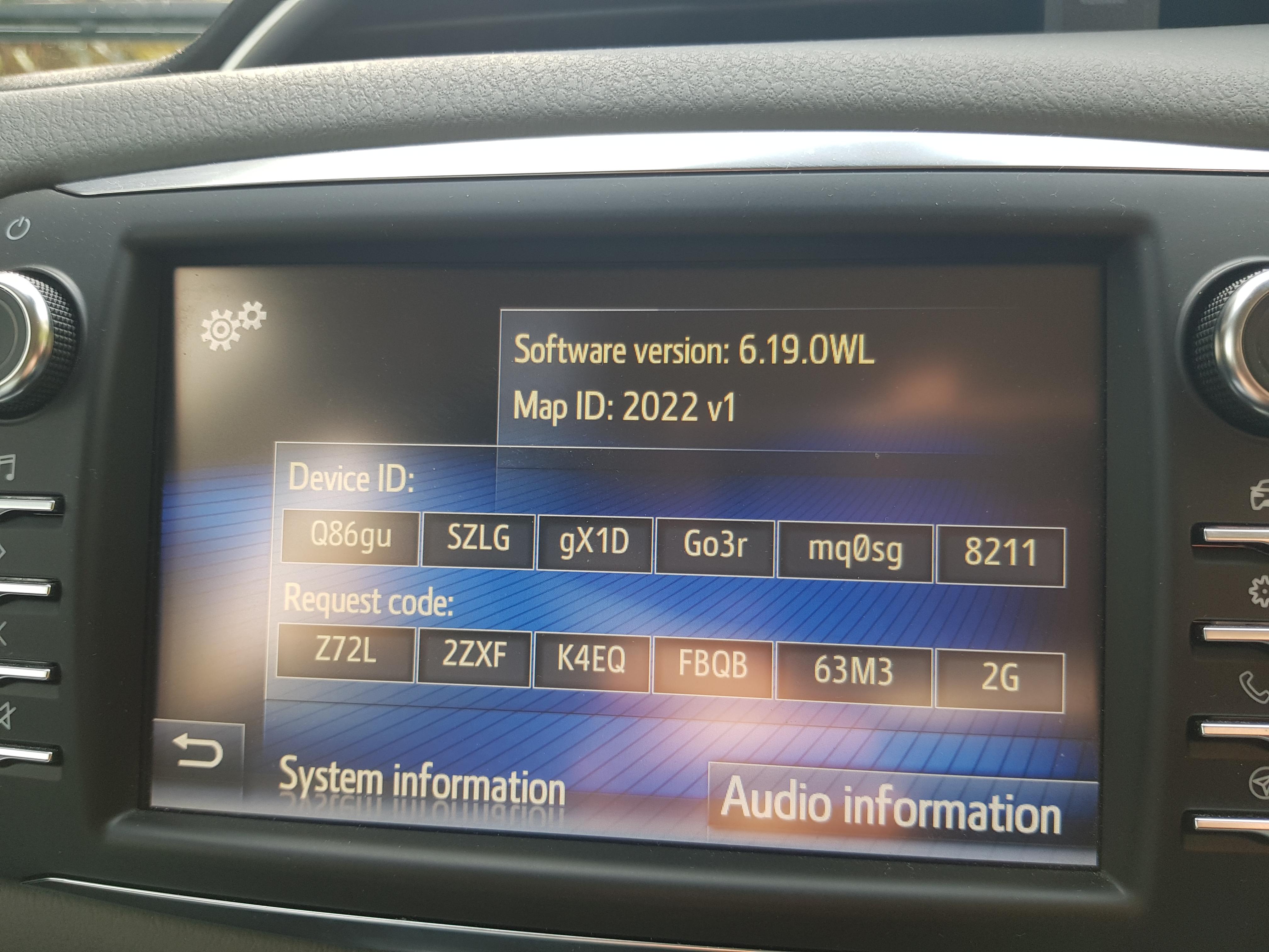

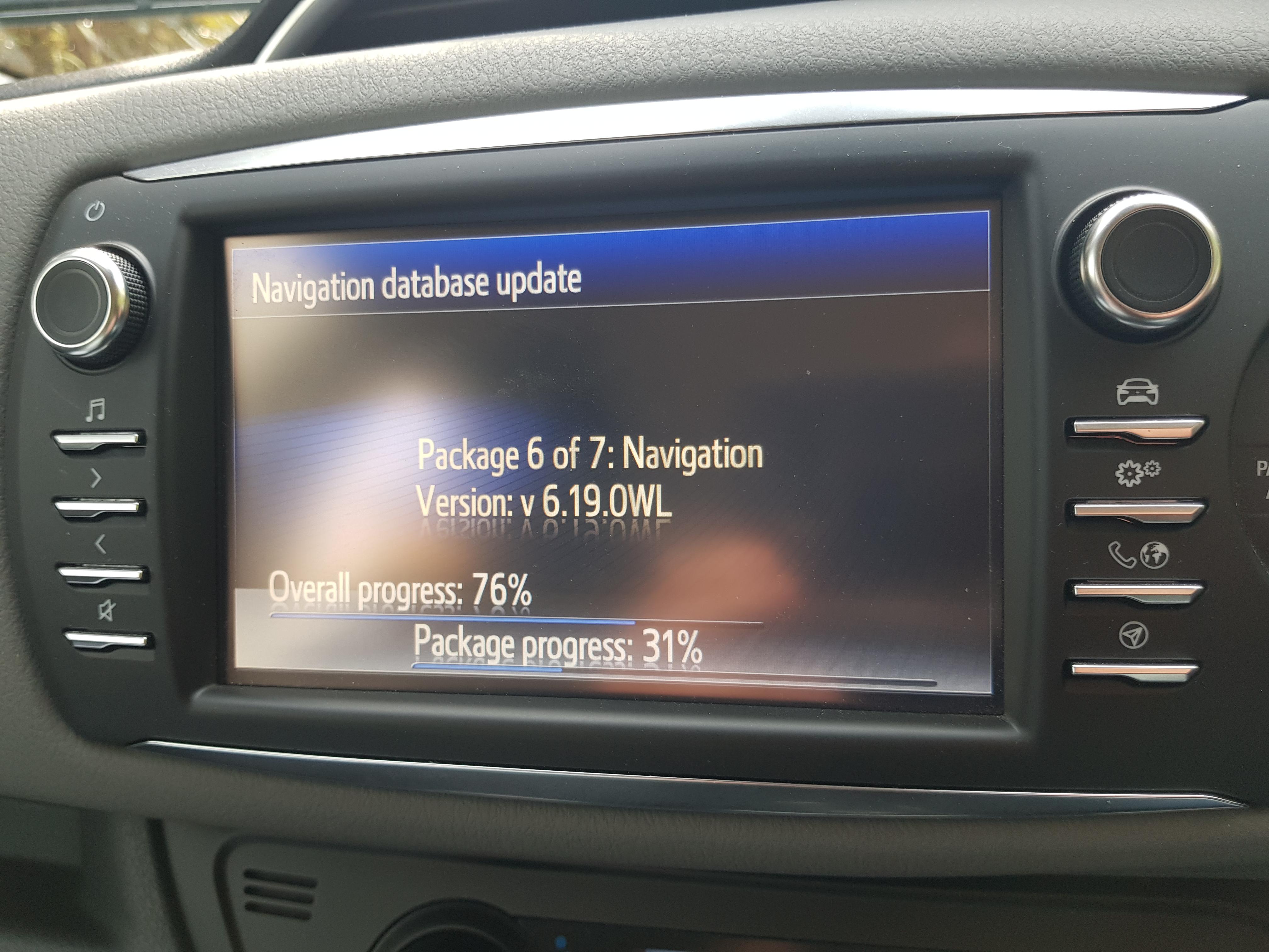

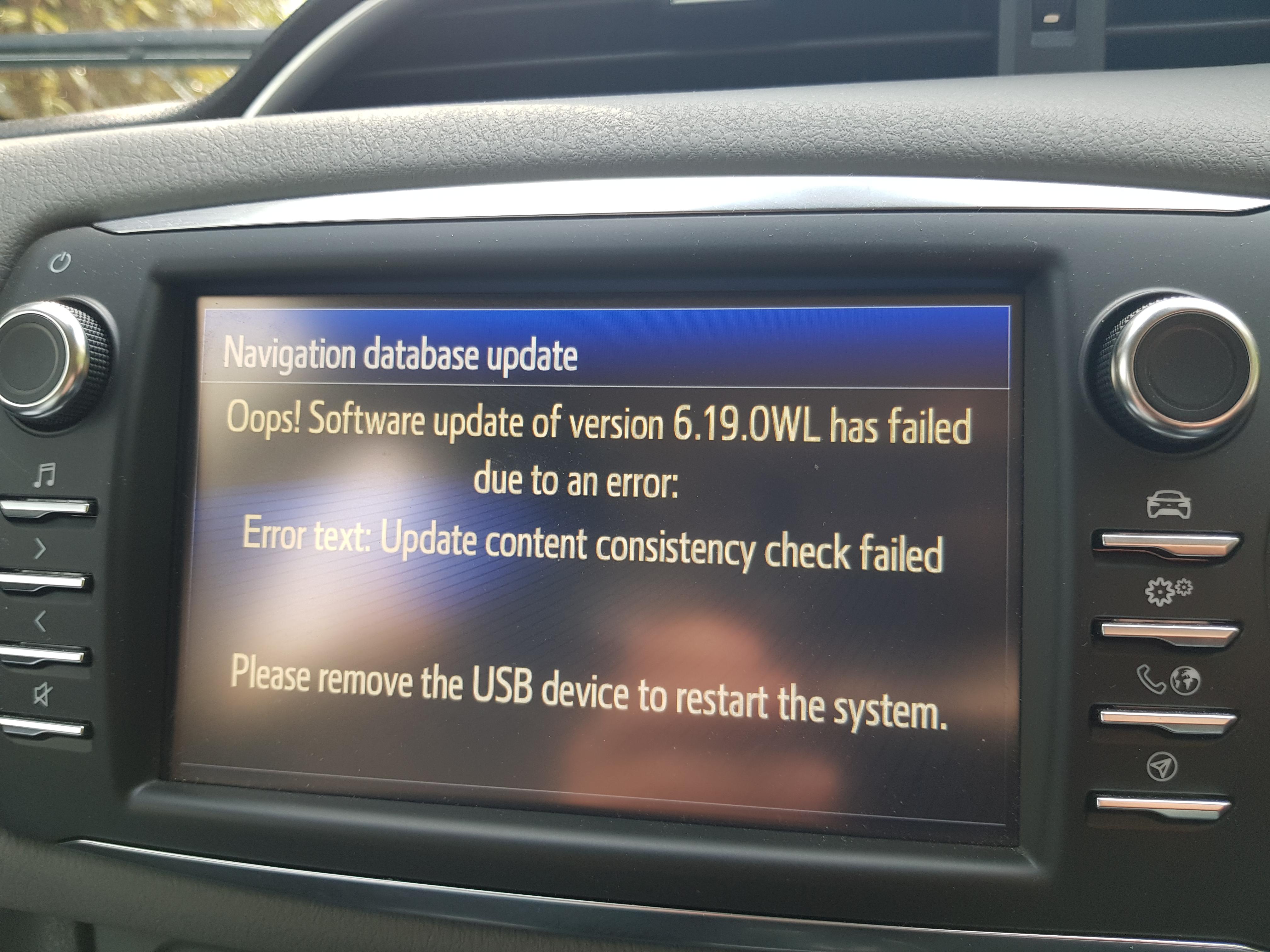

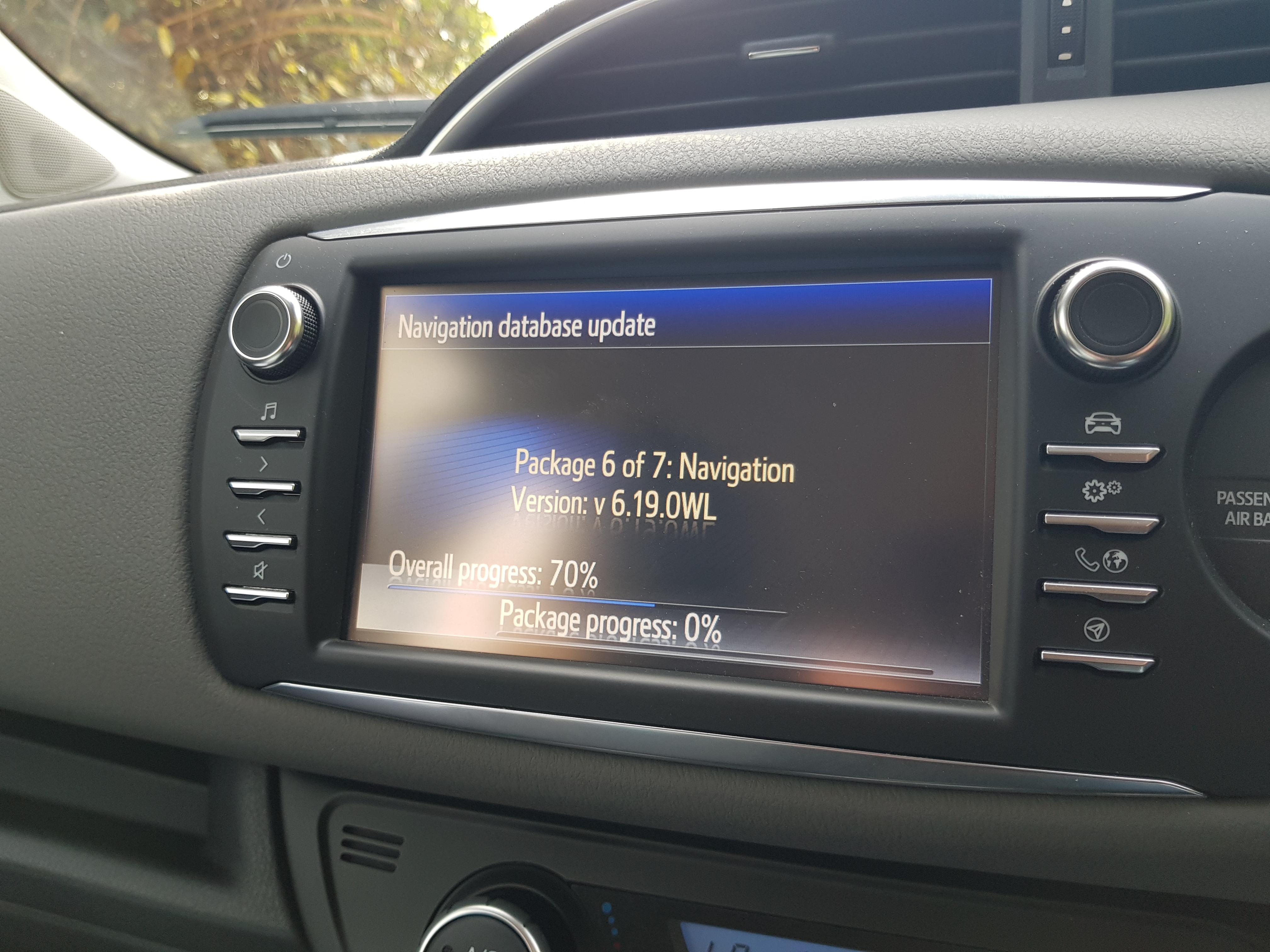

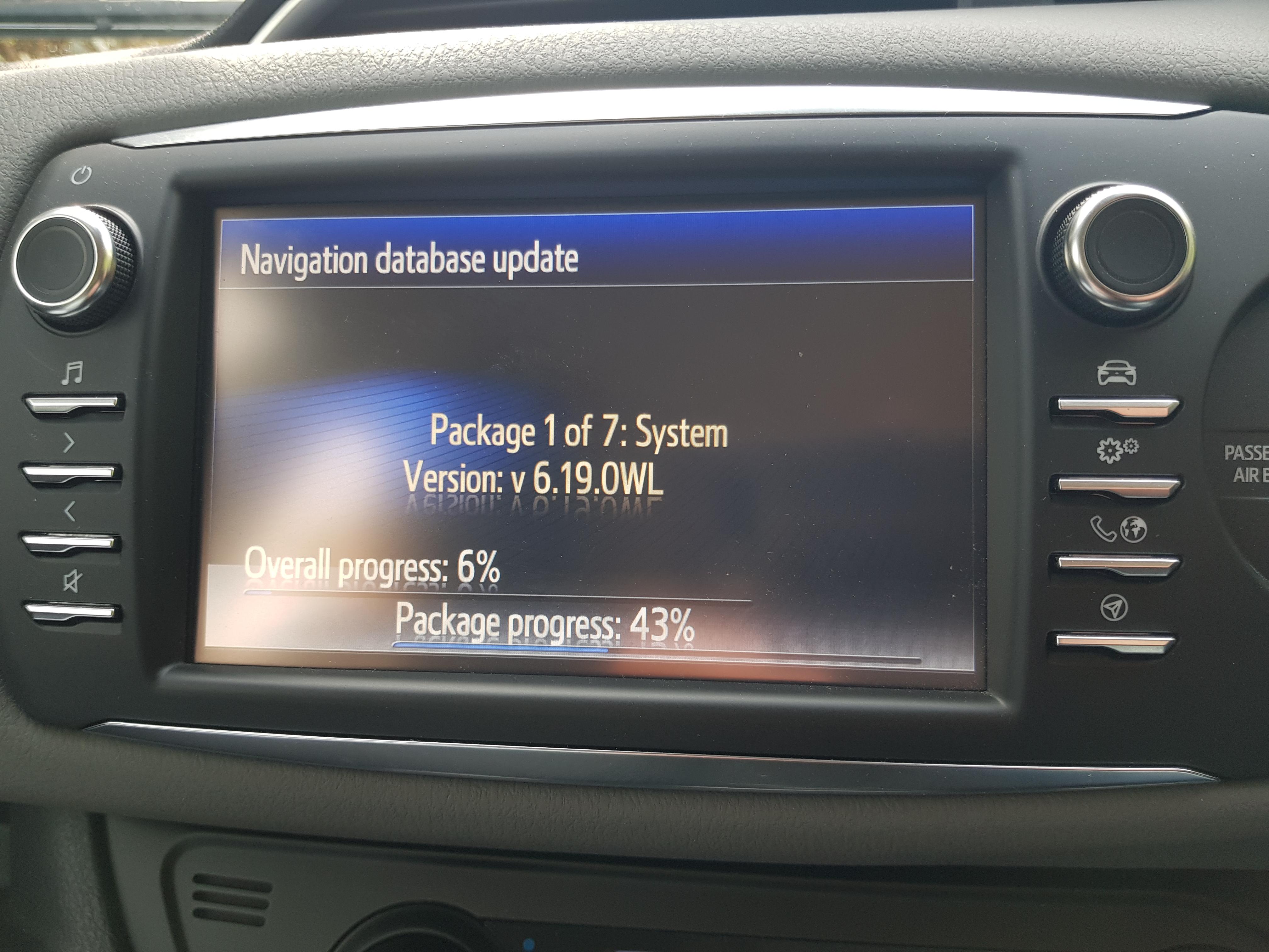

I am trying to install the latest Touch 2 Go update (2022 v1). I downloaded the 6.19.0L.zip file, transferred the contents to a USB stick and plugged it in. Everything seemed to be working ok until about 36% of the way through "Package 6 of 7: Navigation" when I got the error 'update of 6.19.OWL has failed: Update content consistency check failed'. Weird thing is that the System info screen shows me with the updated version.
The same thing happened with 6.18 when I tried to install it - I tried recopying the files to the stick, a different stick etc. I thought this time I'd see if anyone else has had the same problem and solved it.

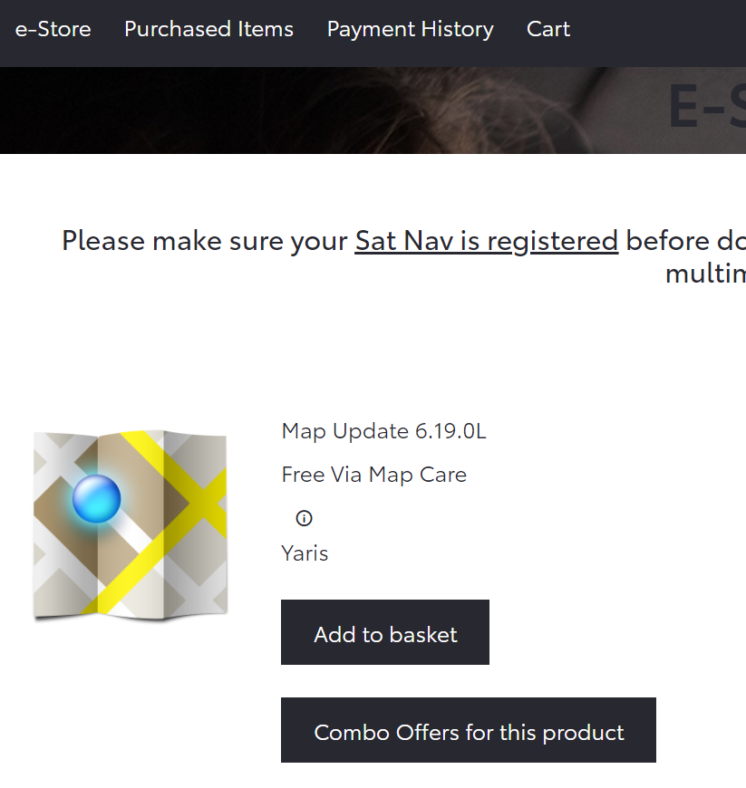

Where did you get this download from ?
I got it from the myToyota eStore:
Tony.
