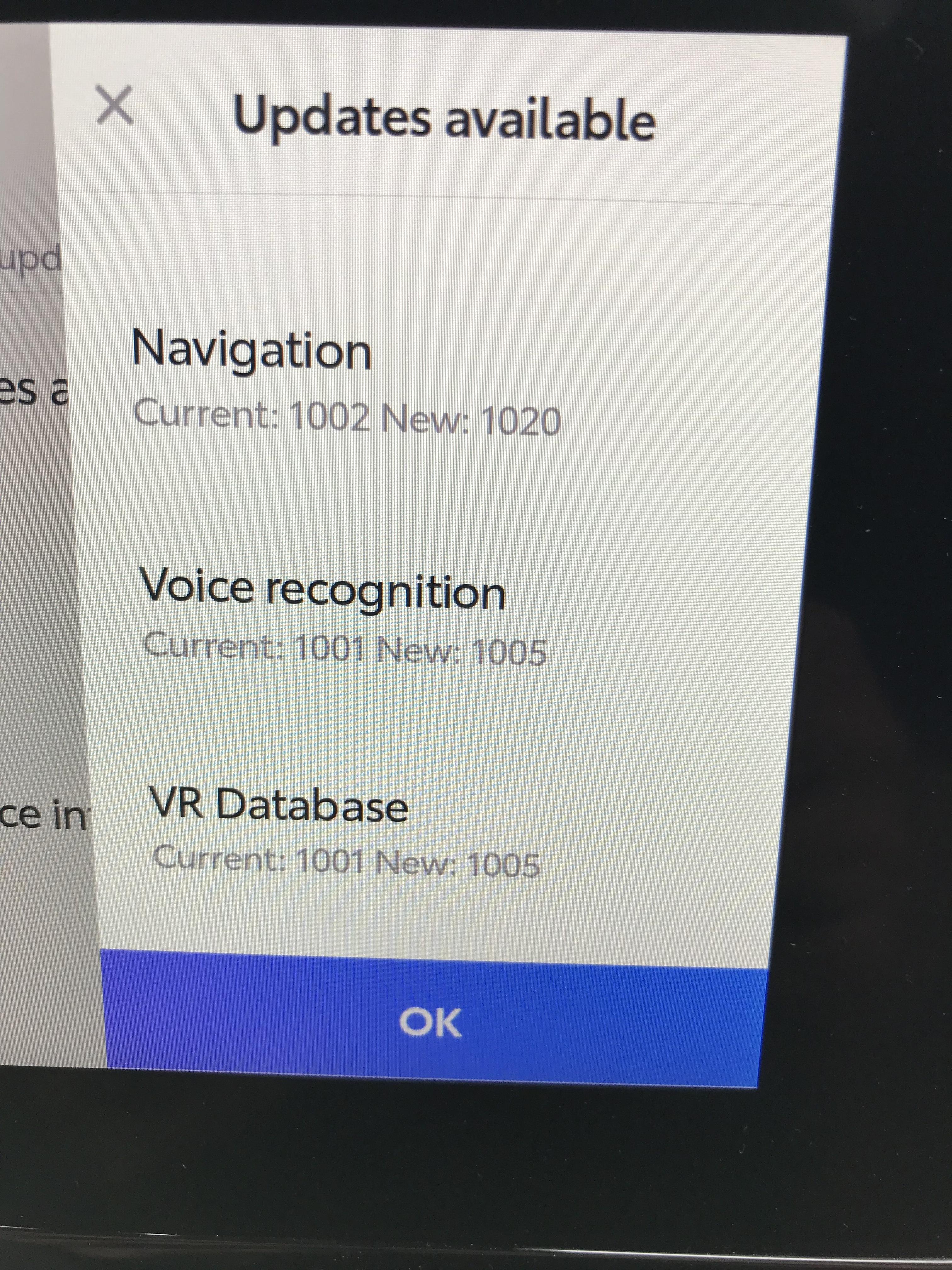

I am interested to know whether anyone with a MY22 Corolla has managed to update their software to the versions shown here. The navigation software must be the top one in the list (HU Software) under Model Info as that is the only one running version 1002 on my car.
Doesn't seem like anyone has, few others on here including myself have been struggling
Just checked mine and it shows HUSW is v 1020. There are many others with v numbers of 1001, 1005 and others. The car was manufactured 28 Jun. I am not aware that it has done any updates OTA so I presume that it came either this version. Are these system updates done by dealers? Maybe having this version is why I have not been having any of the profile issues.

Yes I think yours was probably factory installed with these updates as I heard they were released in June. Mine was built in May and I collected it on 13th June. It is persistently refusing to do the software update with Error Code 110 and is now booked into the local dealer have it sorted.
