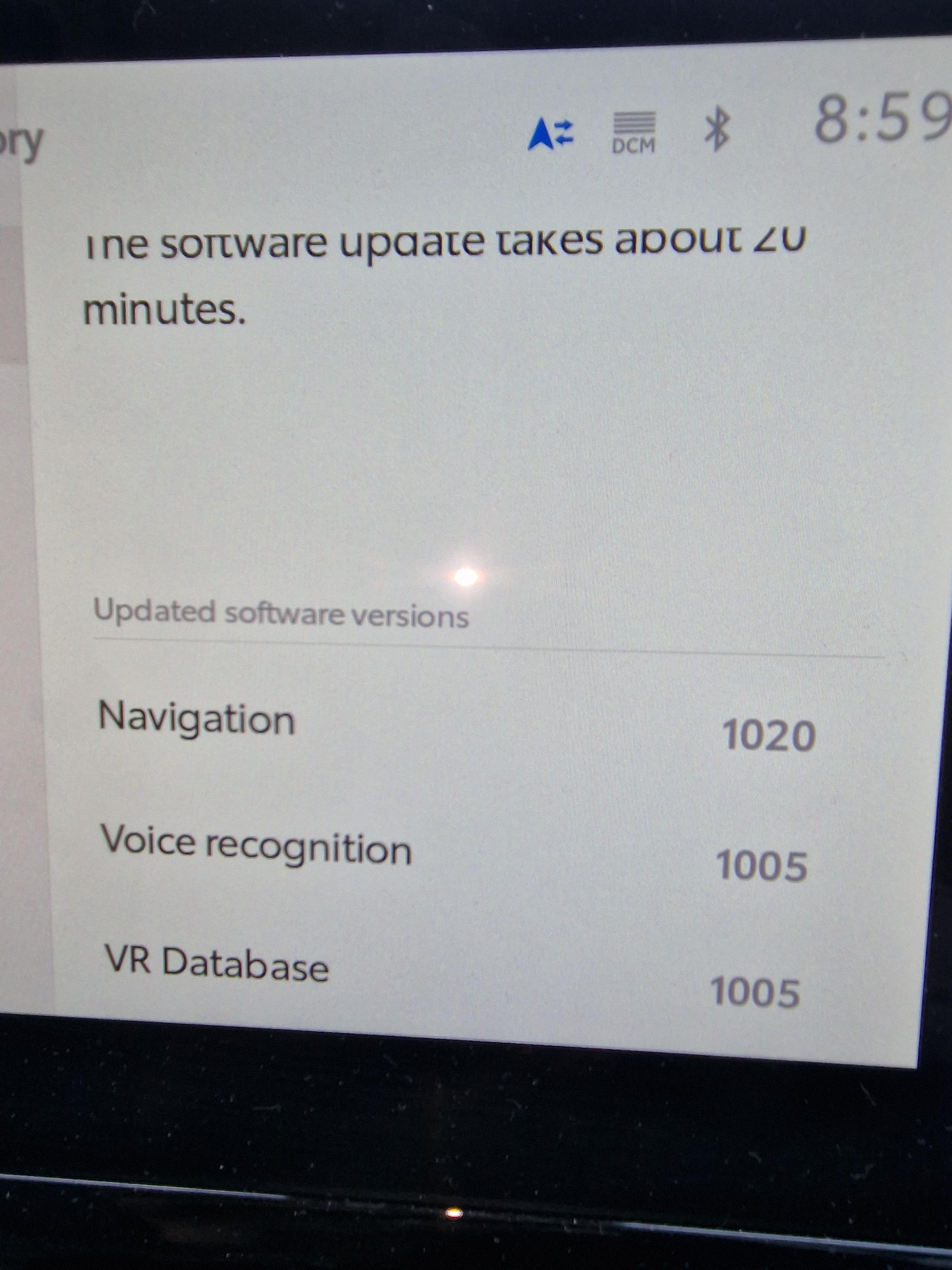

For anyone fed up with the Error 110 message when trying to update multimedia software, HAVE FAITH!
I parked up for a dental appointment this morning and noticed there was a strong DCM signal showing. I tried the Software Update for the umpteenth time and lo and behold it downloaded! I had to switch the car off for my appointment but the updates installed as I drove home. HU SW is now 1020 from 1002 and VD SW and VE SW are both 1005 from 1001.

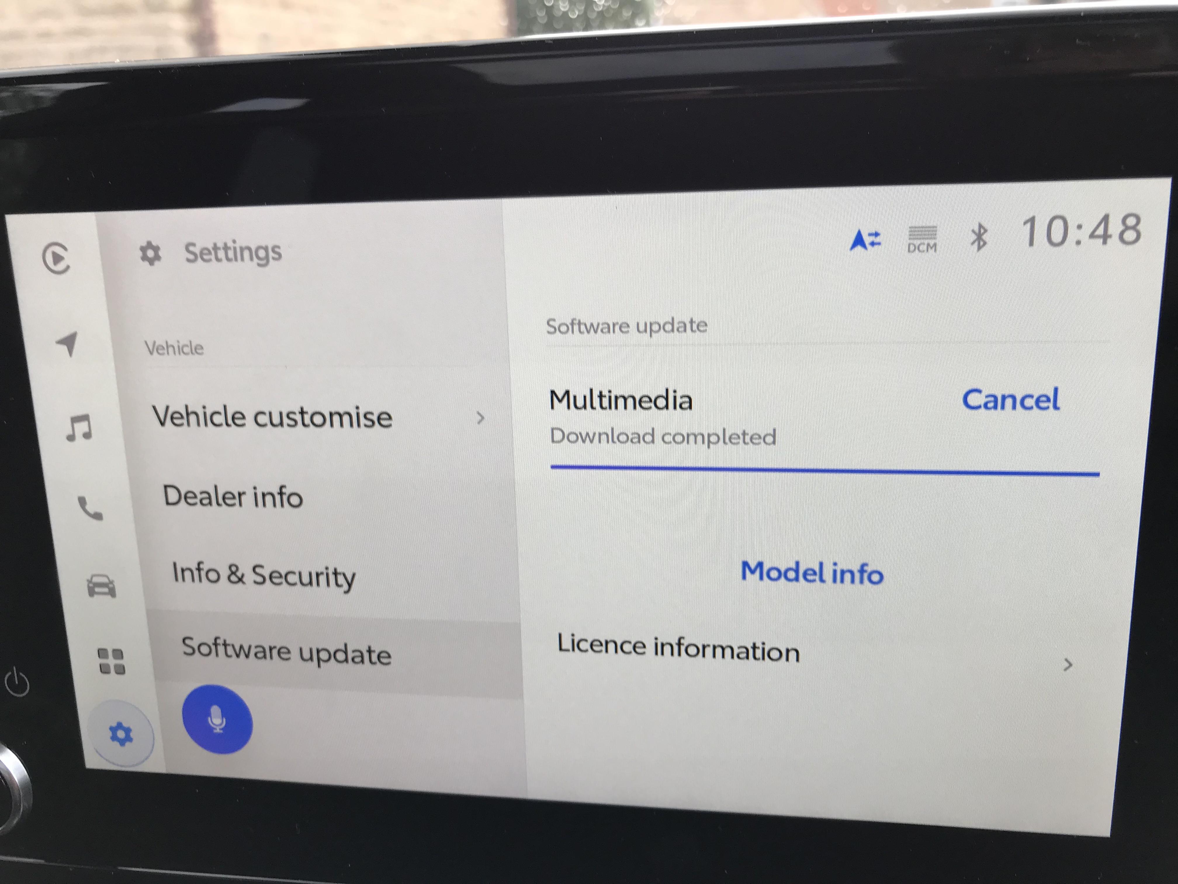

Confirmed, it finally worked, yeey...got one small and fast update on the Multimedia, then one bigger and slower for Navigation and Voice recognition. Interestingly, after the updates got the Profile not loading message again and trips/location are still hit and miss, so no progress there....but that's another topic.

confirm succesfully updated to version 1021 (not 1020) C-HR 2022 doing nothing different from previous updates that didn't work
Hi all
I have been reading the posts and decided to give the update another try seeing as thou it has been working for everyone else and I can confirm mine has been updated also.
Cancelled my service appointment.

yesterday evening just for info I went in the updates section to look for the exact version installed and it found another update, very big one, about "navigation and speech recognization"
this one took over 15min to install but it seems that all went ok

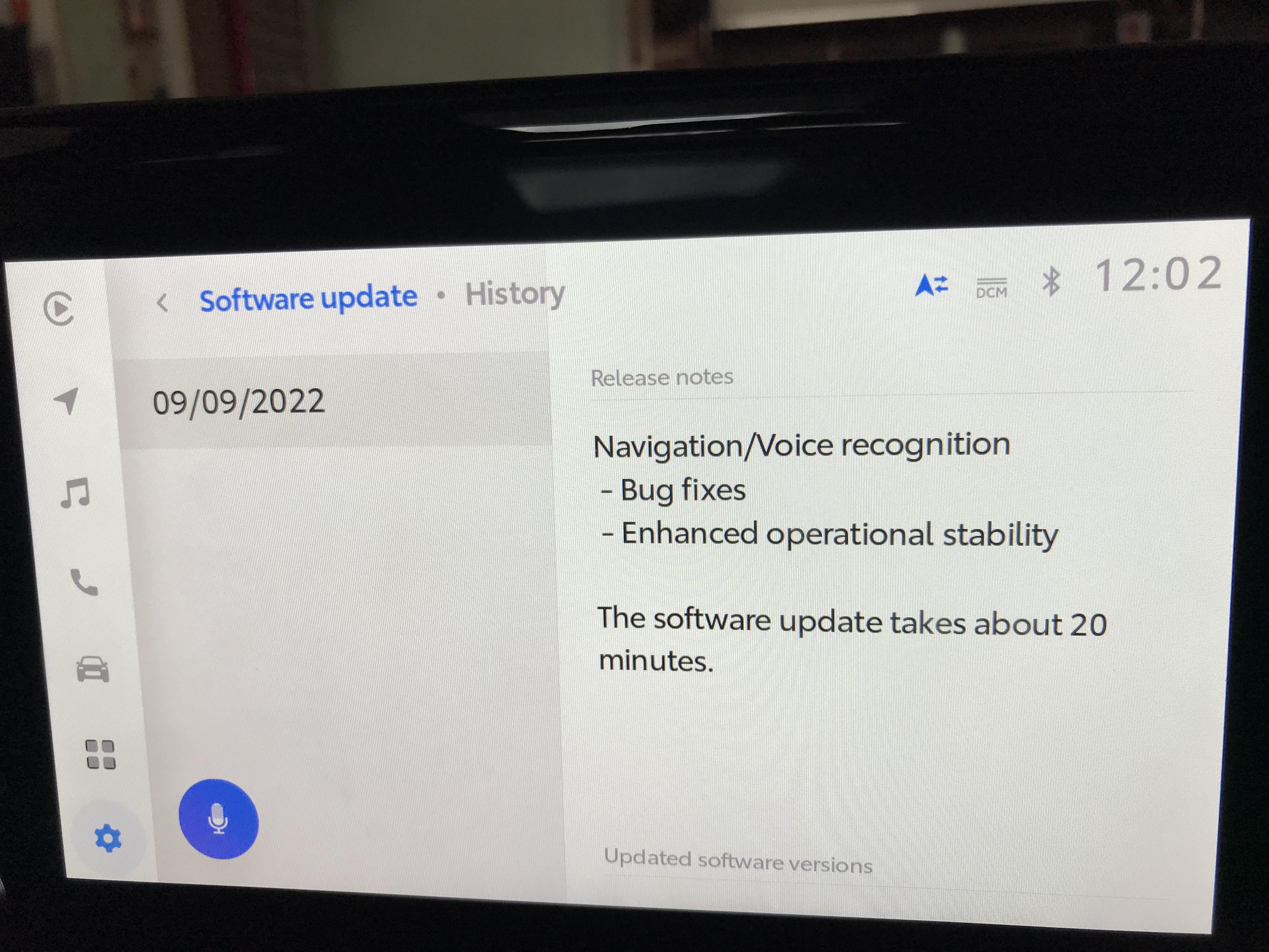

This was the update that took place for me
