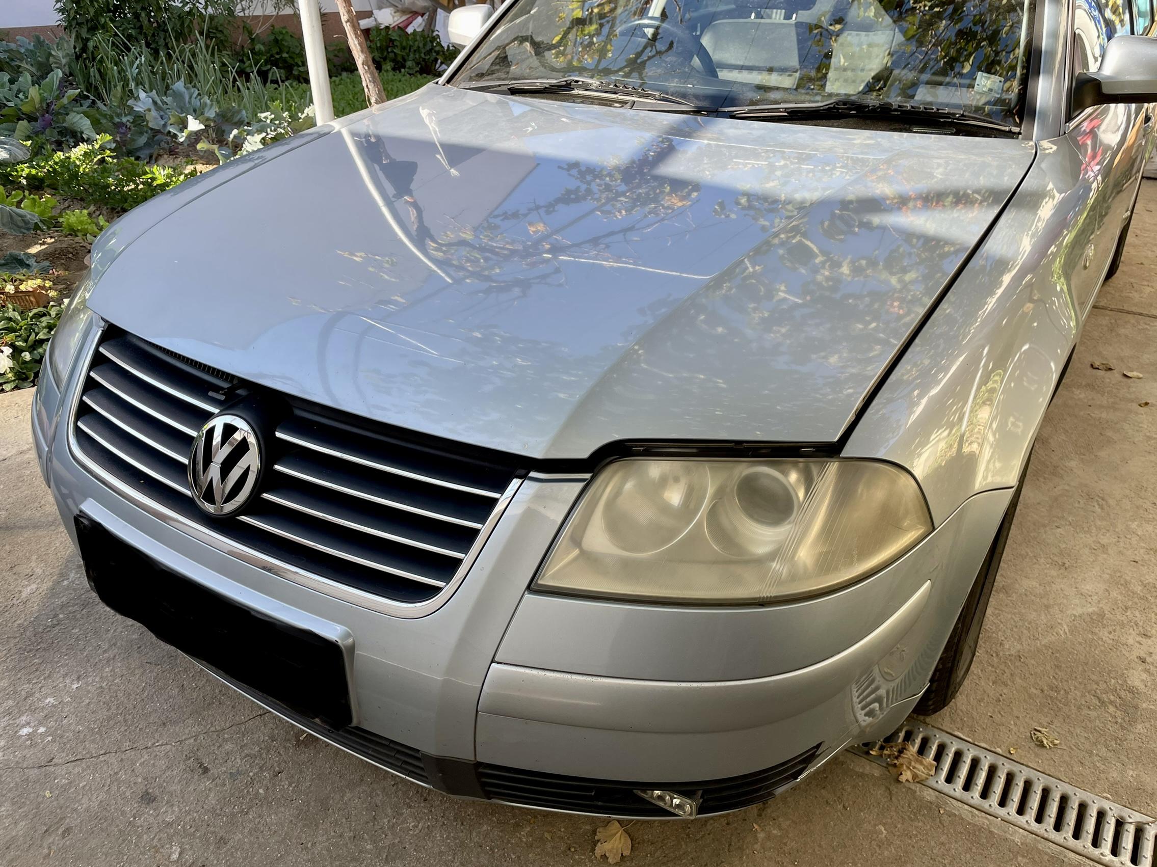

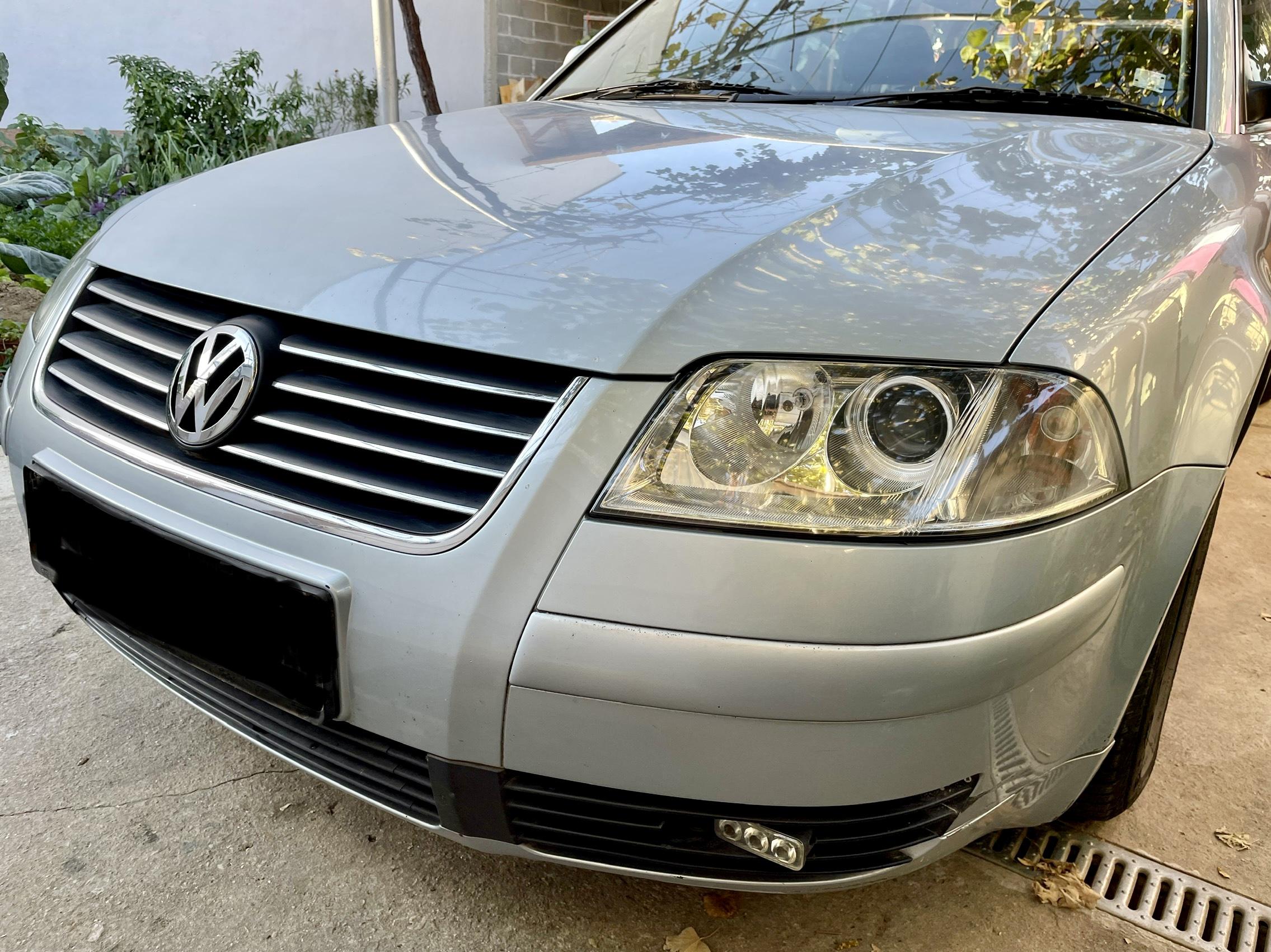

I have done my dad’s car light last week with great success. I used this kit and a Battery drill, done sanding by hand and polish with the drill. He applied clear coat for sealing the surface and this is not as great but he said he is very happy. https://www.ebay.co.uk/itm/154685507419?mkcid=16&mkevt=1&mkrid=711-127632-2357-0&ssspo=HUYzmiYbTea&sssrc=2349624&ssuid=p34UK1z2T4m&var=&widget_ver=artemis&media=COPY
Work done by the instructions. Here some photos.

On 11/1/2022 at 1:12 PM, TonyHSD said:
I have done my dad’s car light last week with great success. I used this kit and a battery drill, done sanding by hand and polish with the drill. He applied clear coat for sealing the surface and this is not as great but he said he is very happy. https://www.ebay.co.uk/itm/154685507419?mkcid=16&mkevt=1&mkrid=711-127632-2357-0&ssspo=HUYzmiYbTea&sssrc=2349624&ssuid=p34UK1z2T4m&var=&widget_ver=artemis&media=COPY
Wow the eBay instructions are mind bending lol
  • Haha 2
13 hours ago, Burton said:
Wow the ebay instructions are mind bending lol
But in reality it’s easy. All you need is patience 👌

I had done dad’s car three times now and the last one that I shared pictures was the best. The trick is to use wet sandpaper 800 for longer time and make the entire surface mat white to the point that if it’s your first time you can loose hope for success, than work with wet sandpaper 1000 and 1500 until the surface becomes brighter white and smooth. Then the machine polish will make them crystal clear again. , work up and down then left to right and repeat, make sure the lenses never gets too hot. I did really enjoyed working on, took me two hours but the results were excellent.
Thank you
