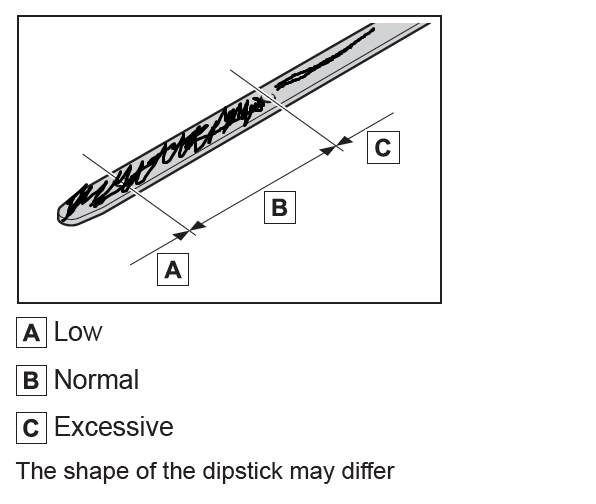

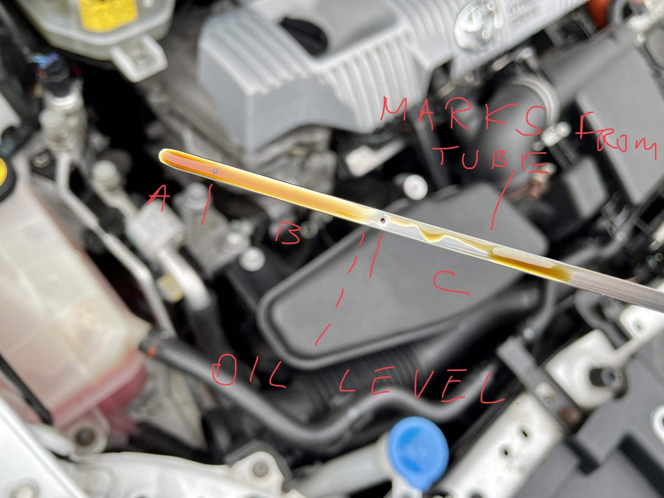

I have had my Hybrid for a year now and my dealer changed the oil as part of the yearly maintenance. Today I checked the engine oil level and noticed it was pretty much filled till C(drawn on picture). However I also noticed oil streaks above that. Is that a problem, given that a warning is written?
I have drawn with black how I see the oil.
I performed the check according to the protocol.

Up to the top mark is fine. The streaks are most likely just from oil drops up the sides of the dipstick tube.
it's normal
If you have difficulty reading the oil level on the dipstick, you can park the car on level ground for overnight and check oil next morning before starting the engine. Open bonnet and take the dipstick out read first and then wipe clean to prevent any residual marks left from the tube. Read again after you clean. If you want to compare with warm engine oil level start the engine, let it running for 15 min then check oil again. Here is an example how to read oil level correctly like in the book. 👍

Your oil streeks I wood ignore if just on one side of dip stick take your reading from opposite side.
That’s a good tip 👍
So I checked the oil at a cold engine and it is pretty much to C. On the other side its over. Given that old expands and this reference picture, I will probably just drive it to the car service for them to verify.
When I checked the oil with a warm engine, I actually cant even tell where the streaks start, because the oil is so clear. But I would say looks more like overfilled than underfilled.

Oil level checks together with coolant levels are actually the most important checks under bonnet. Should be done once a months or even more often if you drive the car more. I do once a week including washer top up and tyre pressure checks. Oil shows other information too as how the engine is running and healthy it is., so good to know. Hot or cold engine oil level difference is within 5mm which is not a big deal if level is in either side of the B mark, although within B mark is preferable. I have seen cars well overfilled or well below and still drives. Well below is actually worse in engines, well above is worse in transmissions.

A tip I read on another forum: You can do the regular process to check the engine's oil level, but if it's a little bit difficult to read it, fold a tissue or napkin over the dip-stick, open it carefully without moving nor tissue or dip-stick and that way you would immediately see the correct level...
The first time I checked the oil level, I needed three attempts and use light reflection to try to infer where it was. I found out that the level is 3/4mm above the MAX mark, did a little research and decided that the level should be corrected on the next oil change. Apparently they all come overfilled from the factory, and if it's not above a centimeter, it doesn't cause splashing bubbles nor augment the piston pressure or valves.
Supposedly you need to fill the engine with 4 liters, start the engine and let it warm up, shut it down and let the oil cool/drop for 5 minutes, and then add little by little the remaining 300ml until you reach the b mark on the dip-stick.
