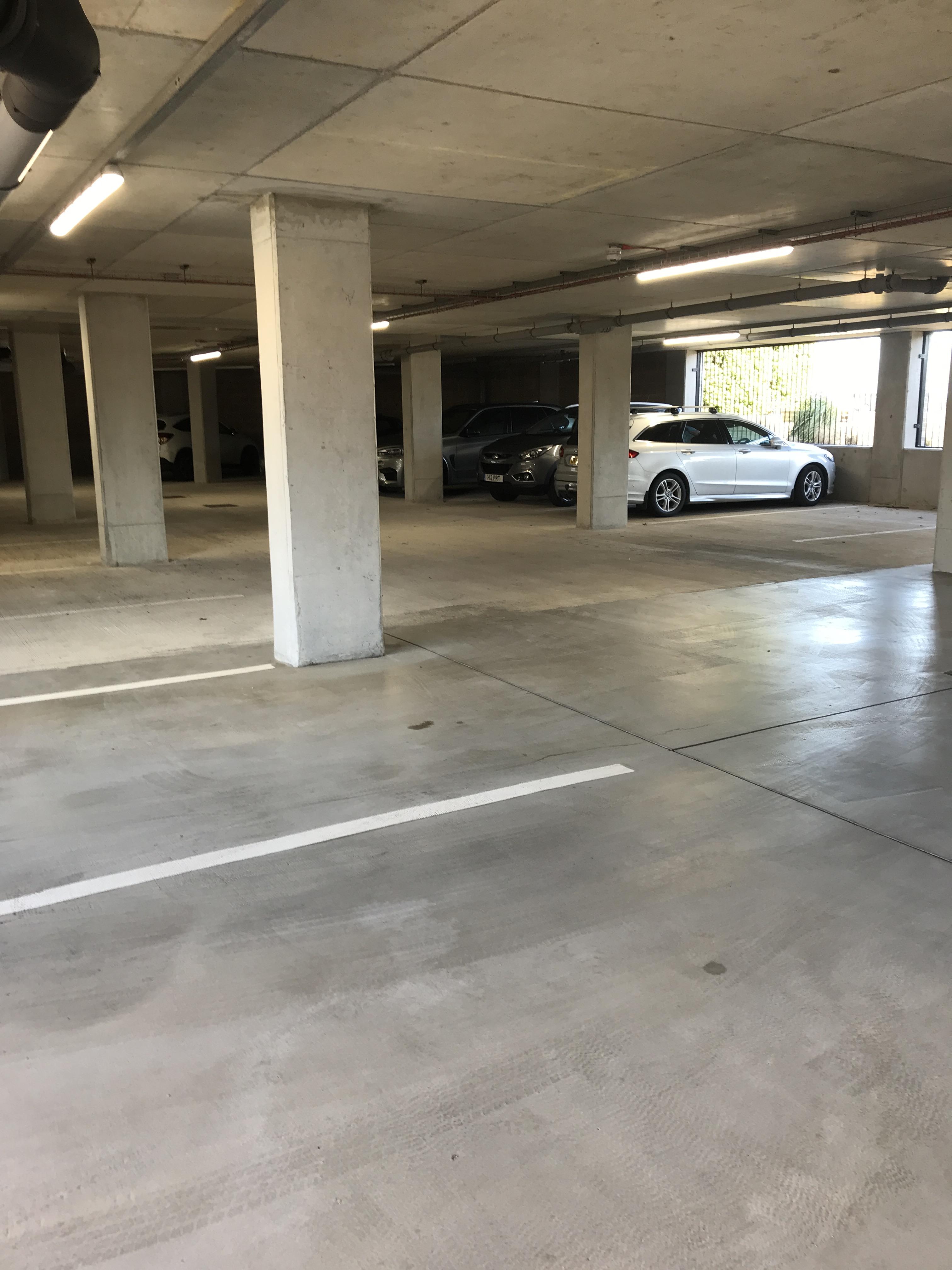

Hi all.....or in my case utilise the outlet to power a static exercise bike stored behind the car, rather than permanently on view in the apartment. There are a total lack of 240v sockets at car park level. Big plus for the RAV auxiliary supply point.
Barry Wright, Lancashire.
