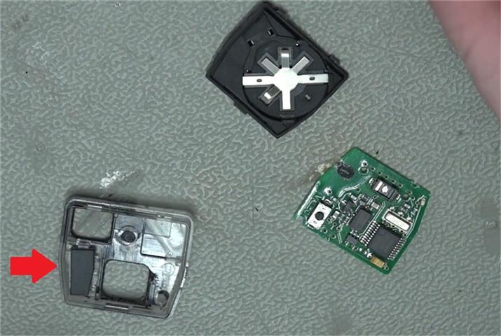

they stopped using the master/slave system back in 2008/09 iirc
I will break down how the key works - the buttons what are powered by a Battery only do the door locking what is user programmable, and inside the key you have a passive chip for the immobilizer
The way the chip works is when you put the key in the ignition and turn it, then coil sends a signal that excites the passive chip, it sends its signal back what is verified by the Immobilizer ecu allowing the car to start (i won't go into further technical detail)

Ah. There is a separate insert inside the fob. Otherwise it is a plain fob key case with no 'external' chip. This insert is the original that came with the key. The only thing that has been changed is the Battery inside. This is accessible from the underside of the insert. I shall look to PM you

Sorry, i was thinking of the later type fobs
2 button fob - chip arrowed (note there are 2 other types, some 3 button fobs have a screw down Battery cover)
