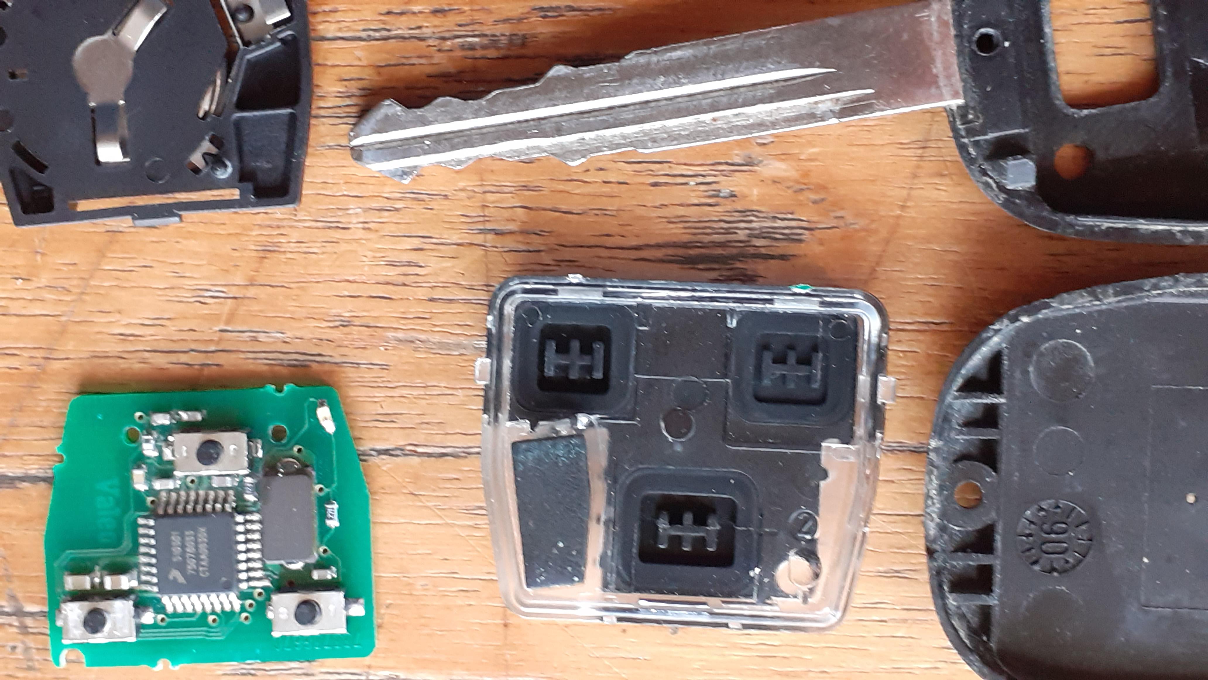

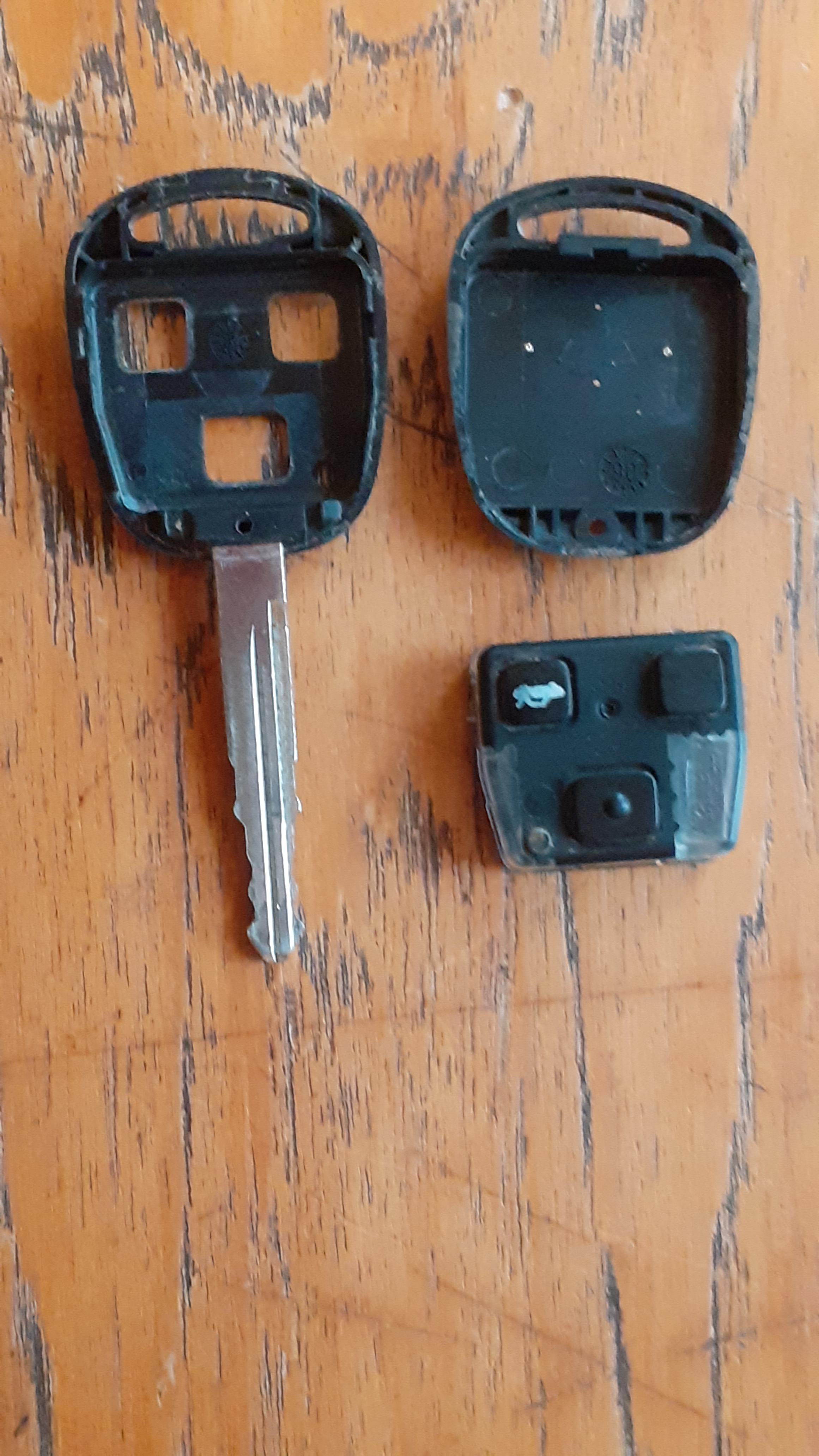

OK, got it. I prized open the button case and presto, the tiny chip is located in place.
hold that chip near the ignition and turn the key and see if it starts
Um. Sorry. I don't understand. The chip is inside the key you want me to put into the ignition, so you want me to take the chip out first?
The immobilizer ring is around the barrel, hold the chip/buttons as close to it as possible, then turn the key and see if it starts
the chip maybe weak, the closer you can get it the better chance it may read it
Taking the chip / button insert out of the fob key case, holding it up to the barrel whilst trying the key in the ignition did not start the engine. I also tried using the grey key against the barrel which allegedly has a chip embedded. It did not help. The grey key DOES start the engine, of course.
Ok that chip may have failed, get a replacement chip, ideally you need to find out if the chip can be read
If you dont mind the trip i will be happy to give the programming a go/see what i can do
I can buy a chip from the info on the web. Then, what do I do to find out what you need to know?
