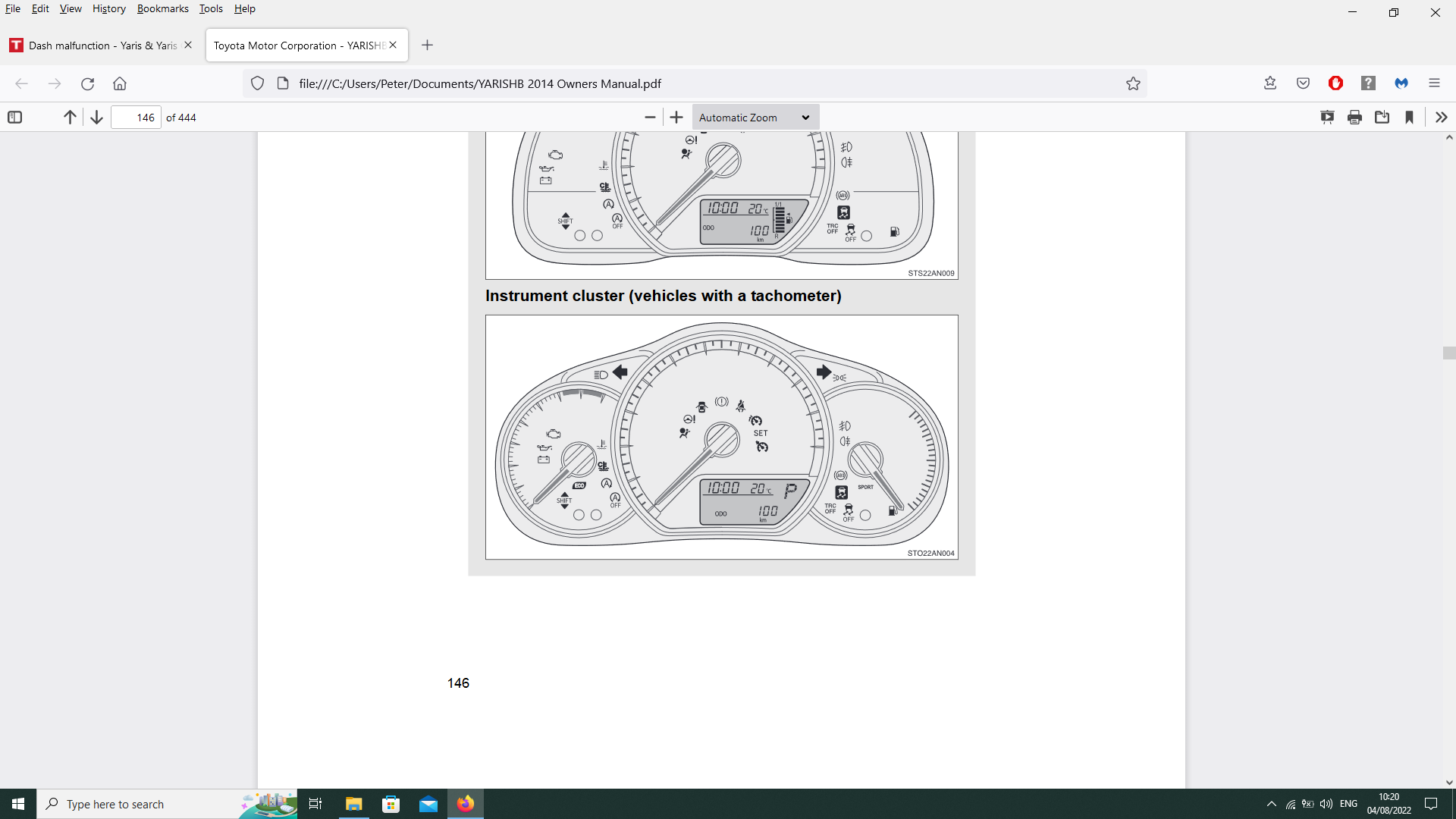

Are you absolutely sure there should be a "lights on" warning? My car doesn't have one. To be honest I haven't even checked the display to try and see if there is provision for it.
Non shown in the handbook, only rear and front "fog" lights.

I assume they mean the side-lights indicator, which in your diagram is next to the right signal light.

I assume they mean the side-lights indicator, which in your diagram is next to the right signal light. It doesn't appear on this diagram though. I wonder whether it was introduced in later models?
Right, that's the indicator I was expecting to see.
There are 2 dashes for a lot of Toyotas - One is usually only on the poverty-spec trim and usually misses off things like rev counter, temps, random lights etc., and the other is the full dash that most of the other trims would have.
If yours is the Icon (I think that's the lowest spec, but ever since they changed from the much more straightforward T2 T3 T4 naming convention I'm never sure!) it might actually be missing that light deliberately, as well as the rev counter etc.

It's the 2012 Yaris Spirit, which I think is a higher trim model. It's got the rev counter, but the diagram I linked shows that even the rev counter equipped dash doesn't have it. It's just very odd to me that there are lights for every other function but not for the lights.
Huh, maybe it doesn't then?? Would be the only high-spec Yaris dash I've seen without one tho'!

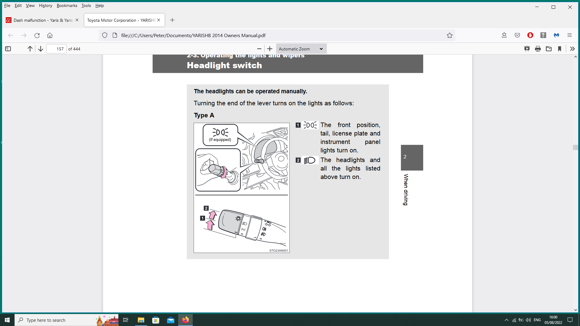

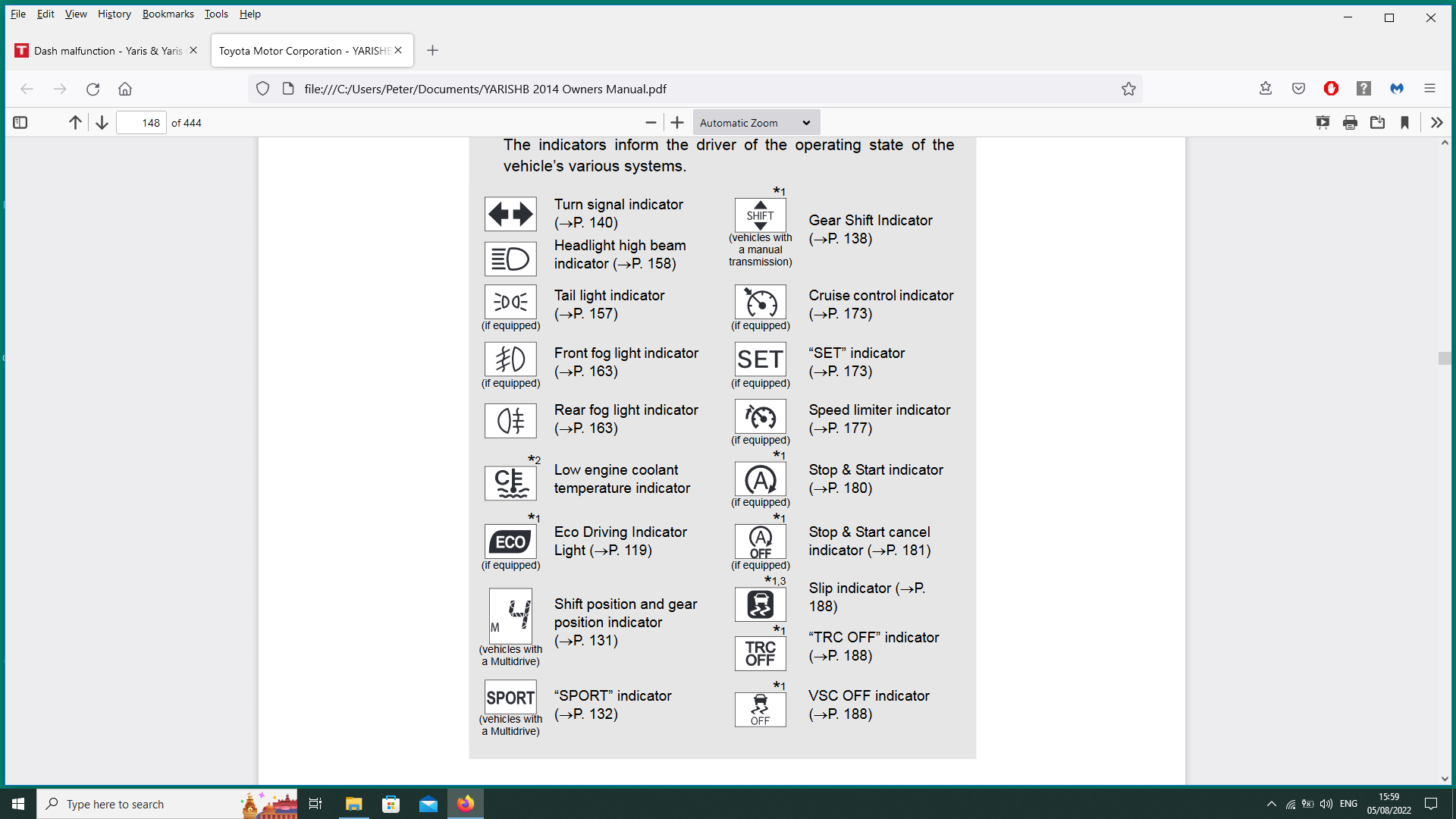

I pulled the owner's manual, and it shows a control light next to the right indicator but the description is "tail light (if equipped)". The icon looks like the one I'd associate with headlights. I'm baffled.

The presence of the headlight warning indicator depends on the type of dash Toyota fit for example:
On cars where the dash auto illuminates on start up to allow it to be clearly seen will have a light on indicator, whereas
On cars where the dash is easily legible and it only illuminates when the headlihts are on there will be no light on indicator
Oops, didn't spot that!:ph34r: That definitely doesn't illuminate on mine, when the lights are on. "If equipped", as Artur has pointd out.
