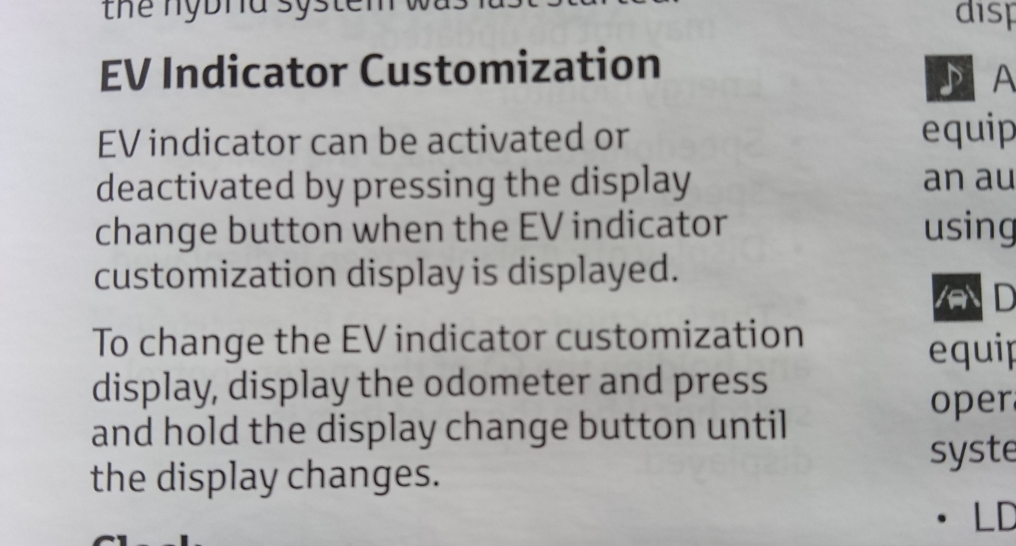

My 2018 definitely has a menu option to disable the EV indicator above the Ready light. I remember contemplating it when I got the car and deciding to leave it enabled but I don't recall where it was set.
Have to RTM.
The handbook instructions are for those with the monochrome display (pre 2017 and post 2017 Active spec). The display change button is below the fuel guage. For those with the post 2017 colour display, the option is in the settings menu (accessed via steering wheel buttons).
