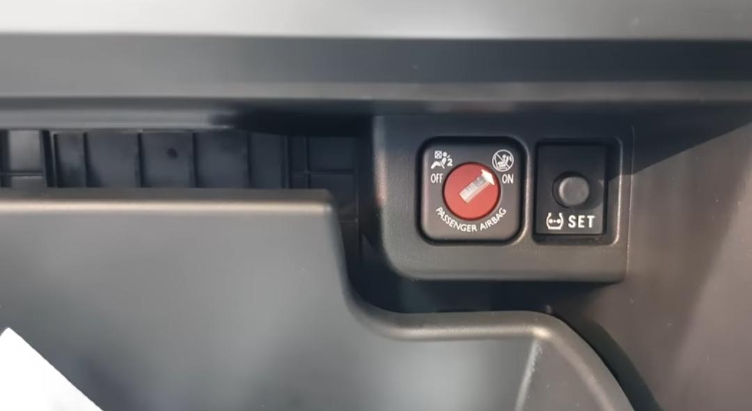

Now the TPMS light is on, I don't know how to reset it, only done that on my old CRV.

In glovebox, press down for a few seconds, had to look it up as had a couple Aygo's in the past and you had me wondering as well 🤔
Thank you Eddie G from myself and new Aygo owner.
Done this just now and worked a treat, so simple once you know, I was imagining all sorts of complicated procedure.
