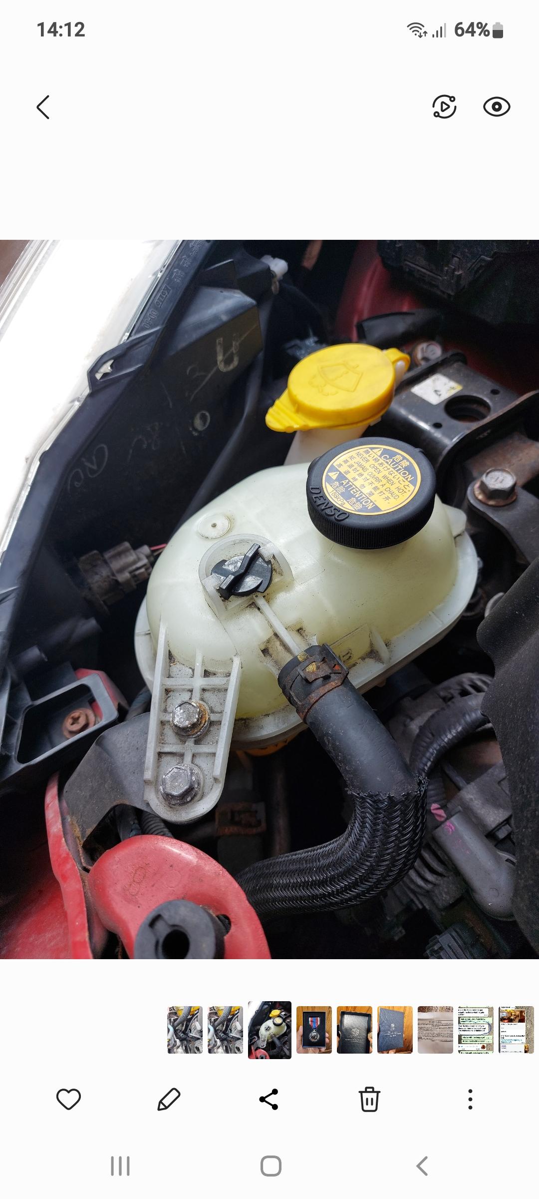

The problem is it was running for over an hour (heater on full) but the fan didn't come on or the thermostat open. I had to rev the engine to 2k for the fan to come on...... but the coolant seems to be just sitting in the expansion tank and not flowing to the radiator when the thermostat opened.  While I was waiting and doing a lot of swearing and wishing I had not started this whole thing I noticed a sticker on the bonnet that says "when adding coolant open 2 air bleed valves then close valves and start the engine". I have looked on google and can't find anything about this. There is a black round plastic screw on the expansion tank and a rubber bung next to the cap....car not overheating but I don't have a temp guage only a light that come on blue for cold and red for hot!!!!

thanks for the replies...so If I start over by draining the coolant again through the tap at the bottom of the radiator. Then open the valve on the expansion tank next to the cap, open valve b and attach tube then add coolant to expansion tank close both valves remove tube and start the engine. No need to burp air as with older cars??

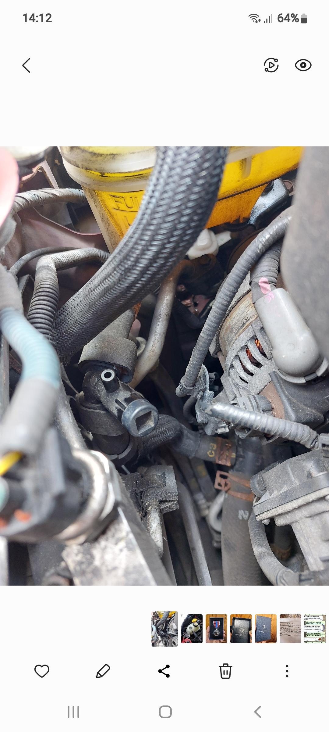

I have just been back to the car....there is no tube to attach to bleed valve "b" and the bleed valve b cannot be unscrewed its fixed in place please see pictures
You supply the tube it's a 1/4 turn tap iirc it should turn with a square ratchet head
oh.....so I need to find a tube that fits into valve b 🥺
