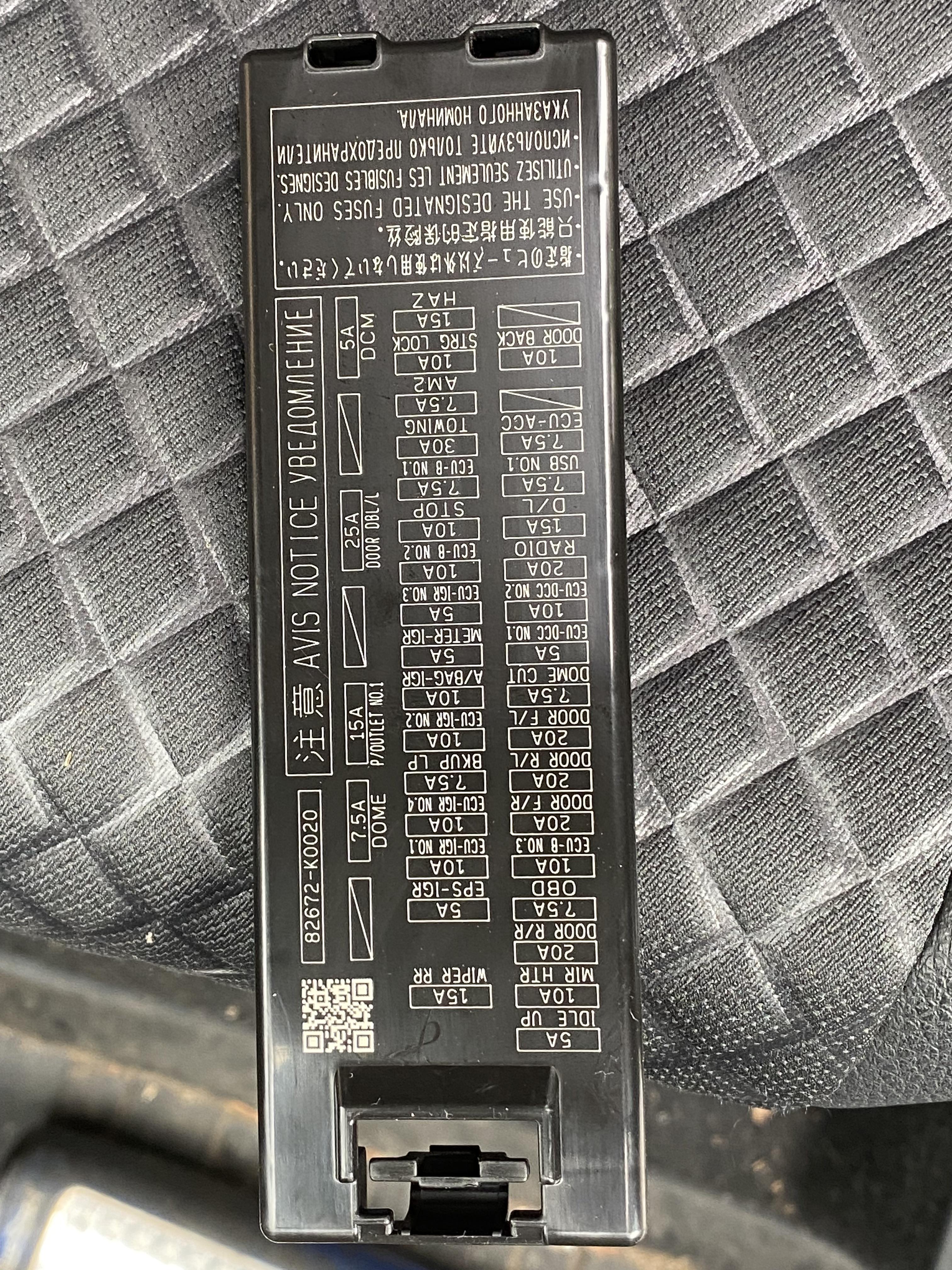

Check fuses look under aircon unit under footwell after removing plastic cover remove fusebox cover.
Check door fuses. Marked up as 10 amp door rear .
These are mini micro blade fuses.
