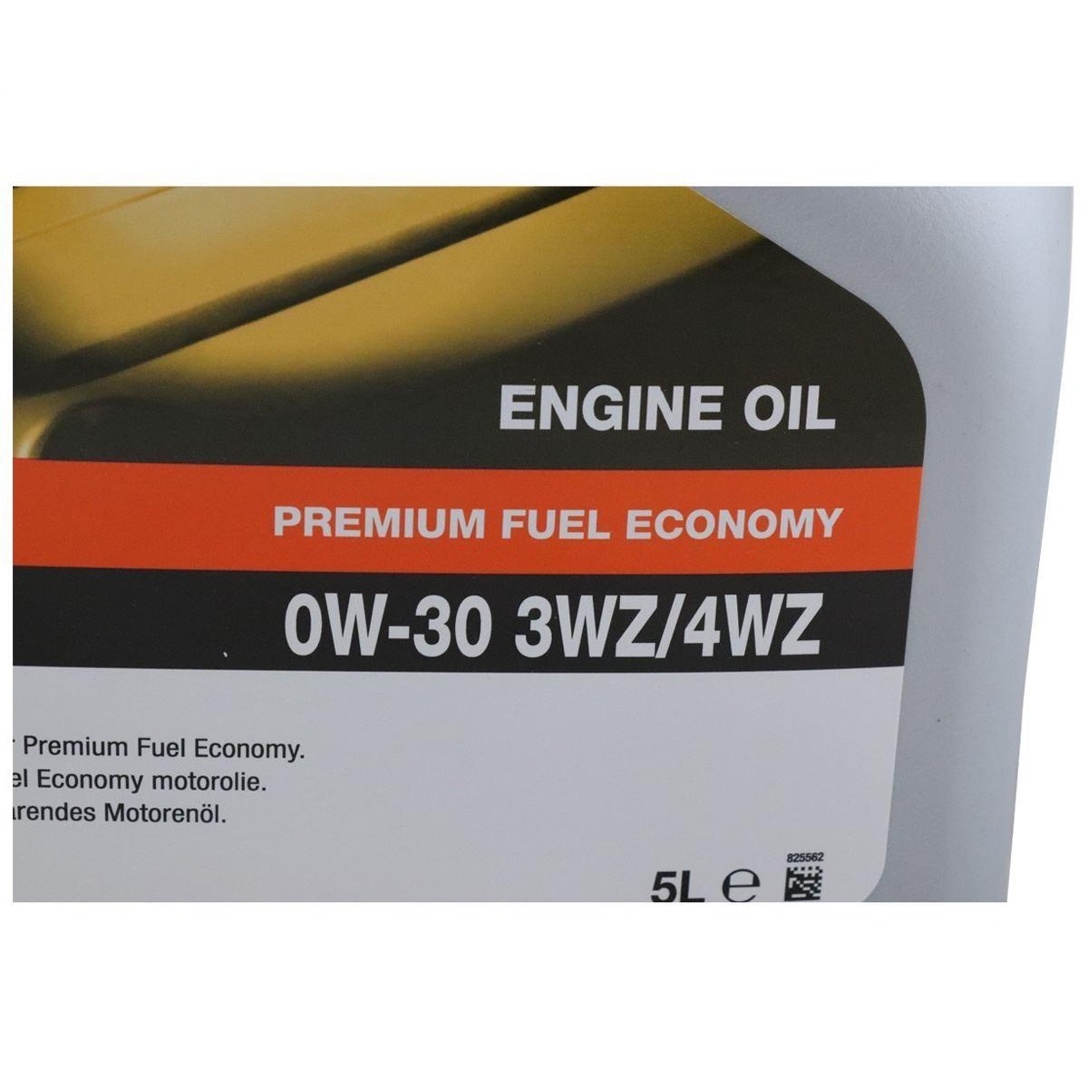

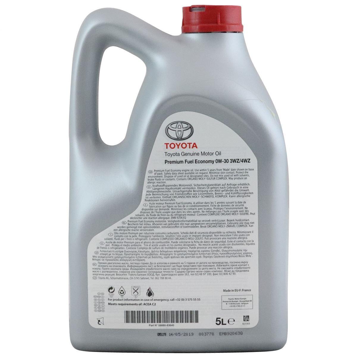

The specified oil for my 2018 Auris is (unsurprisingly) 0W20.  I looked at the Toyota eBay store but could not find 0W20 in 5 litre containers.  ebay.co.uk/toyotaofficialstore  I asked why I couldn't find it and was told "...the 0W-20 AFE oil and can only be provided in the 1L category."  But, 0w30 oil is available from Toyota in a 5 litre size.  I wondered if it would be a good substitute for 0W20 as it has a greater specification?

0W 20 is in short supply, the 0W 30 listed is not a suitable replacement, that particular oil is for new grade Proace
It doesn’t have greater specs , higher hot end numbers doesn’t mean always better protection because the different engines works differently and require an engine oil that is designed to work ( flow and create oil pressure plus lubricate and dissipate heat) in certain ways. Any other oils out of the exact specs will be not as protective as the original one. First and most important when choosing an oil is to match the manufacturer recommended specs and then choose the brand you like or whatever is available, quantity packages not important. Second important thing is to buy original stuff only, Toyota parts including fluids are faked a lot, extra care here needed and buy only from well known vendors. Are you going to change the oil yourself, how I do at my driveway? If not then just ask the garage ( dealer) to use the preferred oil and let them take care off. Common mistake is to ask for service or repair a mechanic or garage and provide parts by yourself, doing so invalidates any potential warranty or work after that if something goes wrong.

I didn't mean to suggest 0w30 was a better oil than 0w20 just that - maybe - it was like 0w20 but with higher hot temperature spec.  So, would it not perform the same was as 0w20 and have 'something in reserve'? Not suggesting I'd want to use it, but I always thought that 10w50 would do the job of 15w40 (where it was specified), but would have 'something in reserve'.  Or, have I misunderstood the ratings system?
It just means at higher temps, the 0w30 will be thicker than the 0w20, so less good for economy and won't flow as well.
Sometimes thicker oil is better, but with the tight tolerances of modern Toyota engines, too thick an oil may cause problems. Current Toyota engines are designed for thin oils so ideally that's what should be used.
You could probably get away with it in a pinch, since 5w30 is the official 'backup' oil where 0w20 isn't available, but I wouldn't want to run on it long term is it will likely increase engine wear, esp, at cold start (Mine one's oil is even more scarce - 0w8!! :eek: )
Just as background, the Toyota Proace is now a badge-engineered Peugeot Expert/Citroen Jumpy van.  For this newcomer, Toyota will have had to stock plenty of Stellantis van parts in Toyota wrapping.  And hence this 'Toyota' oil existing, just for one vehicle in the Toyota range.
