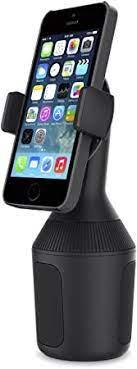

The good news is i have found an ad free music player (video below) that works great and allows me to use the steering wheel controls to move tracks i also bought a cup holder mount similar to this so i don't have trailing wires onto the dash its all working well and i have 125GB of space to play with (not that i will ever fill it)
