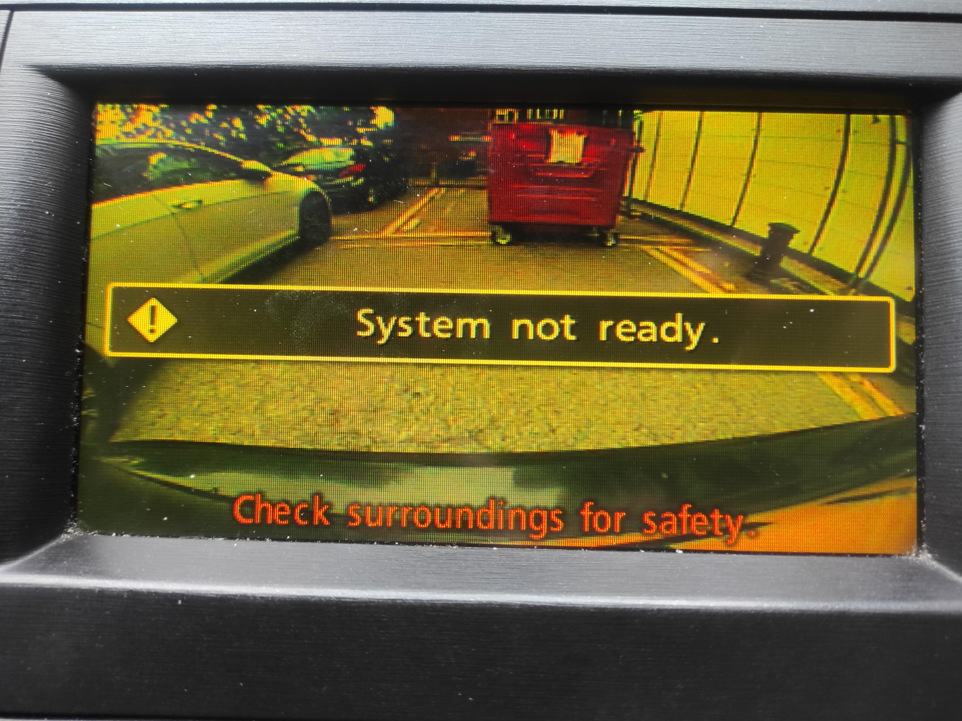

I was messing around with the backup camera lines and now I can't finish setting it up, it gets stuck on this screen.

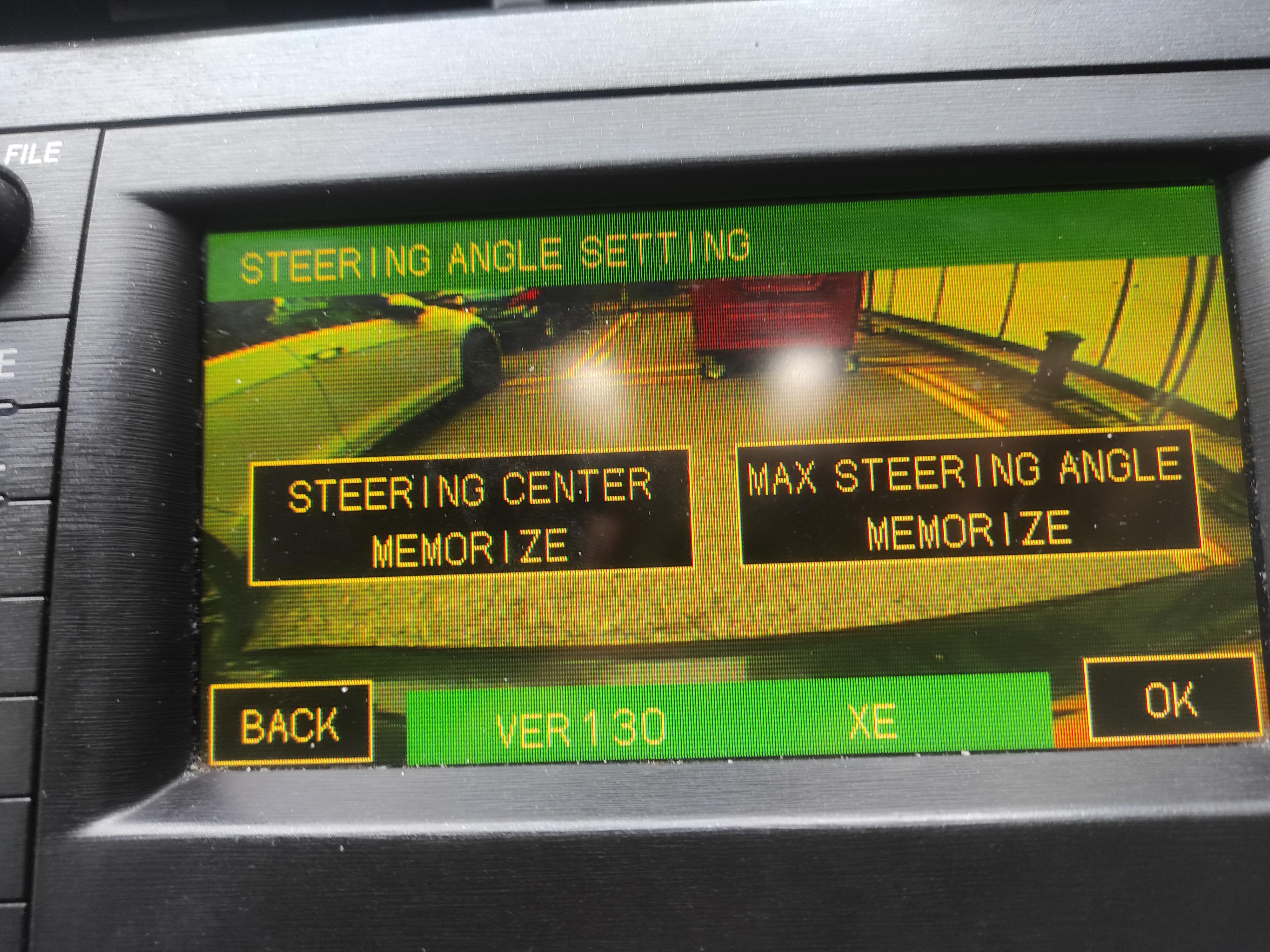

Nothing works on that steering angle settings screen ?
Press and hold center memorize for 5-10 seconds ?
I've just tried it but nothing happens
on that screen turn the wheel full left, full right and back to centre then press ok
