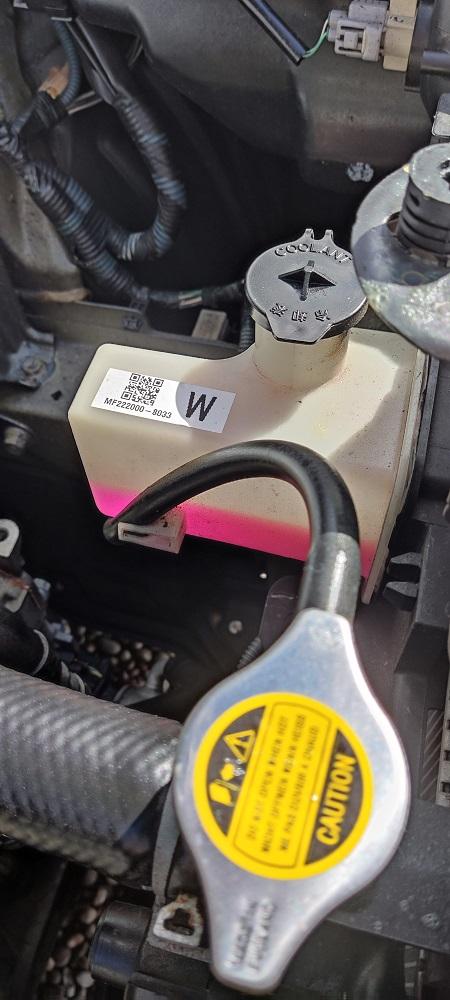

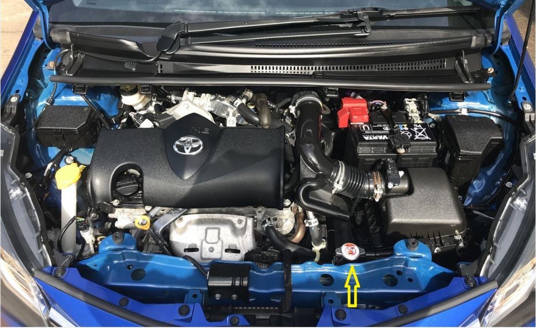

I noticed the other day there is an old school radiator cap (see picture below) in the engine bay next to it is a black filler cap which i assume is the header tank what i found strange is the header tank cap is not threaded it pops off like the screen wash filler cap so how does that work surely there must be pressure in the header tank but it would seem not.

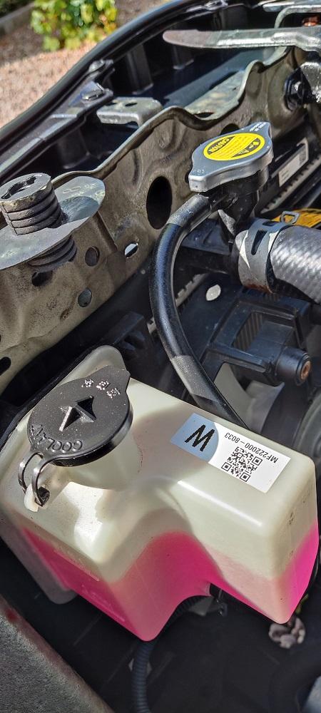

I also fond it near impossible to see the level in the header tank i think there is the work level or something on the side of the tank but its very hard to see, has anyone else found this?
Yes, that would be the header / expansion tank. An expansion tank is just an overflow to take the excess coolant as the engine warms up and the coolant expands. It does not hold any pressure. There will be a high and low mark on the expansion tank. The level should be above low when cold.

Thanks,  that's the problem as looking from above its almost impossible to see where the level is i am wondering how members view it.

In don't know exactly how it is mounted on the Yaris, but generally on Toyota's the tank sits between the radiator and the engine. So, yes it can be a bit of a squeeze to see anything. The tank is often dirty and not clear, making it harder. What I'd normally do is pop the cap off the expansion tank and shine a strong light down the filler neck and rock the car gently. Then it's a little easier to spot the level. On a relatively new car like yours I'd be surprised if the level was anything but normal.

I agree, i will give the torch trick a go and see if it helps.
