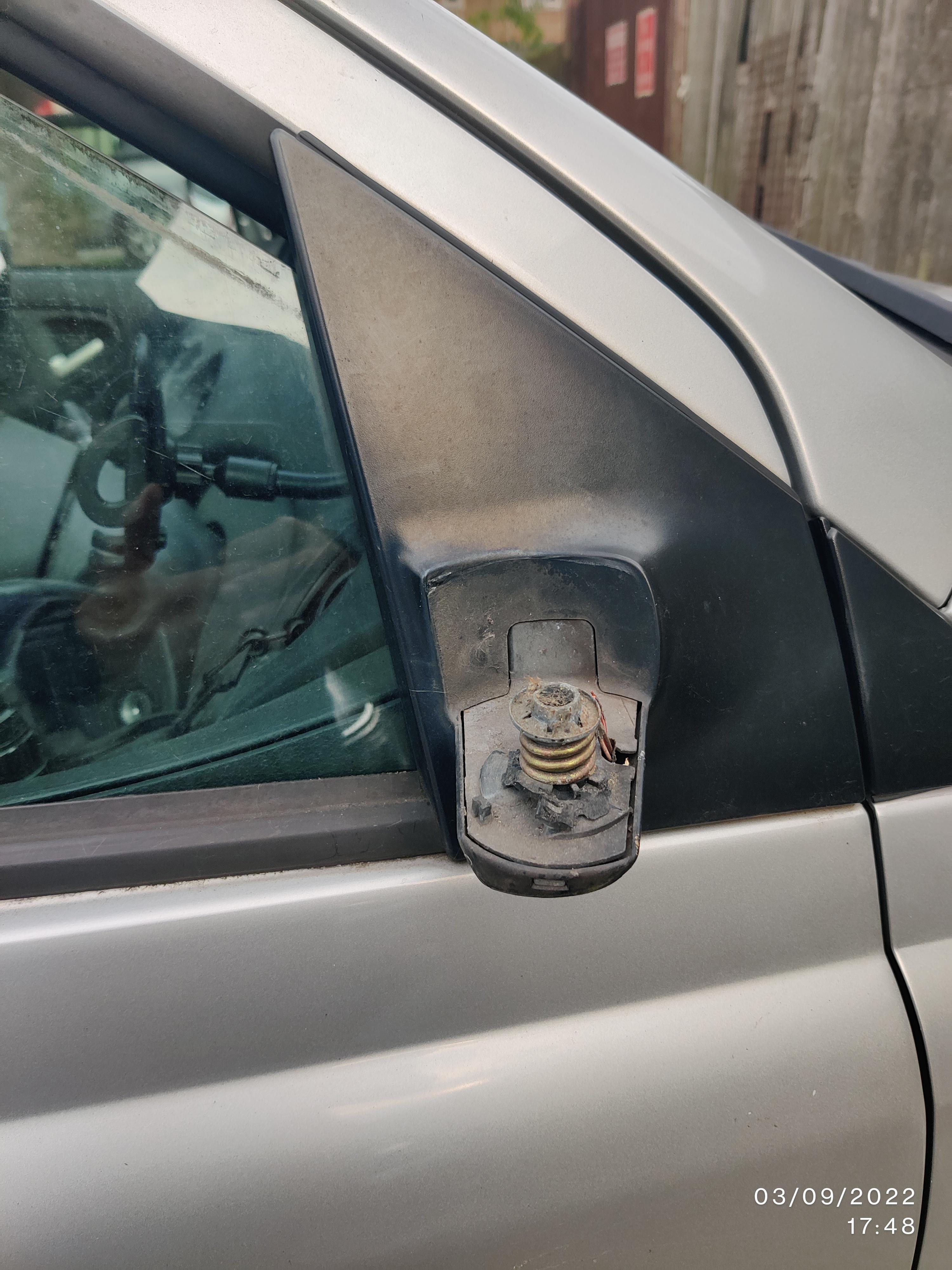

Hi guys I'm here with a new problem. Last night someone decided to break off my driver side wing mirror completely ripped it off the only thing remaining is a few electric wires sticking out. On Monday I will attempt to source one from the scrappy. How difficult will it be for me to replace it myself as I can't afford labour as well as buying it. The car is LR53VJY. thanks so much for reading.

No wha I meant was although the existing one was electric can I fit a manual one in its place are the fittings similar. Maybe the photo can help.
If you get a manual one you may need things like the different inside trim (or cutting a hole in the one you have), and obviously the lever if it's not part of the mirror assembly.
ah if you have electric mirrors you need a electric mirror, yes you can fit a manual mirror as a stop gap
your car is French built so anything late 2002-2005 should fit

Ok thanks again.I guess I'll just get a manual one and drill a hole in the inner trim for the adjuster stork thing. Will be cheaper as I can't afford electric mirror right now. Just needed confirmation of the fittings.
Update I have managed to fit a manual mirror off the same colour found in local scrapyard £35. I am missing the internal trim which can be bought on eBay for the tidy sum of 20 quid but I think I'll just leave it. Managed to break a couple of inner door panel clips while putting panel back on but I think I'll be able to get those quite cheap. At least I'm legal now.
