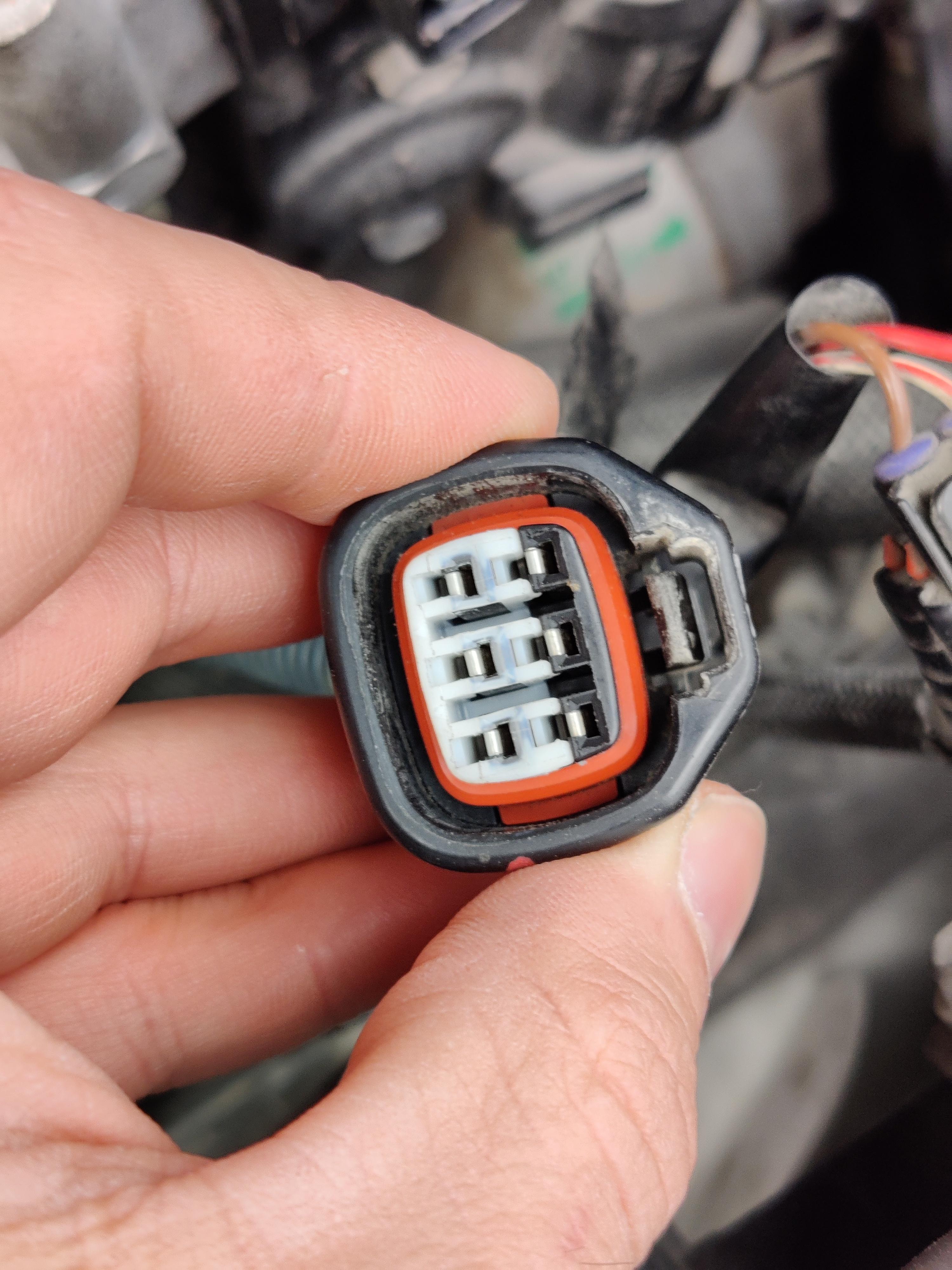

The 6 pin female connector seems to be okay, but could it still be the problem? Anyone had a similar case? Can you find new connectors somewhere? Or do I need to take the valve off once more and check the throttle valve if it has a carbon build. It has also a throttle position sensor on it but don't really think it's the problem.

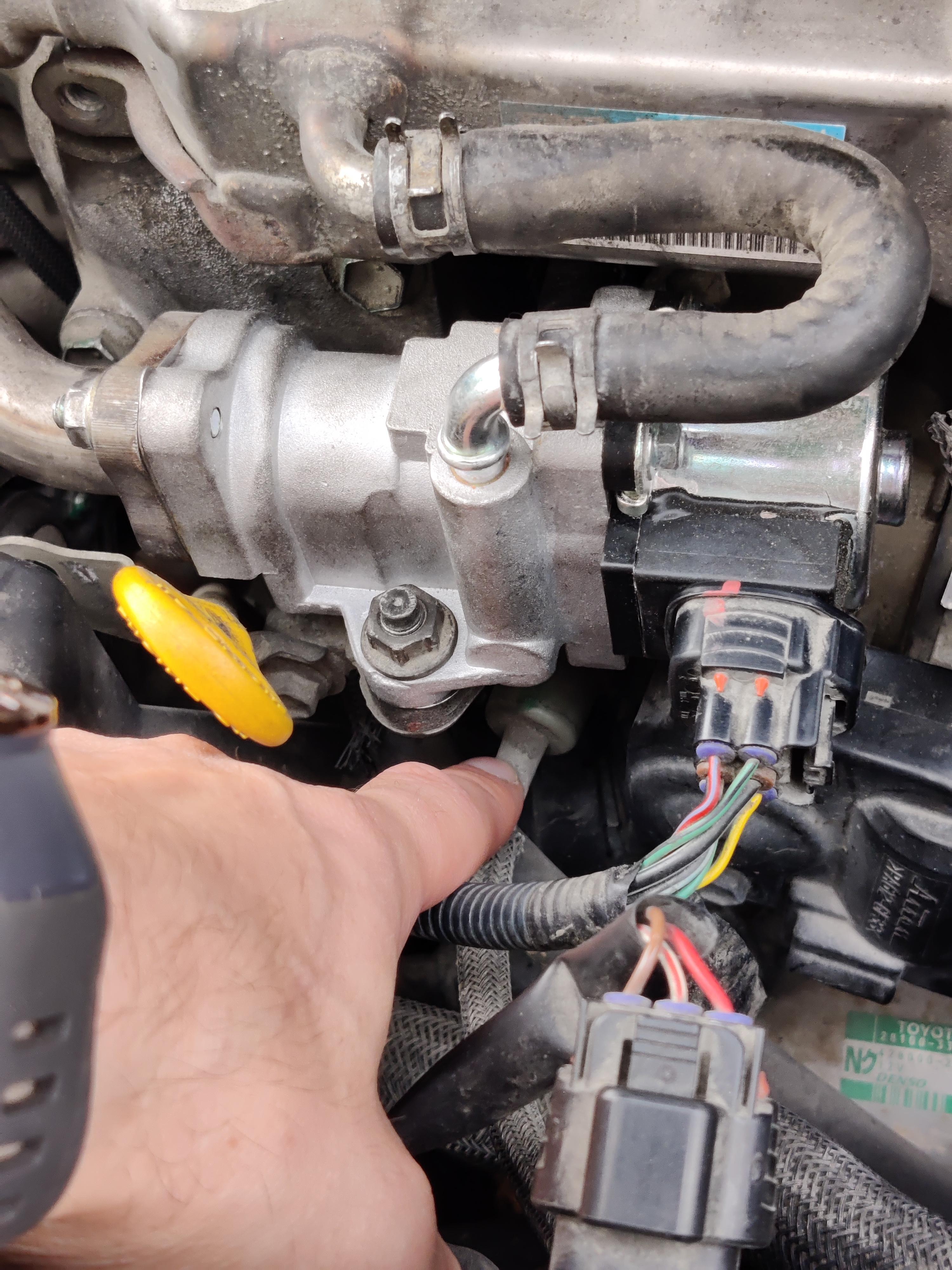

And what is this sensor on the pic under the egr? Boost pressure? Can't seem to find out what it is or a spare part. Also could take it off and clean it if has carbon build up and messes the system..
