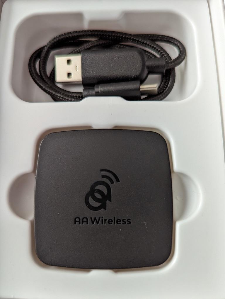

Yes, I aquired a "Carlinkit" I believe others are available.
I'm using an AA Wireless dongle.

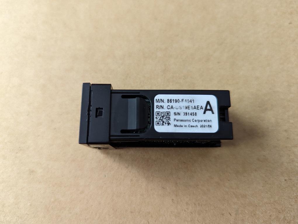

Well today I hardwired in my AA Wireless adaptor so it's hidden from view as I hated having the cable hanging out the port - also means I can use the front cup holder again.
I got hold of another USB port matching the part number already fitted to my vehicle.

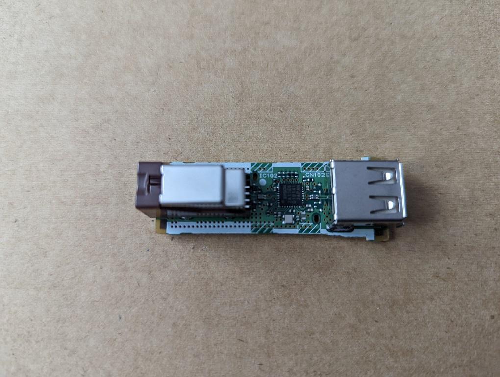

When you dismantle it your left with this.

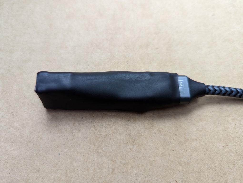

I got a USB extension cable from Amazon plus a couple of layers of heat shrink & then turned it in to this.
You remove the brown connector on the vehicle loom from your original dash USB port then plug it in to the brown socket on the board, I then ran the other end of the USB cable with the female USB port to above the passenger footwell, removed the plastic kick trim below the glove box & carefully plugged it in then hid the AA wireless adaptor before refitting the trim.
Doing this means your original dash USB port is now just a decoration - also it still gives access to the USB port in case of infotainment software updates via a USB memory stick as you can reach up via the access hole in the kick trim & get to the USB cable female port to then plug in.
