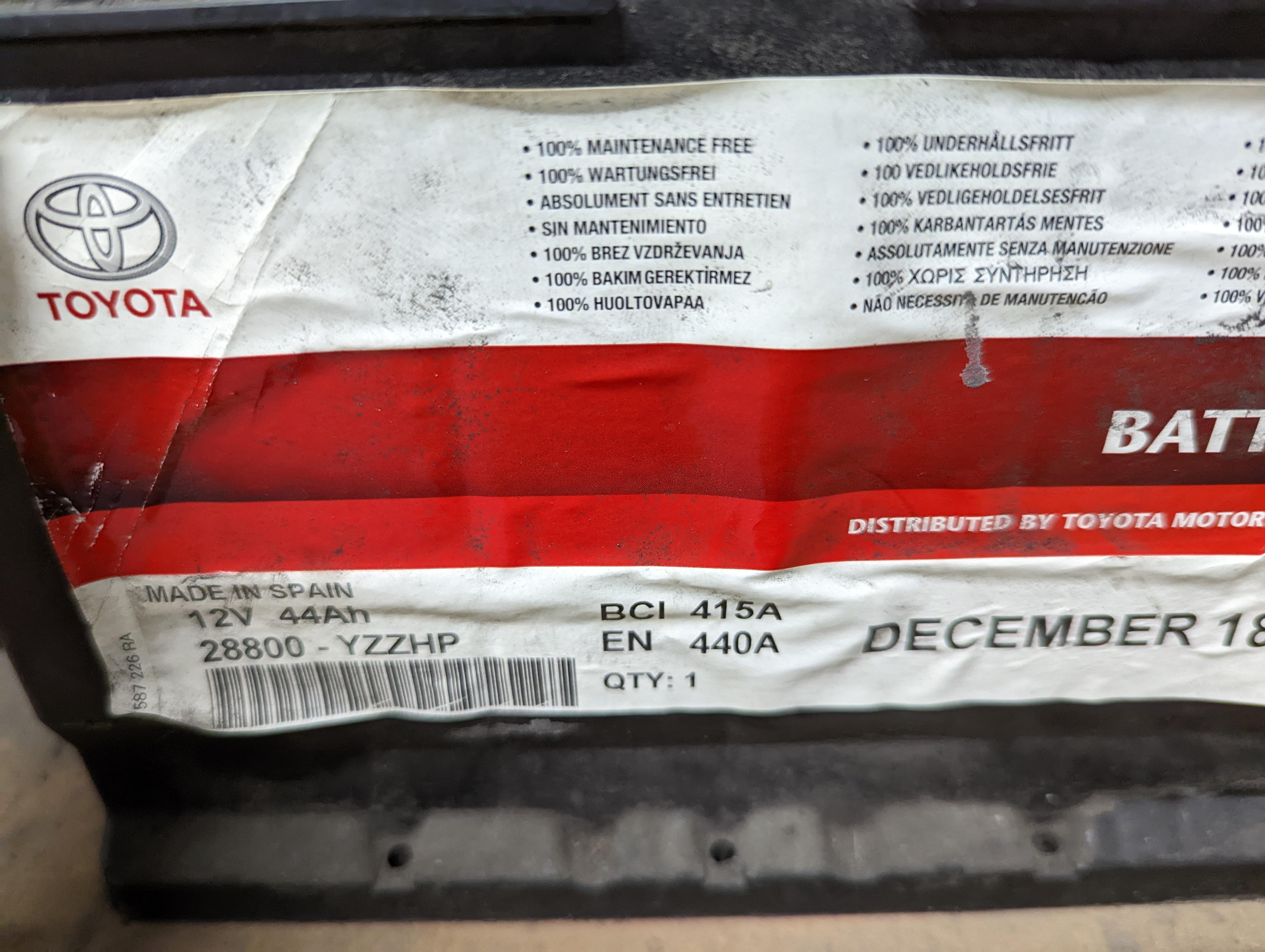

On 9/12/2022 at 8:39 PM, AndrueC said:
Toyota probably don't make the battery 😉
No idea who makes them but FWIW this Toyota branded Battery was manufactured in Spain.
