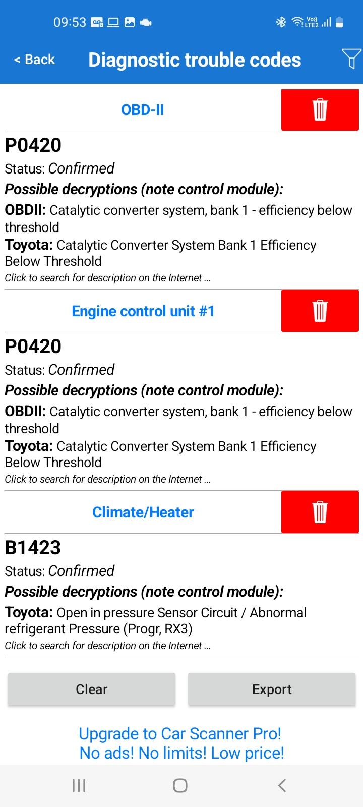

Results are in.
Is it safe to drive and wait a couple of weeks for the MOT or not ? The last job I had done on the car was the exhaust backbox/muffler  replaced as it had snapped into two. Maybe related ?
An EML (Engine Management Light) illuminated is an MOT fail.
1 hour ago, venomx said:
Results are in.
Sounds like a coincidence, if it was OK before I would say that’s a sensor disconnected or wire loose, dislodged when then they replaced the back box. Would speak to original garage that did the work. They will probably say corroded connection or something.
