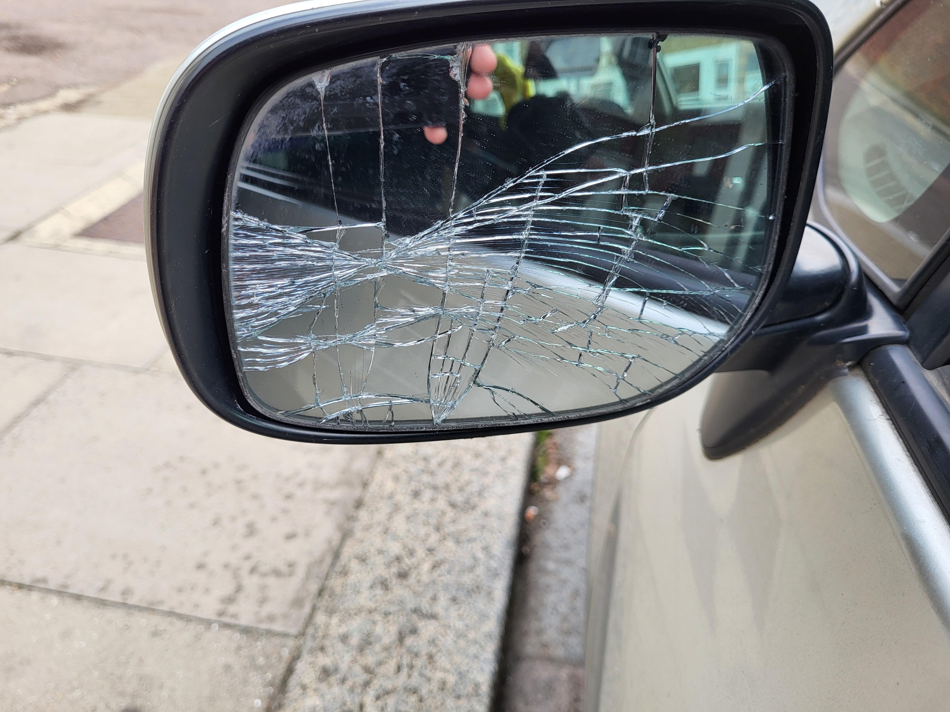

Hi everyone. I just clipped a car and smashed the left wing mirror. I can fortunately still see what's in my wing mirror view but obviously need to replace it. The silver cover came off too but I found it on the road and clipped it back on, it's just a bit grazed.
Which is the best place to get the replacement glass that will have the correct clips on the back? I don't know if Toyota has a reasonable price or if I should try europarts or maybe eBay?

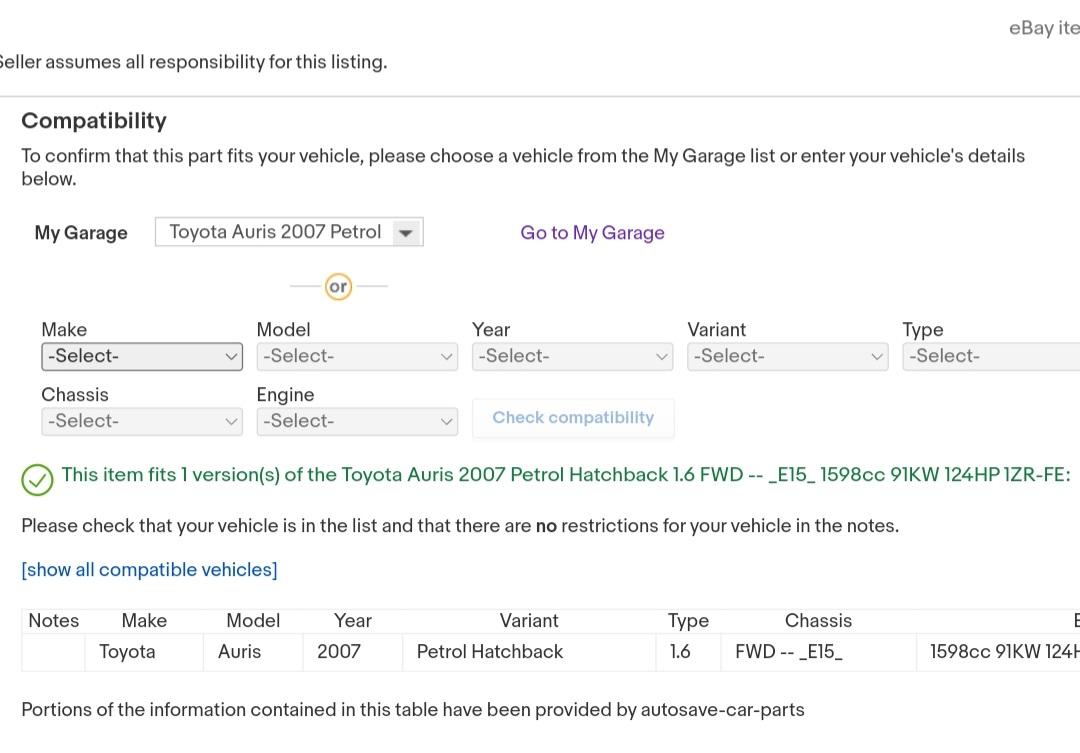

You can look at this one https://www.ebay.co.uk/itm/155171175306?mkcid=16&mkevt=1&mkrid=711-127632-2357-0&ssspo=I70s78DKQ0-&sssrc=2349624&ssuid=p34UK1z2T4m&var=&widget_ver=artemis&media=COPY 🙂

Nice, thanks. Silver as well! I was thinking of just getting the mirror but might as well buy that whole unit. My car is a 2007 1.6 VVTi TR I believe. eBay says the part is compatible, I just wanted to check with you if you think it'll be ok since it doesn't mention TR or VVTi?

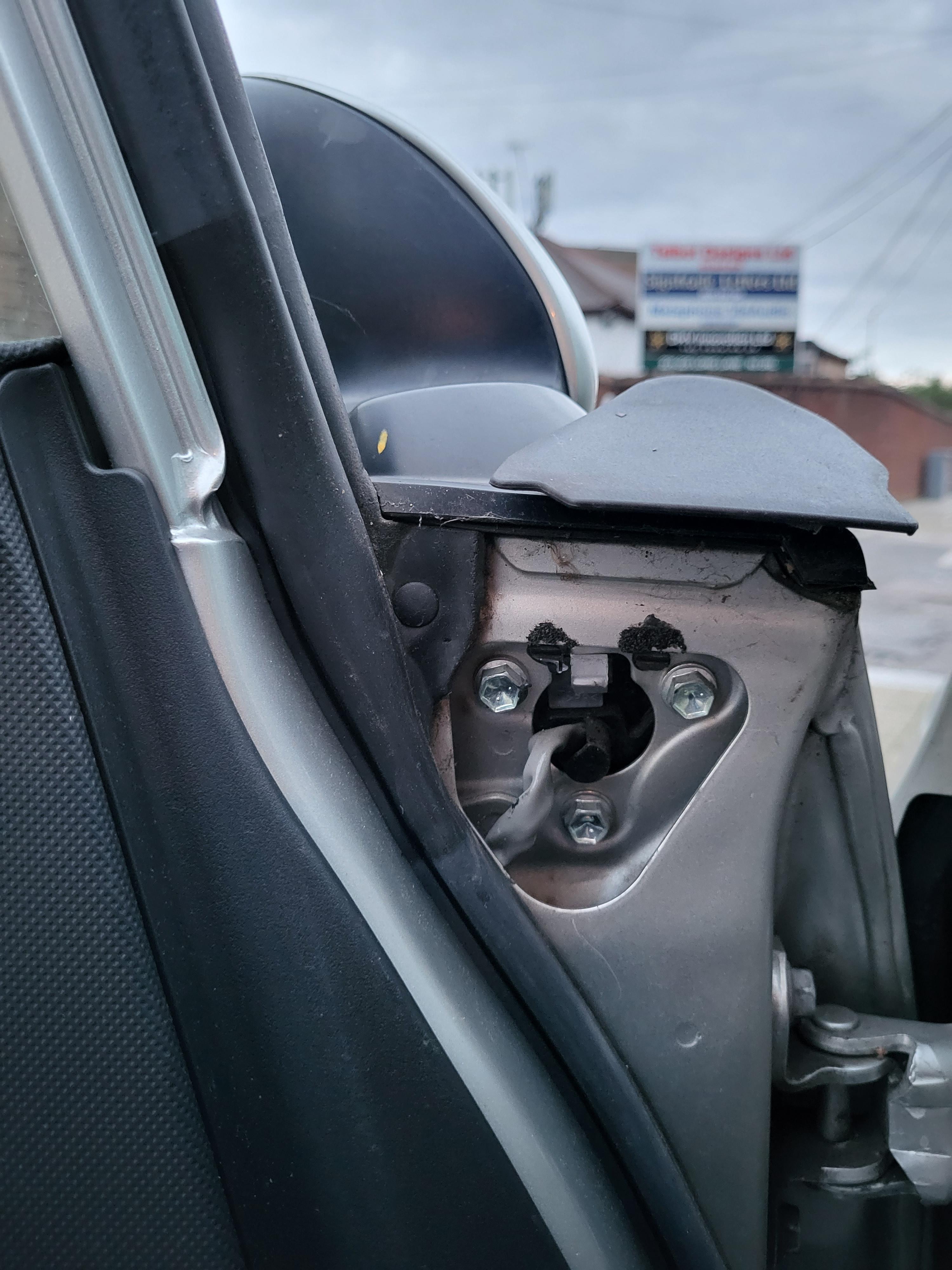

I've taken off the card you mentioned, well actually, it almost fell off and I can't clip it back on very securely so had probably been off before.  Do I just remove the three nuts and the wing mirror unit will come away from the door? Also, I notice in the eBay photo, there's a white plug at the end of the grey wire.  That looks like I'd have to remove the whole door panel, unless I can remove that wire from the replacement unit and connect the unit to the existing wire already in my door?

Thanks Bob. It's electric in that I can adjust it from the interior joystick but not heated or tinted. Do I need to disconnect the Battery when replacing it?
Yes, you need to remove the door panel too to disconnect the wire harness. A plastic interior tools will be helpful. Make sure you don’t break the plastic film all around the door, heat up a bit the glue with hair dryer then pull off one side to work and then reattach the plastic film seal. Here for the tools

Shame it's not just the glass? the mark 3 Yaris was super easy, pull glass part out and take both wires out, got the glass from the dealers at the time but when they said £25 to fit though have go myself.
The glass unclips, tilt the mirror in at the top and use a trim tool at the bottom to pop it off remove the 2 wires
there are only 2 types of mirror glass, if it's electric it will be heated (comes on with the rear defrost button)

Yes, it is just the glass that is broken and easy to replace. It was hanging loose after I damaged it and I saw the two wires attached behind which will be easy to disconnect. I also took note of the clips around the back of it and gently pushed the glass back until it clicked into place. But Jemca, my nearest Toyota dealer, quoted me £74 + vat for that part!
That's the wires for the heated mirror

Aha, well I never knew that. I thought the wires were just for angling the mirror. Nice to know I can heat ice off them in the winter!
