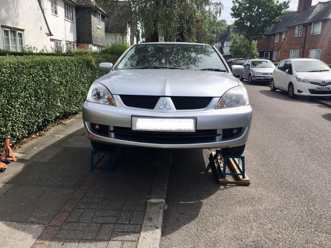

Safety first, or perhaps second. Early days of my car engineering work. What could possibly go wrong. 😂

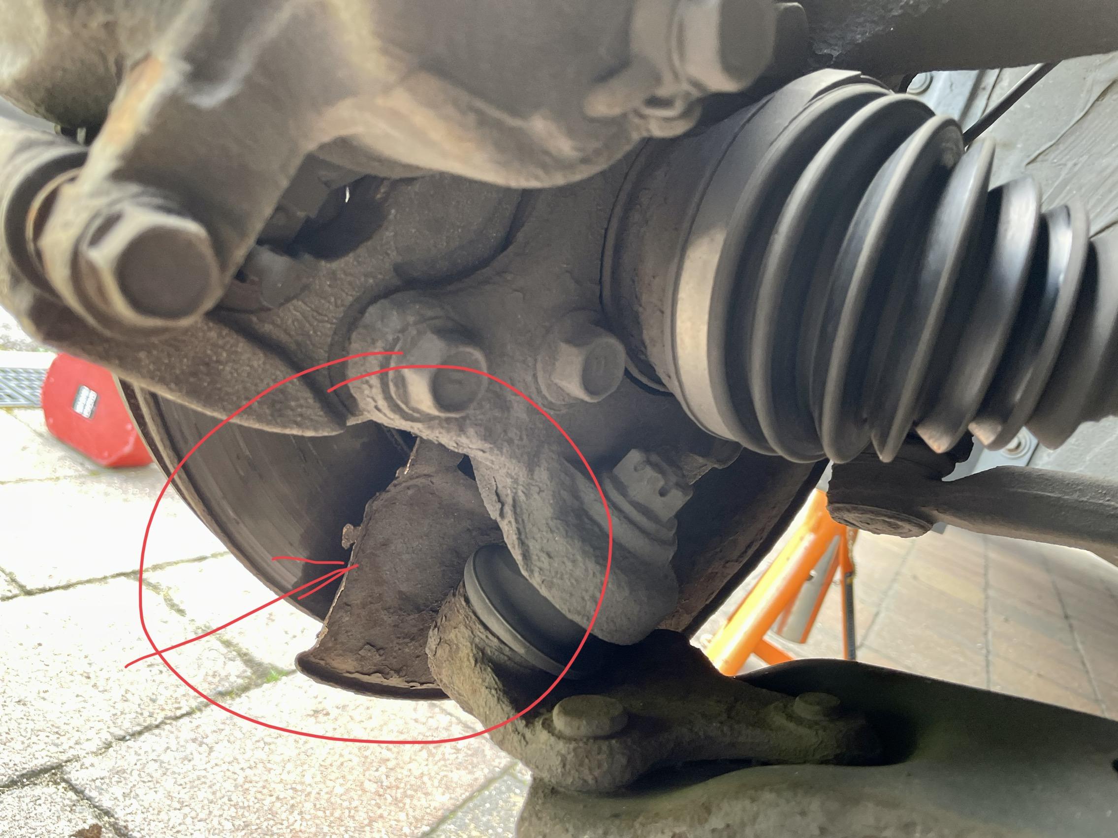

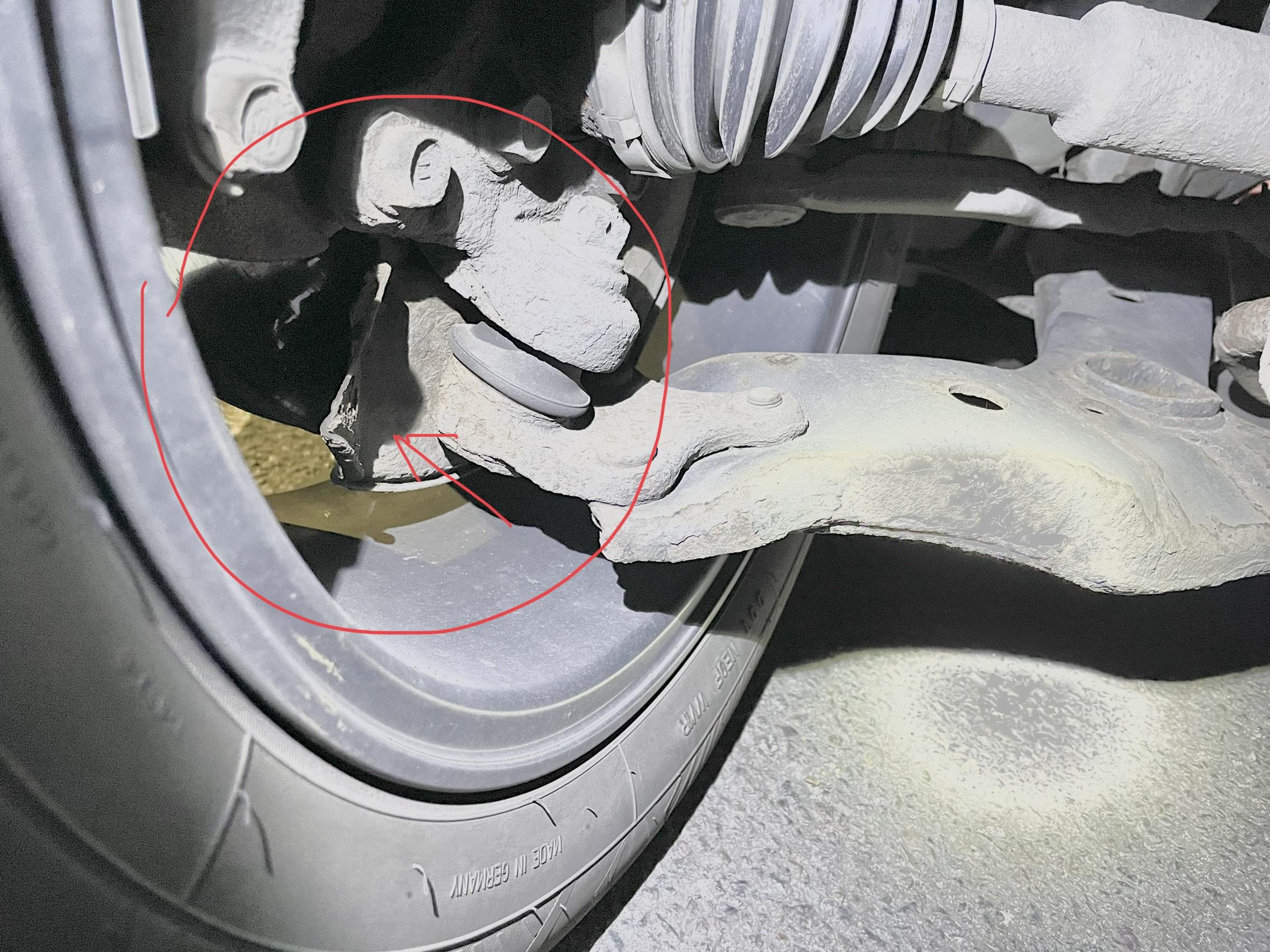

Going under the car today again. Something wrong has happened last night and I need to check. 👍

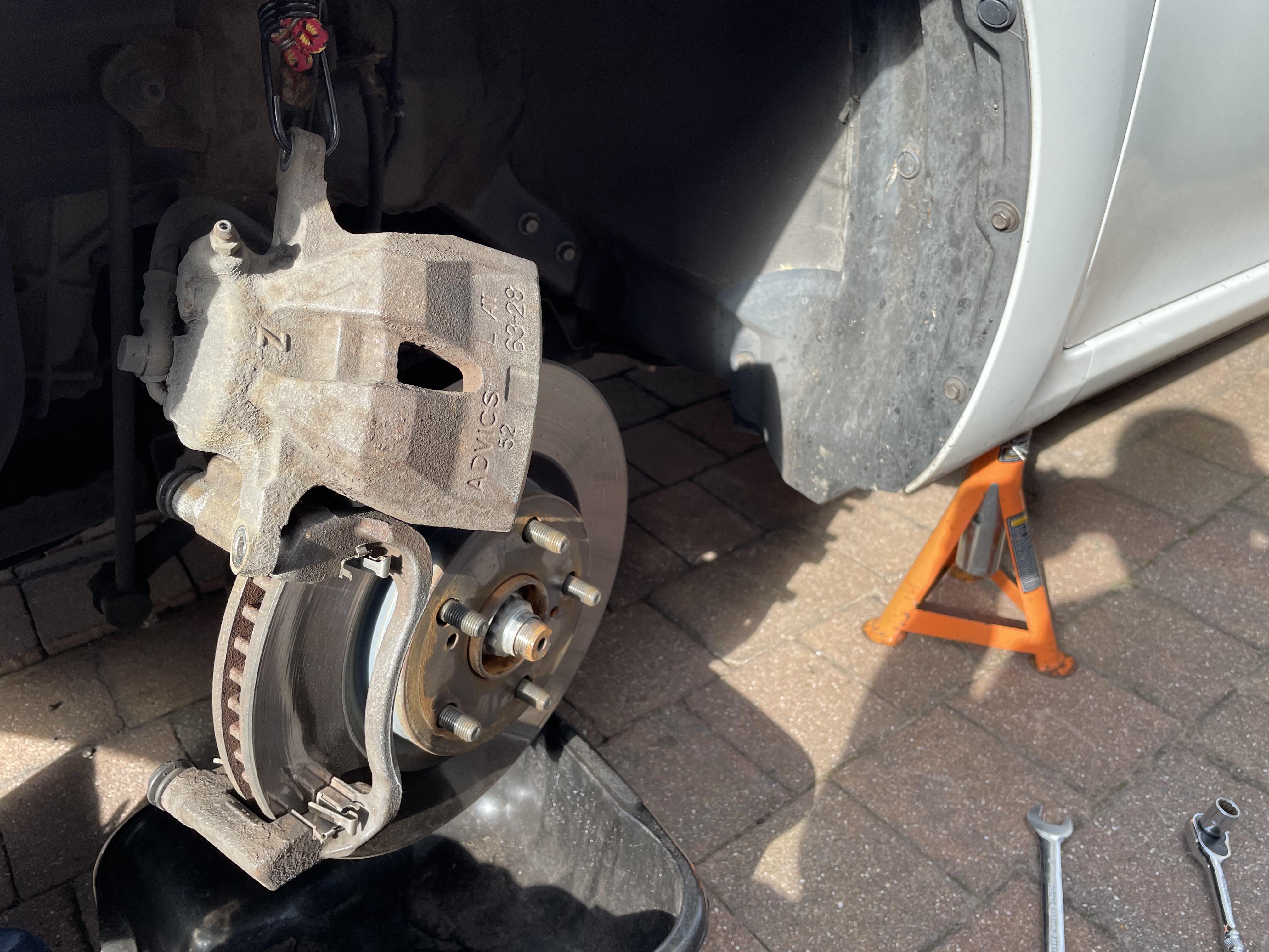

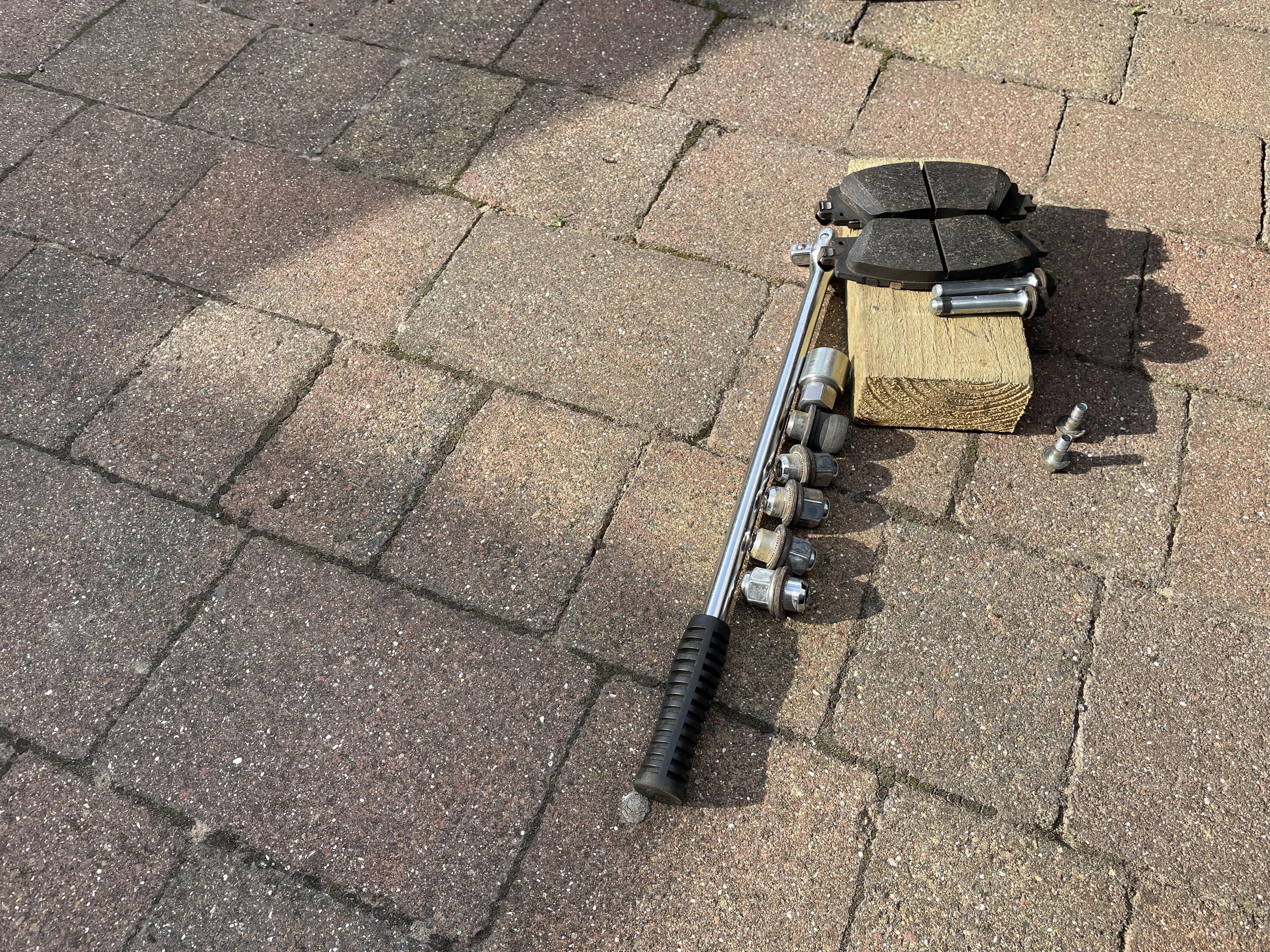

Got my issue solved. The brake disc metal covers, they are old and rusty and one got hit by something and bent and was touching the disc and while turning and reverse the disc squeeze it in and broke it , a loud metal clunk , not pleasant at all, especially when you know you have 150 miles left to complete and it’s 2 a clock in the morning. Have the front brakes serviced as well, probably will do the rears tomorrow. Here some pics.
