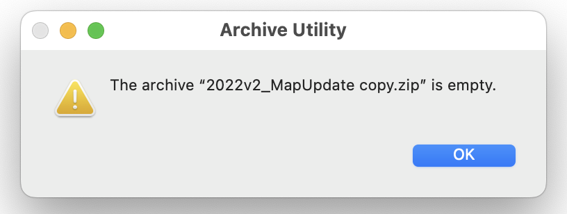

I've now tried twice to download the new maps for my '21 PHEV and manage the 'o' purchase phase and get onto the download. I've now downloaded the zip file twice (13.7Gb file) and each time I try to expand the file it returns zero contents.
Any one had the issue and come up with a fix?

Really surprised that I was not able to complete the task using my Mac / Safari and even more so when I tried the same machine using Chrome. Luckily I still have a Windows based machine to run some old software that’s occasionally required. Good old Toyota giving the brain a run for it’s money!

Ernie, just out of interest I tried on my Macbook, again using Edge; it downloaded fine, shows in downloads as being 13.67GB in size, but I get the same pop-up as you if I try to unpack it!!
I'm not up to speed on Mac OS, but it seems that's where the problem lies.

Philip, I agree that it should not make any difference which platform/OS/browser you use. My experience is it does not like an iMac with either the Apple Safari or Google Chrome browsers. Edward seems to have the same issue using a MacBook (same OS) but using the Microsoft Edge browser.
In all cases it will download but shows not data after you try to unzip it. I’ve tried a number of ways to unzip it and get the same result.

See my reply to a similar thread on this forum, issue is with default iMAC decompression tool......
Thanks Alan, I used The Unarchiver and it did not work for me?

Just managed to unzip the original Safari file using 'The Unachiver' (version 4.3.5) which I've used before but seems to have been hidden since I upgraded to macOS Monterey (currently 12.6).
