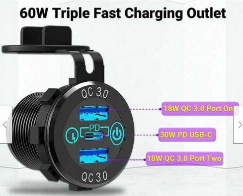

While fitting a 12v cig type socket, might be better to also fit one of these usb A and C sockets as well.
