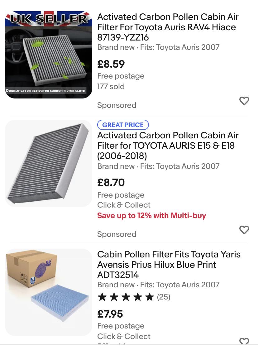

Edit: I found this one at a place called GSF. Only 4 miles from me,  I'll go buy that as it's only £9.  I checked europarts but theirs are £23 to £53.
https://www.gsfcarparts.com/drpc12-0217?auto_apply_coupon=MID65&gclid=CjwKCAjwwL6aBhBlEiwADycBIBhyO0otmvu8sGrkvgguHG1lBWwR_h-S49qZfbYeZoqwqp99abhwrhoCE8sQAvD_BwE
£53?!  Loads on eBay under £10, same fitment as some Yaris, RAV4, Avensis.

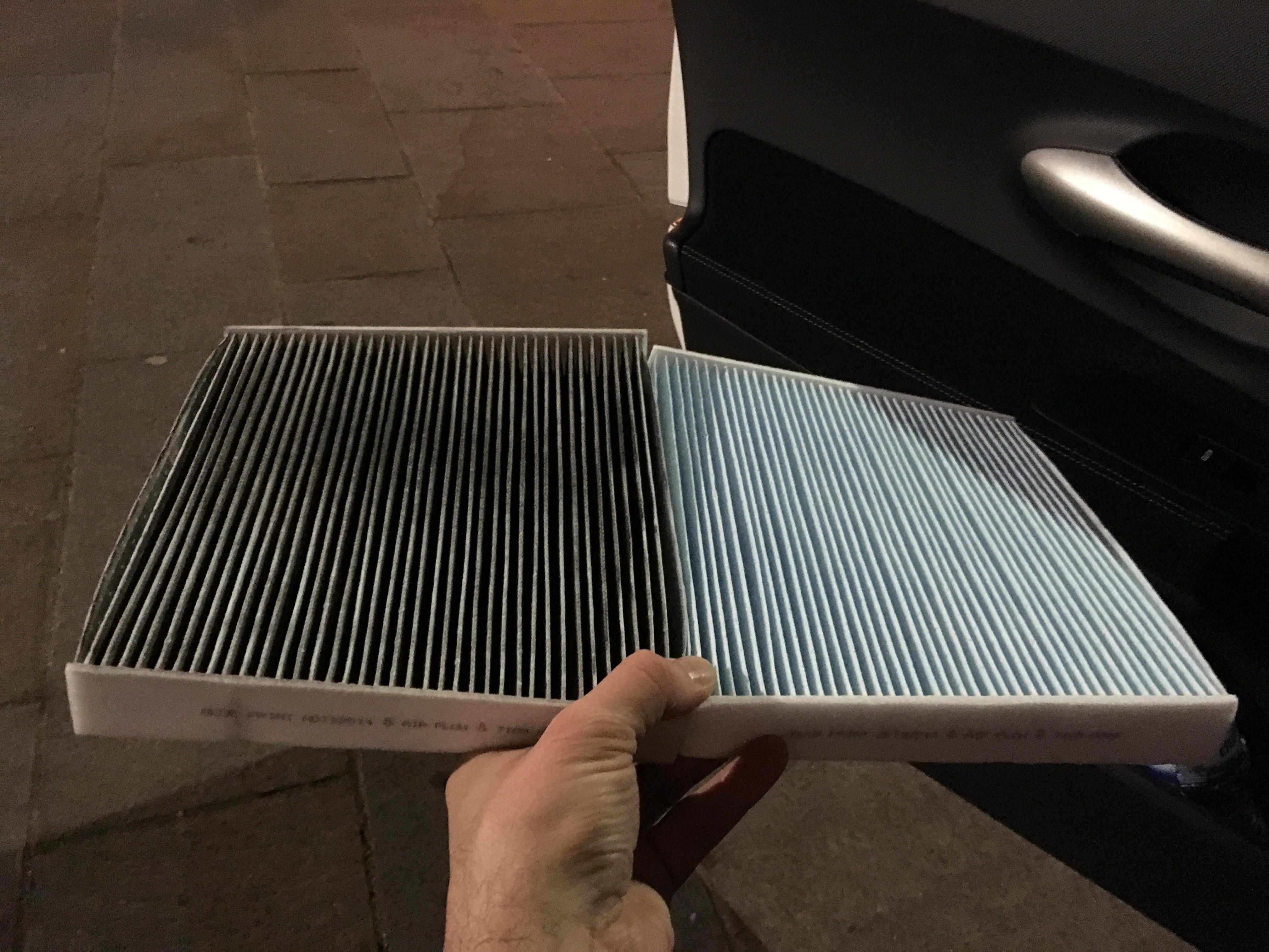

Indeed. The best filters I found are the Blueprint simple cabin filter. Very important though to change at least once a year or with every service and do not follow manufacturer recommended interval of 2 years or 20k miles. This is the most important filter in your car and protects you and your passengers from harmful emissions. Even if the filter look good on first sight once changed its colour  and start smelling of fumes, that’s it, it need replacement. Here a deal 4 for £17.50
https://www.ebay.co.uk/itm/174967215003?mkcid=16&mkevt=1&mkrid=711-127632-2357-0&ssspo=CfWbZDI9QQ6&sssrc=2349624&ssuid=p34UK1z2T4m&var=&widget_ver=artemis&media=COPY

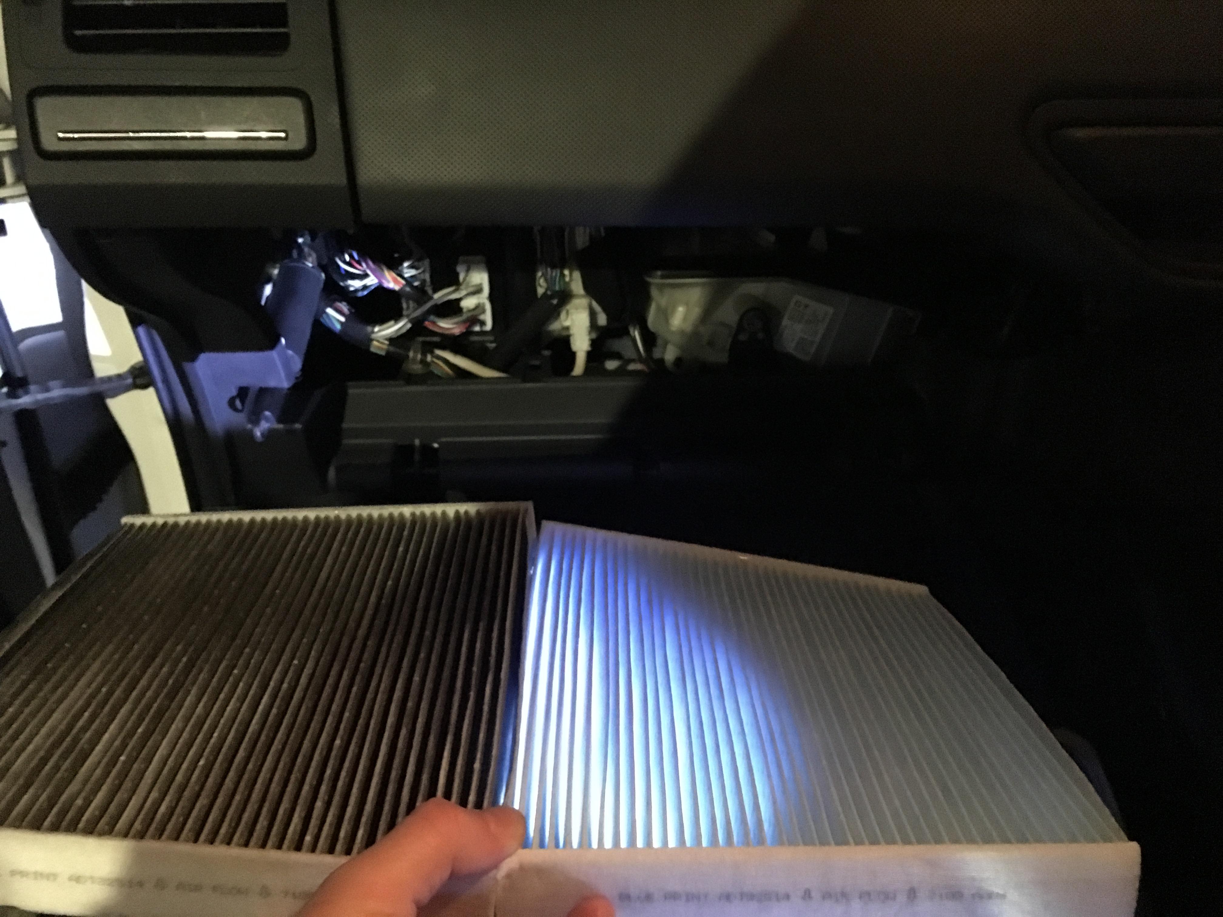

Super easy to change.

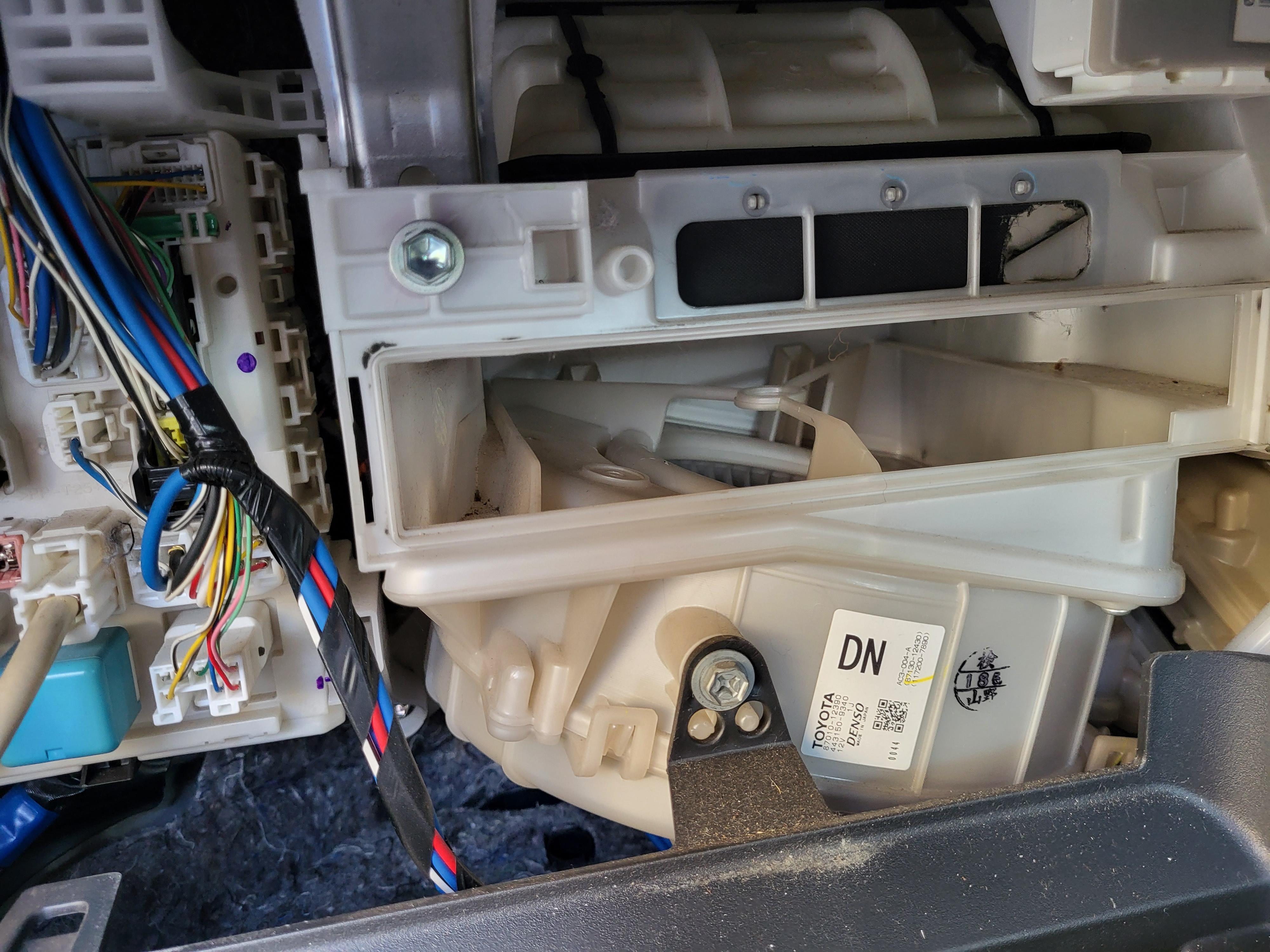

Open glove box, empty it. Unclip carefully the shock on the side, push your fingers on top of the box between the box and the dashboard, tiny space and lift the plastic up it will release two small teeth and the box will be able to drop further down, use the seat sliding to support the box if you don’t want it out of the dashboard. Unclip the black cover, take out the old filter, make sure where the fan is everything is nice and clean, install the new filter with air flow top to bottom, place back black cover to click in place. Lift up box until teeth click in the dash, attach shock dampener, job done. 👍

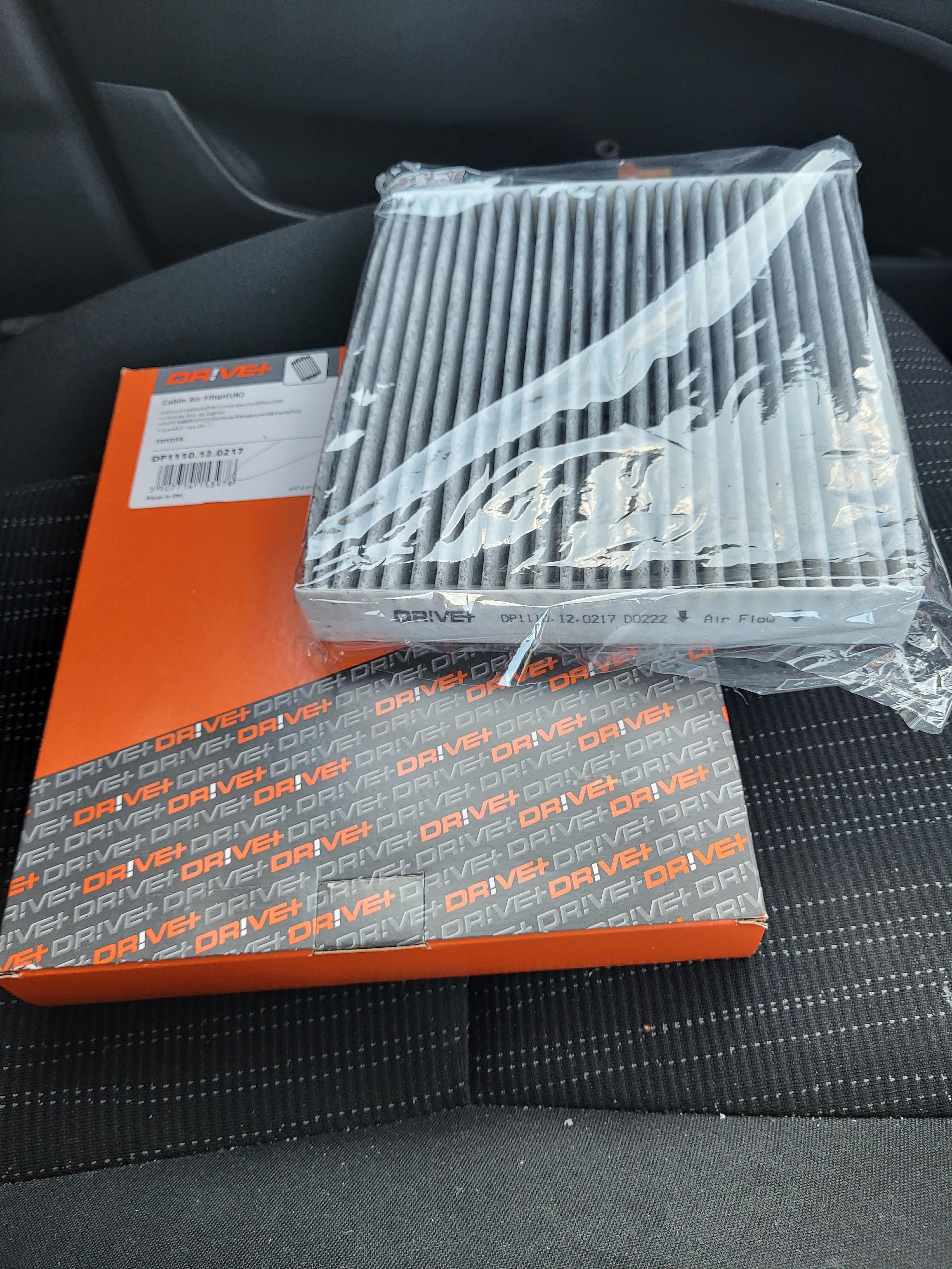

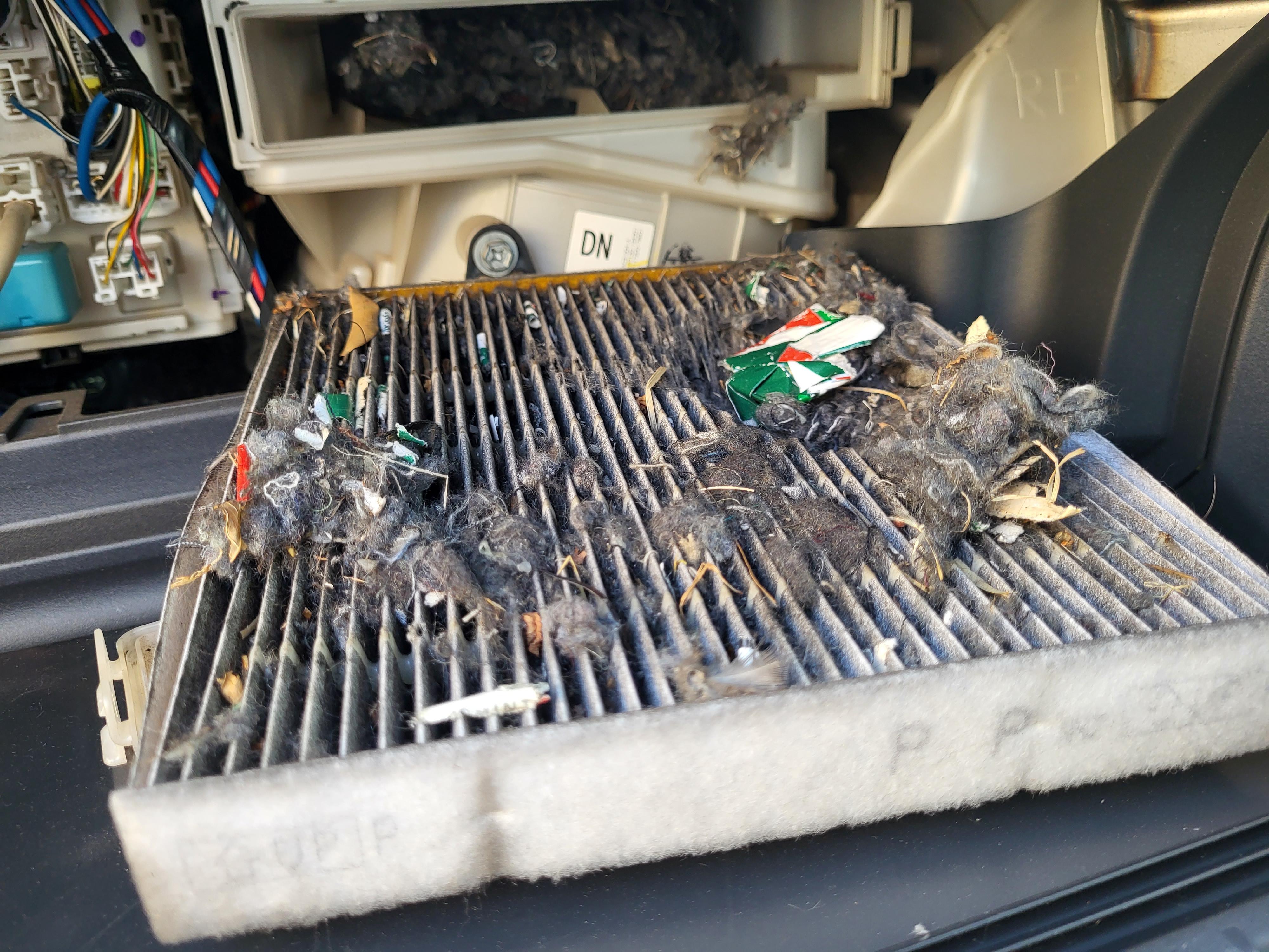

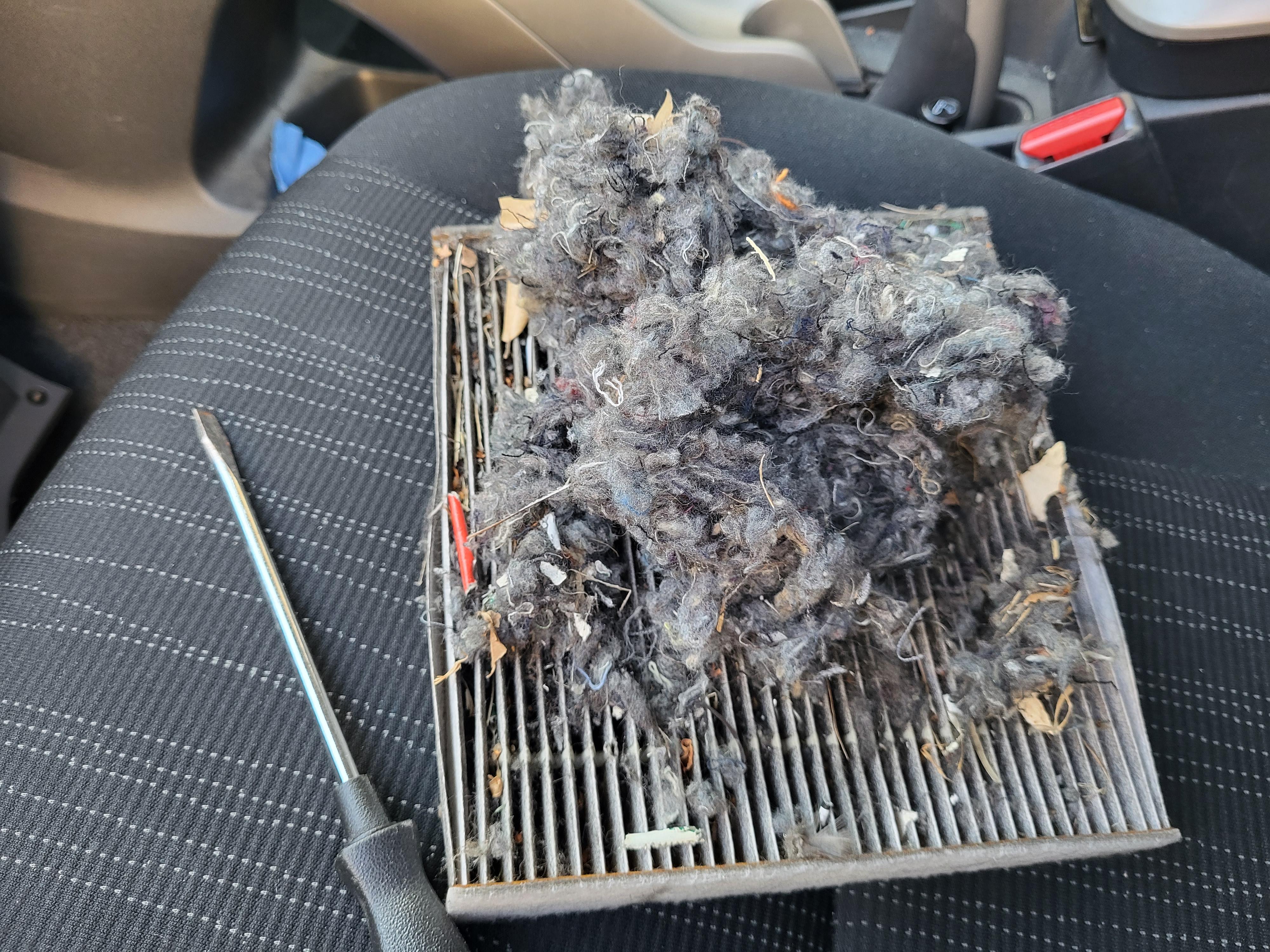

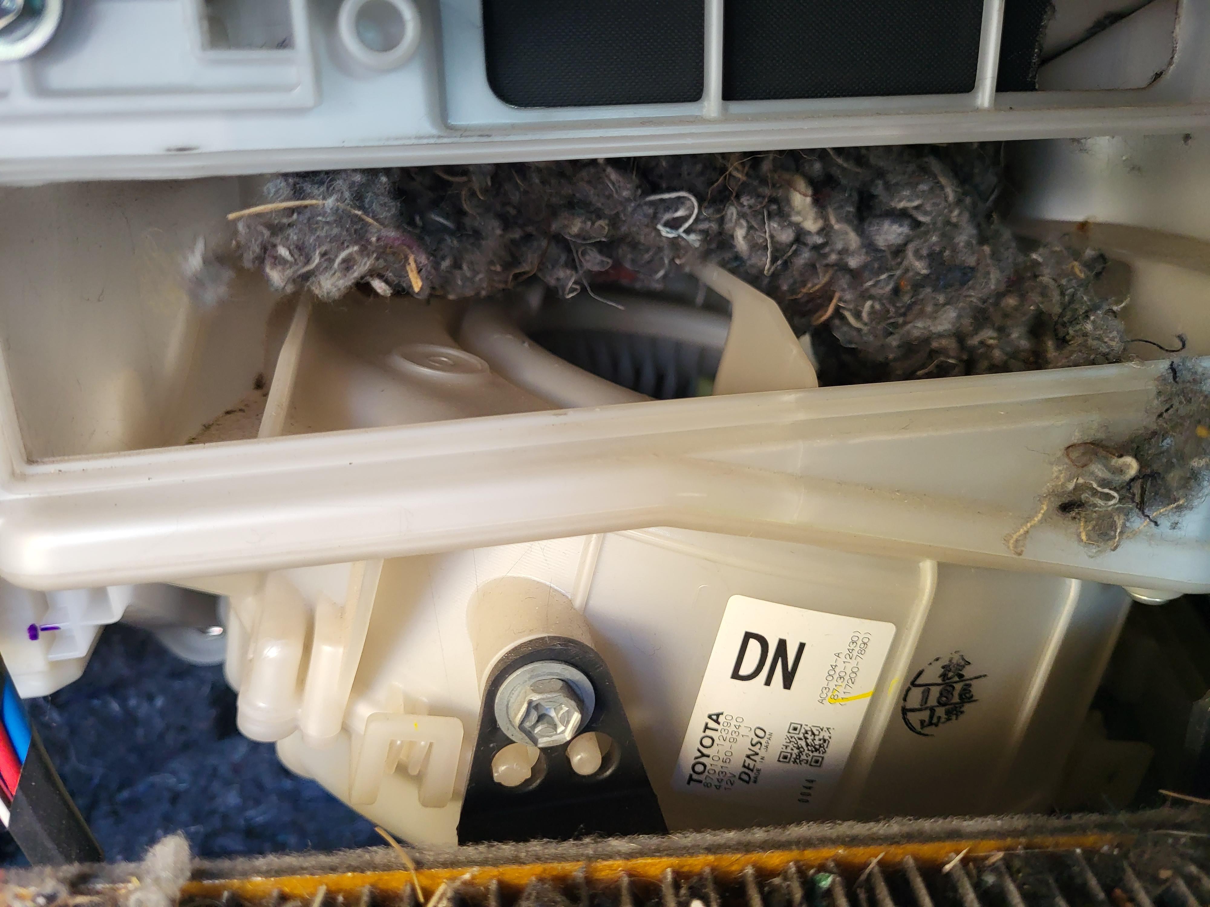

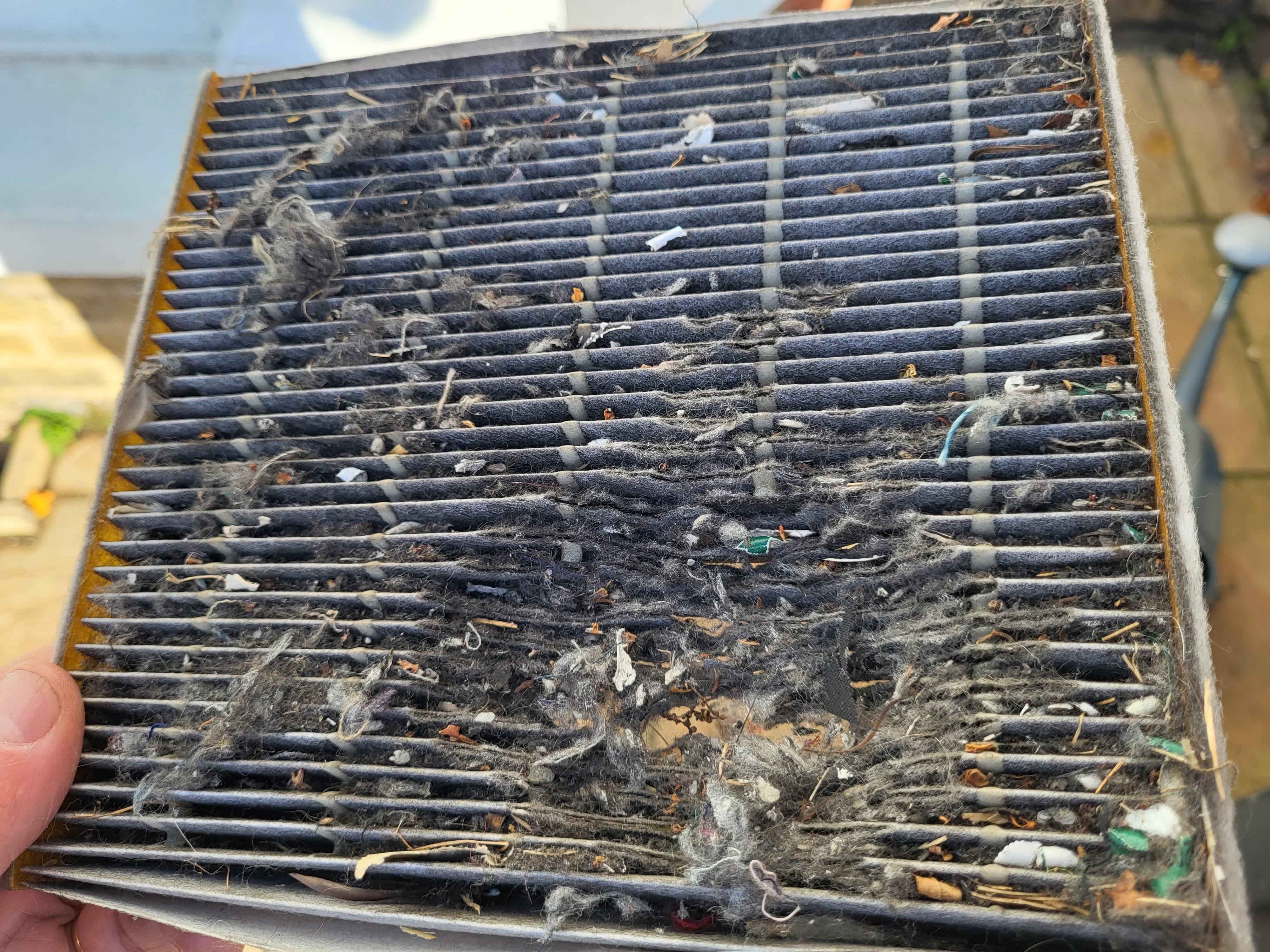

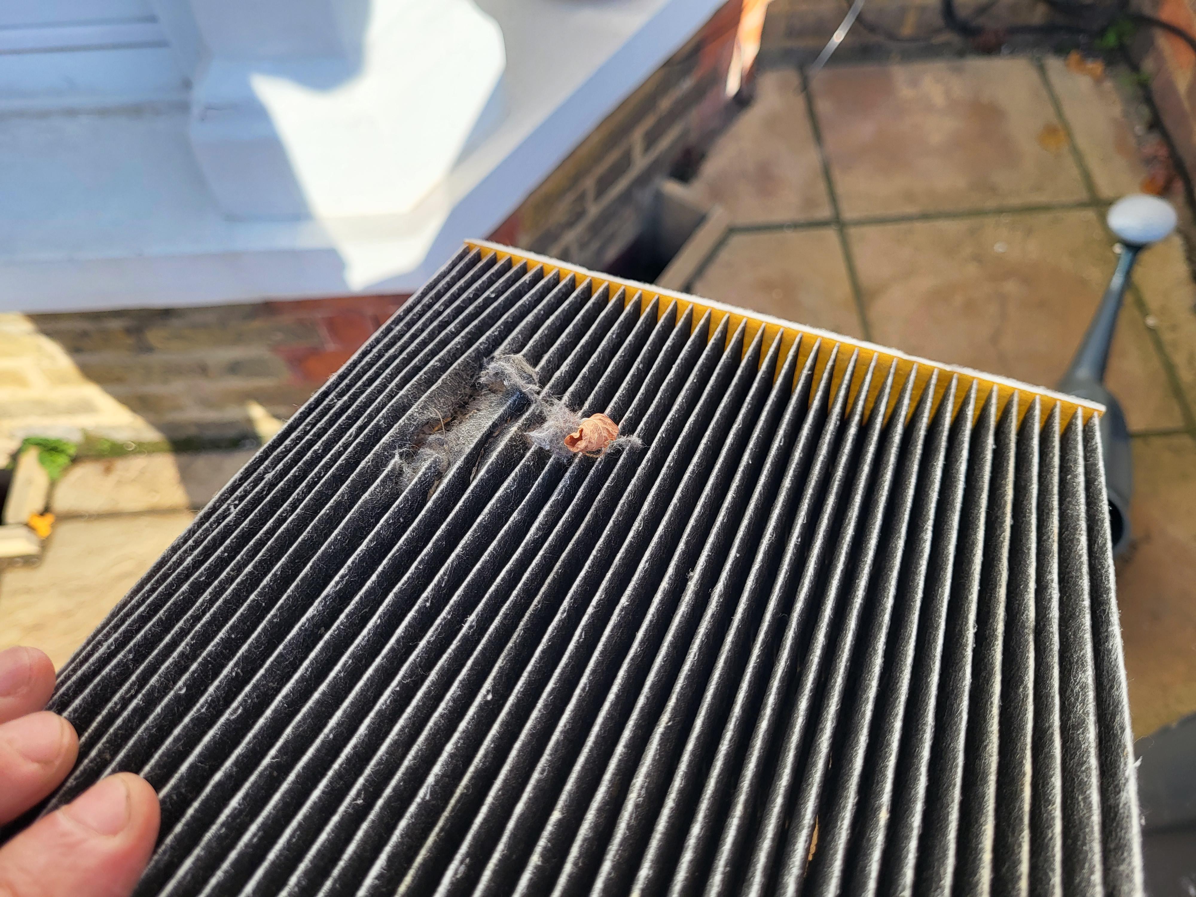

Thanks guys.  Yeah Tony, I'll do that, I'll change the filter regularly now that I'm aware of it.  I've just bought a filter for £9 from GSF Car Parts which I'm about to fit when I get back home. I'll keep your eBay link though for the next time.   I'll give a quick vacuum behind the glove box area first. I unclipped the glove box and found a dust clogged and slightly ripped old filter. No wonder I got a musty smell!

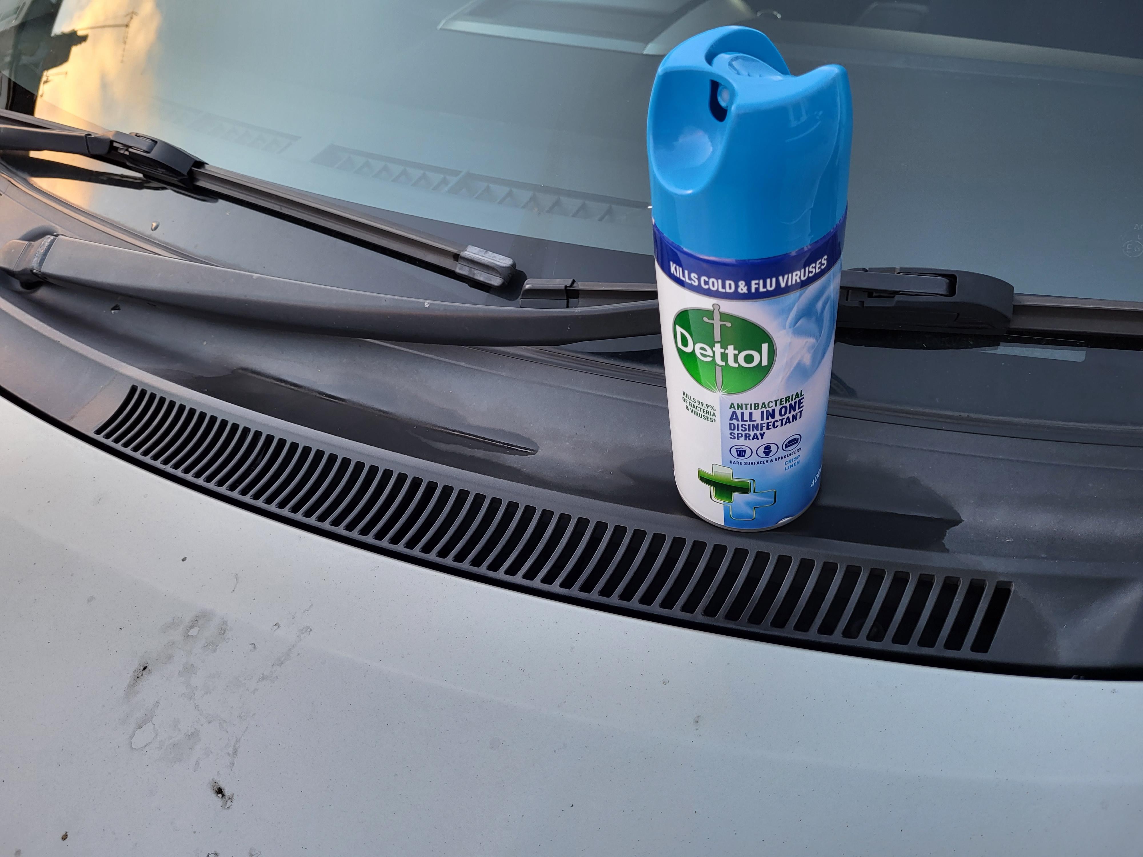

If you like to use any dissectant best one is Dettol antibacterial
https://www.amazon.co.uk/Dettol-Crisp-Linen-Disinfectant-Spray/dp/B084R1XD3T/ref=sr_1_8?crid=SLH4PZ8FEAN0&keywords=dettol+aerosol+disinfectant+spray&qid=1666199955&qu=eyJxc2MiOiIzLjYxIiwicXNhIjoiMy4xMSIsInFzcCI6IjIuNzgifQ%3D%3D&rdc=1&sprefix=dettol+spray+aer%2Caps%2C131&sr=8-8
If you want to use that , you can while doing the procedure above. For that purpose, you have to remove the cabin filter first. Spray few shoots into the air suck vent outside the car near the passenger wiper blade. Do that at the beginning of the procedure, and then let the car dry itself. Better not to spray directly into the air vents ins the car or use any specific auto solutions. Some  may cause more issues than help.

Right, car is currently in part 1 of the airvent bacteria killing process. On fan speed 2, max temp, dash/ feet, and I decided to buy a can of Dettol from Waitrose,  only £2.50, and I've sprayed into the vent by the Wiper Blades.
Right, all done! However, I forgot to remove the new cabin filter before spraying the Dettol. 🙈

Oh well. Did you spray a lot to just a bit? If you made the new filter wet it will dry but you may have some moisture on the inside the windscreen. Not a big deal as when you use the car and the heating is on it will dry everything again. Btw it is a good idea to keep fan always on so the system gets well ventilated every time you use the car. my hvac settings are 22C° , air flow windscreen and feet, fan speed 2. I don’t adjust anything as the system is auto and it’s smart so she does it all. In summer settings are similar but I change air flow towards middle of the dash and feet, turn on or off the ac if needed. 👍

I must have sprayed about 8 or 9 shots. To be honest, looking into the outside vent it looks like it's quite distant from any spray getting to the heating system but I guess it must.
