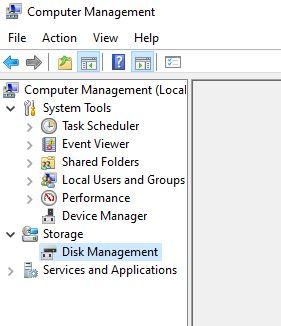

1 hour ago, the brace said:
The car will recognise only sticks up to 32Gb.
If thats the problem, before buying a smaller Stick, try partitioning  your 128Gb one down to under  32Gb and then copy a couple of tracks over to see if it works.
A 128Gb Sandisk stick works fine for me when formatted in FAT32. I'm not saying exFAT won't work because I haven't tried it, but it's not mentioned in my PDF owners manual (page 434).
It's a common misconception that FAT32 file systems are limited to 32Gb. That's actually a limitation of the Windows formatting tool, which they've never bothered to lift since the days when anything larger than that was too much for the human mind to conceive. A linux or Mac based machine will be able to format all of your 128Gb stick in FAT32 just fine.
