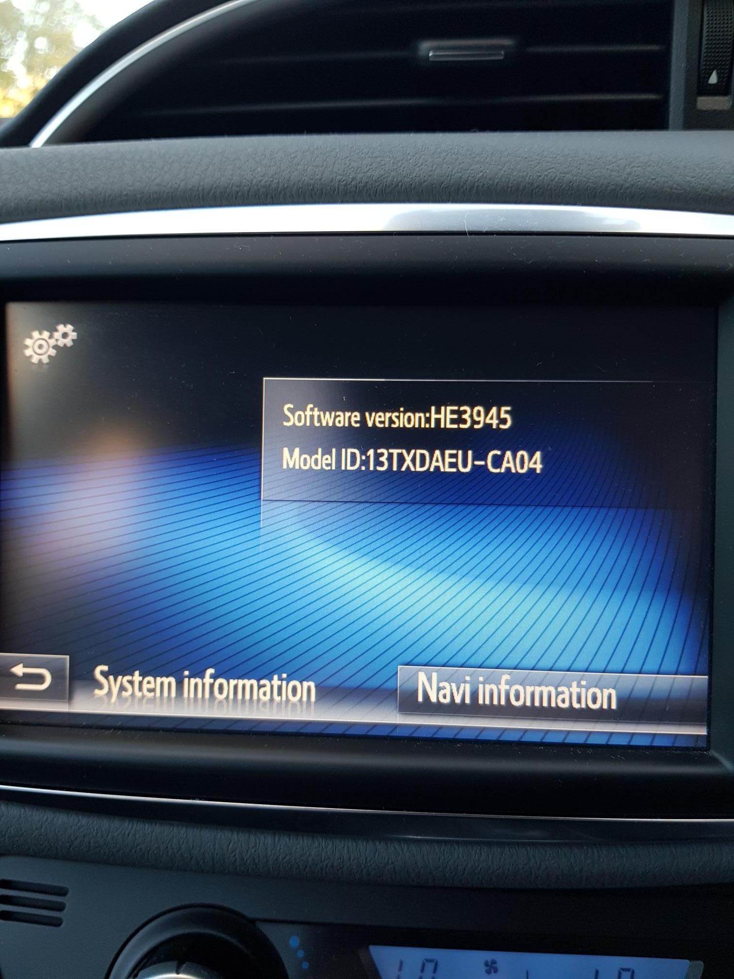

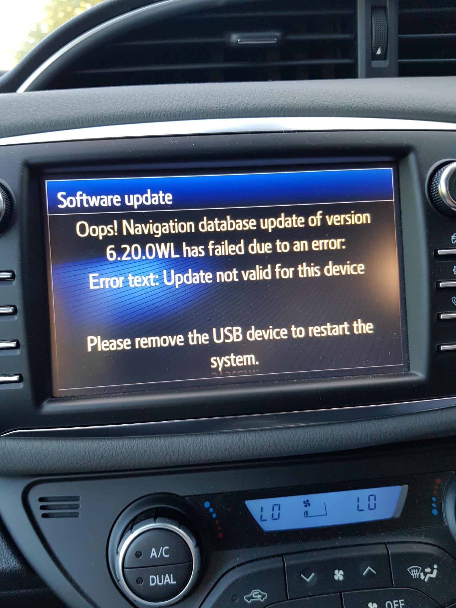

I tried updating my 2018 Yaris Hybrid satnav (I subscribed to 3 yrs of updates). Unfortunately, I forgot to use TeraCopy to put the files on the usb stick and the update failed with an error (presumably bad file copy). So I recopied the files and tried the update again but am now getting an error saying that the update is not valid for my device.

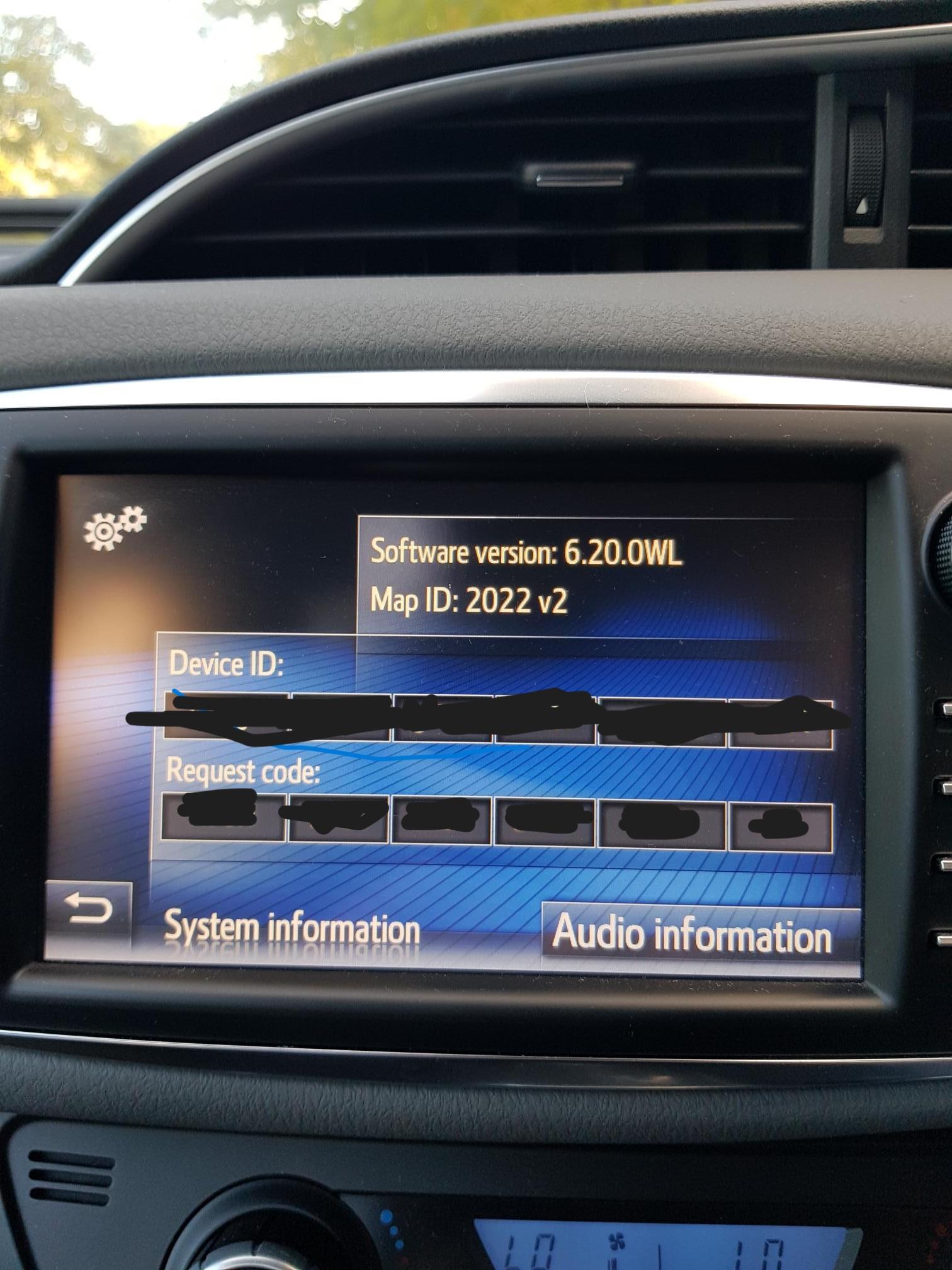

I checked the current versions installed and it appears to think that the update has been successful - is that why it is saying the update isn't valid? Is there any way of forcing the update to run so that I can be sure all the changes happened?

1 hour ago, flash22 said:
It failed as you have the most current version installed already
Thanks, thought it might be that. Is there any way to force a re-installation so that I get whatever was missed off?
