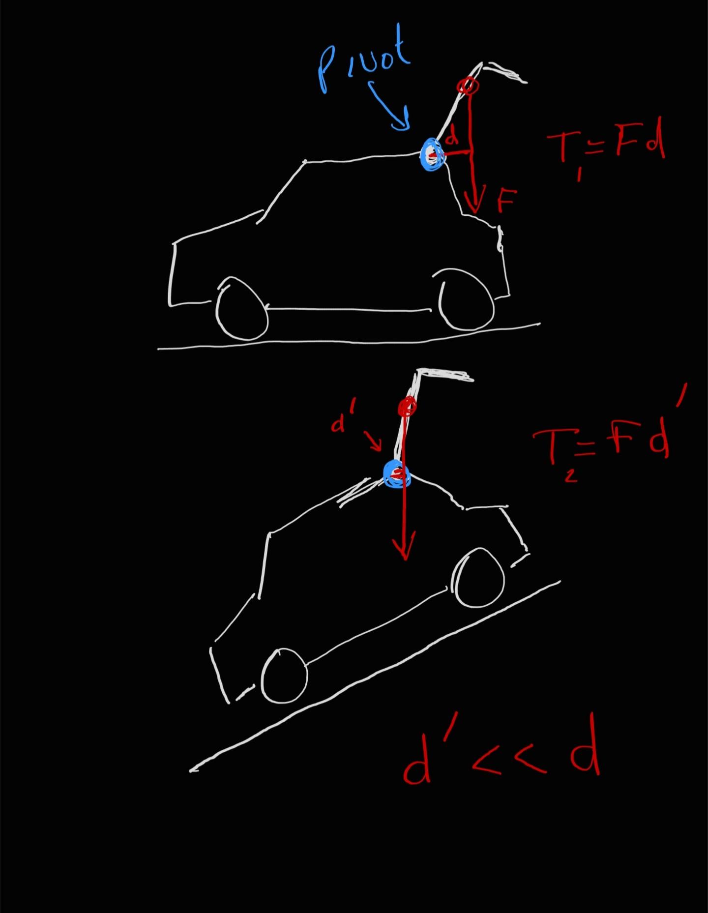

I suspect there's a torque sensor on the boot motor or mechanism somewhere. If the torque is out of range it may refuse to engage the motor. Straight and level with the boot door up there is probably a high torque albeit braked. But if the car is on a steep slope pointing downhill I imagine the centre of mass of the door is now shifted inwards towards the vehicle centre. As a result that's a much lower torque.
Bizarre though they'd put a feature in for too little expected torque. Too much I could understand. But not too little.
Diagram attached.

Suspect when you gave it a pull you put the torque into the right range since you shifted the CofG of the door. As per diagram above.

If it is really steep the torque might actually be in the reverse direction. Boot CofG is forward of the pivot. In that case the motor believes it is encountering resistance so doesn't engage.

Thanks Ernie. So this is entirely understandable logic from Toyota. There was probably negative torque here which is interpreted as resistance to the motor wanting to shut the boot (I.e. someone trying to stop it closing or has head trapped in it or small child getting squished). Safety mechanism for certain.
