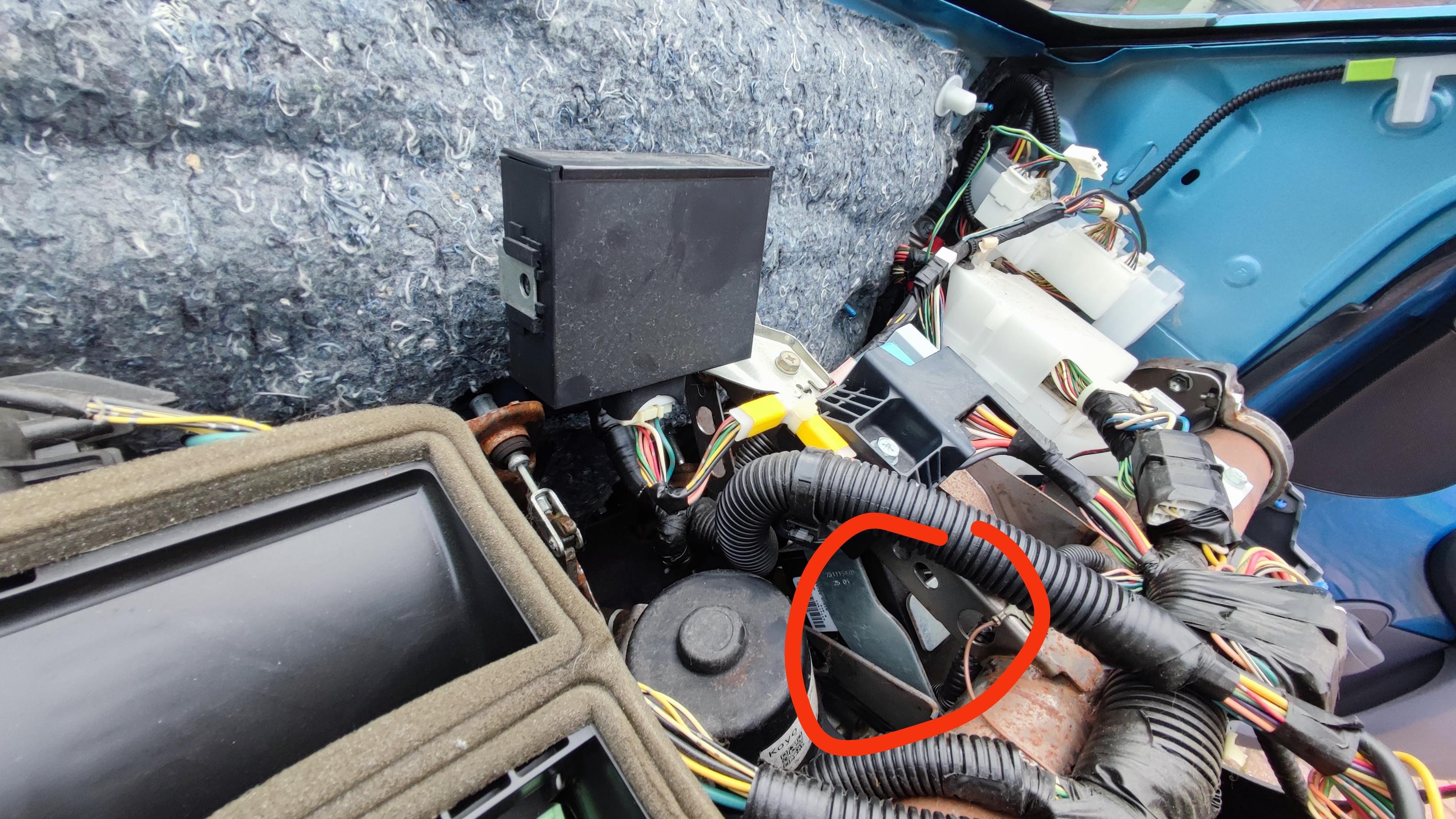

Hi flash22, thanks so much for your reply (and the thread which sounds similar - lots to learn). One question, I thought the immo box was the one circled here, am I wrong?
That's the one, a right pain to get at

One thing that's bugging me is that there was heavy rainfall the two nights before it stopped working. Is there anything behind the engine or at risk of humidity that I could check? Also, flash22 could you let me know what the other black box is at the back under-dash, sticking up in the photo - if this is connected to the immo is it worth checking the connections there also?

The upright box iirc is the door control ecu aka remote locking and nothing to do with the immo
