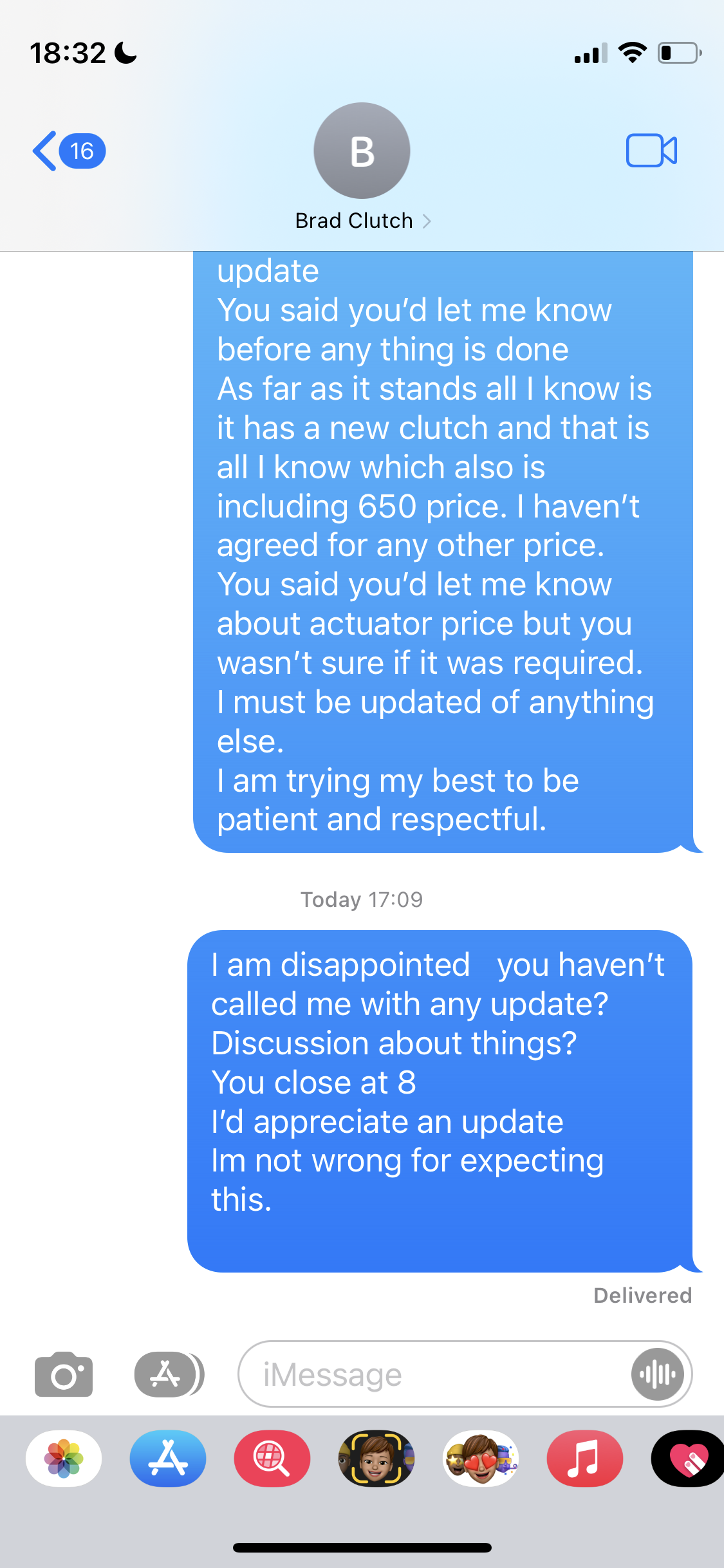

Just a snapshot of how much limbo I am in!
I haven’t shown any phone number of anything and wouldn’t do that.
So am respecting privacy- Brad is my car.
just showing you why I am so frustrated.
I wouldn’t want to cause anyone stress 😞
I guess I am worrying that my car is beyond repair and he isn’t telling me- I have asked him! He hasn’t said yes or no to when I ask is car broke completely. AB5A8C8A-F01E-4E14-AFA2-8E4932B8EA29.thumb.png.6f3a452a8498d3062c036e460c9be410.png
