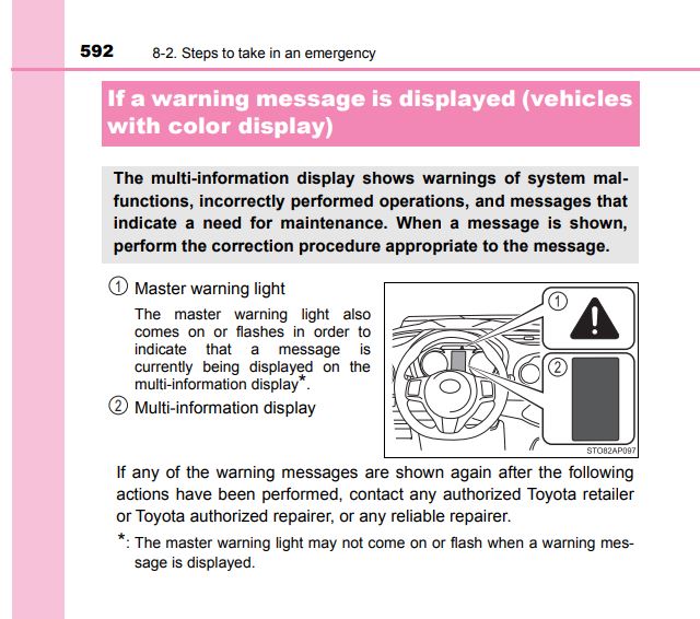

This is all new to me Max.  I didn’t know oil warning lights weren’t displayed on your vehicle and the fact the online manual makes no reference to it either.
3 hours ago, WARDY67 said:
That's exactly my concern too. I am going to contact toyota and get their reaction. I will post their comments once I have a response.
You might be able to find the info here, i cannot find my logbook to get the Vin to allow me access i will have to ask the wife where she has moved it from where i normally keep it  put it away for safety
https://www.toyota.co.uk/customer/manuals
I don't think the manual i read was an official Toyota one as i said above i haven't got my Vin, i have done quite a bit of searching and cannot find the answer, with luck Wardy can get into the site and get us the answer.

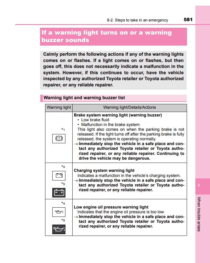

So all 1.5 non hybrid Yaris has no red oil warning lights ?

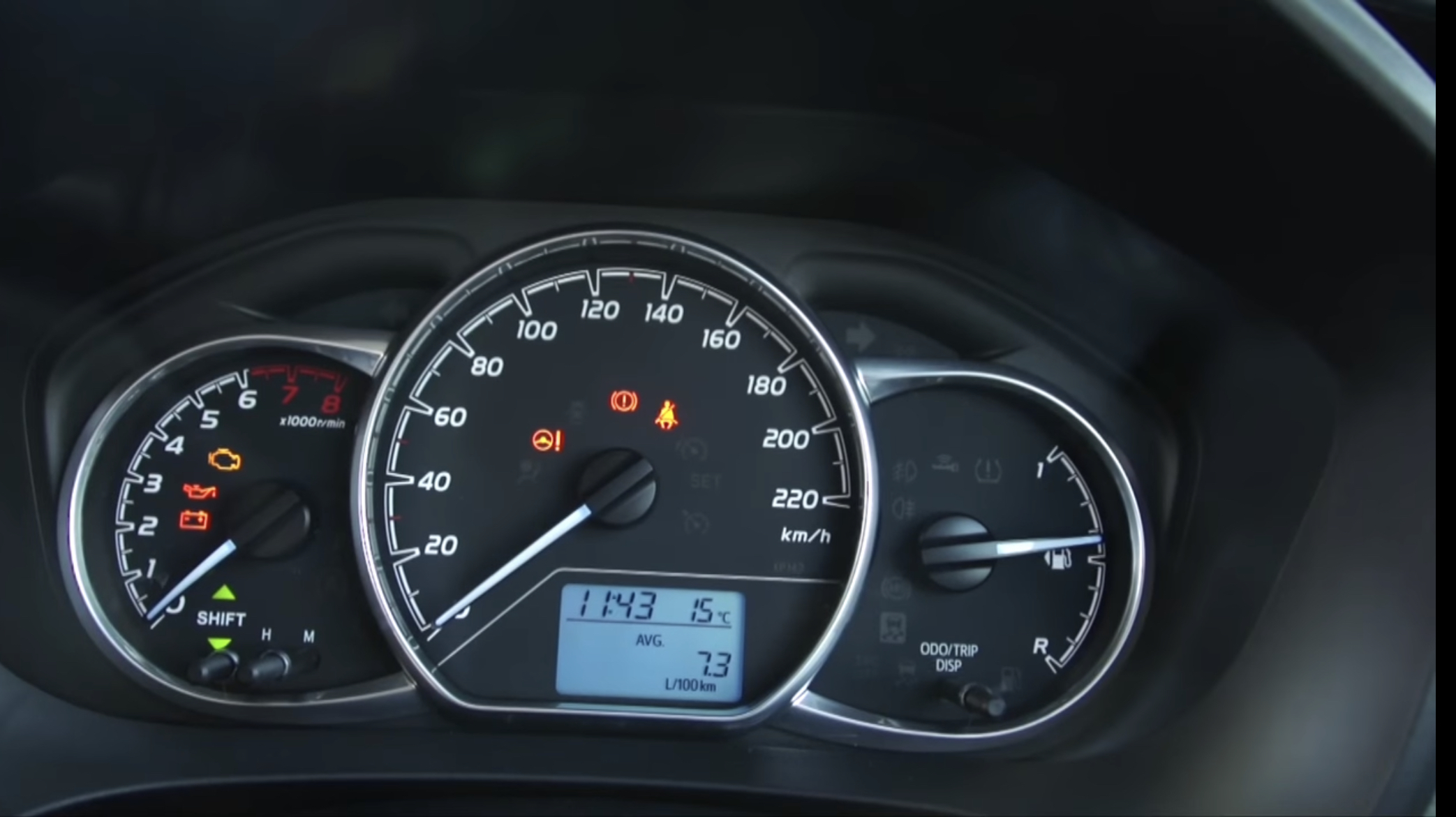

To me it’s hard to believe and perhaps there might be a blown bulb or something else but should be an oil warning light there to the left like on this picture. You can look day time with your phone flash or torch or under direct sunlight if there are icon markings for a oil pressure light and if yes then means there is but it’s not working for some reason.

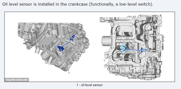

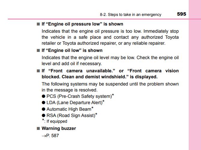

An oil level sensor is installed in the engine. So some kind of warning will pop up when this will be a problem.
Hi Robert, Your correct there is a low level warning sensor fitted but that doesn't tell the drive if the pressure is low. It seems that car manufacturers are very remiss in not fitting a pressure warning light. 🙄
