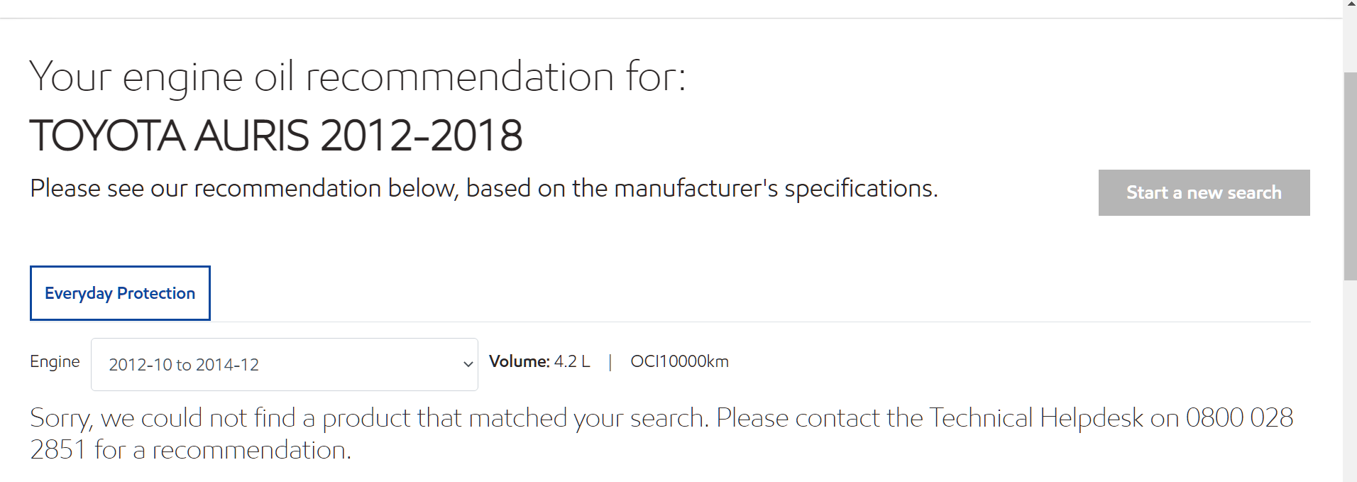

Perhaps I am missing something?  According to the Mobil website they don't offer an oil for our 2013 Auris hybrid.
I just get this panel displayed:
Looks like a phone call is needed.
