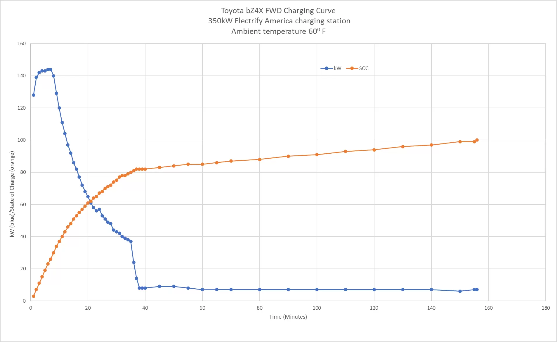

We know from EV lore that DC fast charging works effectively between 10% and 80% and tails off rather dramatically thereafter but we don't have much data specific to the bZ4X charging profile. And this is compounded by the fact that a US spec AWD has a different Battery to a European spec AWD. We have the 71.4 kWh Battery that will charge at a peak rate of 150 kW in both FWD and AWD models.
So far I've found only one set of data for the charge profile - from a US FWD owner:
(this has been shared previously)
Reading across from this data, at a 25% state of charge (your first stop) you should have been able to charge at a peak rate of around 145 kW - a mere 58 kW suggests that the Tesla supercharger wasn't quite up to the job.
You then charged to 80%, drove a round trip of around 100 miles to get back to the same charger - if I've done the arithmetic correctly! I can't sensibly guess your SoC at the second visit, but logically you could have been at around 30%? And at 30% you should still have been accepting charge at a peak rate of 130-140 kW. Again, the figure of 28 kW from the Tesla supercharger seems very disappointing.
But you added 17 kWh (so, ~24%) so you would have been at a 50% - 60% SoC when you left. ?
It would be a complete work of fiction for me to attempt to guess your SoC when you arrived at the Instavolt charger ... 😄
... but there doesn't appear to be that much benefit to be gained from a greater than 50 kW charger once you get above about a 50% - 60% SoC

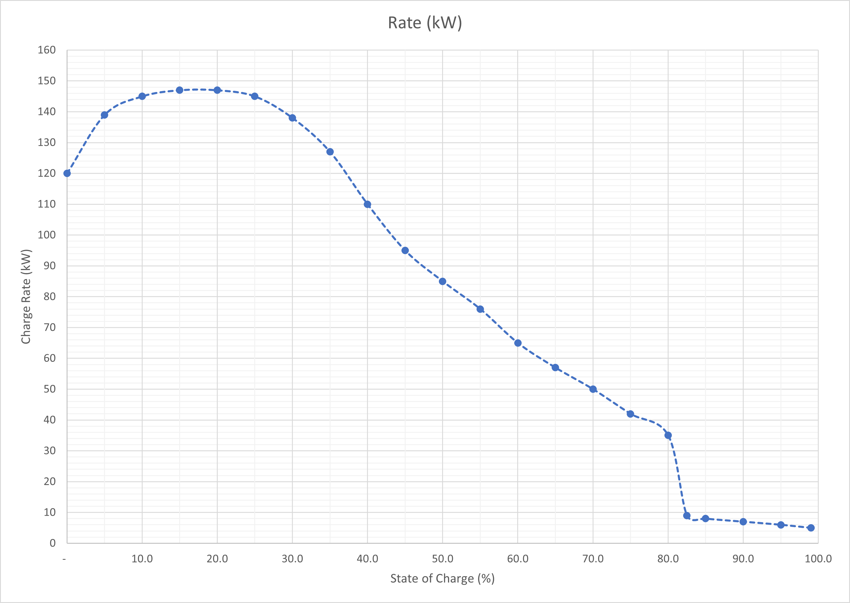

(The same US based figures reworked to plot charge rate vs SoC ... )

According to this chart, the optimal unplug time to save time is between 60-70%.  If the road is suitable for you to take another short break.

Your guess was not far off! Drove from Cardiff to Swansea and back, 100 miles and 40% remaining at the Tesla Supercharger, hoping to get to 80% quickly which would have got me back comfortably to Nottingham.  After abandoning the Tesla charger I reached the InstaVolt charger on 42% Battery and probably could have got home but decided to play safe...
The original charge plot you showed (I have also seen this before) was done at 15C so would be interesting to see how it looks in the -3C to +3C range typical of the current winter driving conditions. Temperature is clearly a big factor affecting both the car Battery management system and, I suspect, the DC charger function. The nice replot of charge kW vs SoC is very informative in selecting sweet spots when fastest charging is needed.
What I am seeing now, after researching, is that the bZ4X loses range in winter just like any other EV but Toyota have left slightly larger margins at the high and low end of the Battery capacity. 200 miles range in current weather is really not bad at all and compares well with other makes with similar battery capacity including Tesla (check out the Tesla forum). We can expect range to improve significantly in summer.
