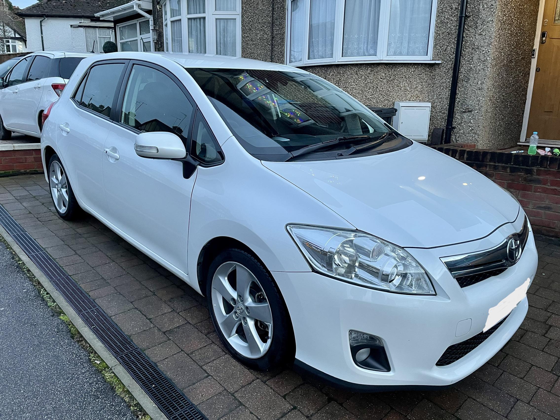

Put on all season tyres today and it largely sorted the harsh ride issue. Of course all seasons are a trade off but I can live with that if I've got some comfort.
  • Like 4

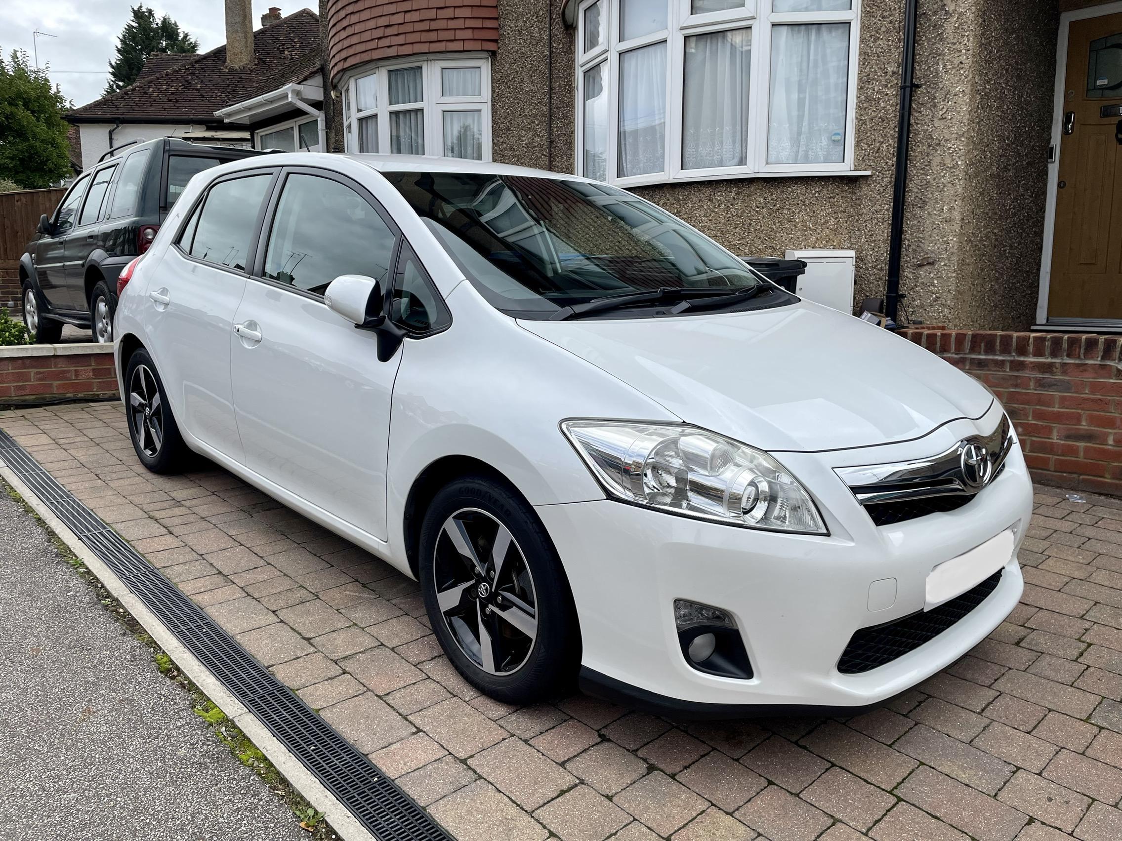

I echo a lot of what Tony has said here. I recently bought a Skoda Rapid (still keeping my two 30 year old Toyotas) and immediately switched to smaller wheels with higher profile tyres. I also switched from Bridgestone to Goodyear Efficient Grip as my previous experience with these was good (I find them very "feelsome" plus I'm obsessed with ride quality. As a generalisation I find the ride quality on modern cars to be harsh compared to my old Corollas. I imagine the main issue is that all the underside components have to be beefed up to handle the additional weight - my old Corollas are very light in comparison - but of course I have hardly any of the modern safety features or equipment 😱. If you then mate the high weight of later cars to large wheels and low profile tyres plus the poor quality of many roads (near us anyway) you have the perfect recipe for surgery 🤣 My old 2CV had it cracked but was somewhat lacking in the momentum department.

On 1/17/2023 at 4:22 PM, TonyHSD said:
Any tyre on any car older than 2-3 years will become harder in cold temperatures below 10C° especially the summer ones will loose comfort and traction. To compensate for that you can reduce a bit the tyre pressures, just a tiny bit but even so the harder old rubber will alway be less comfy than a new one.
All true observations I'm sure. The tyre upgrade (or downgrade as they were premium summer tyres the ones I replaced) transformed the ride to the point where the car has become a pleasure to drive. Not only that, I did not have to run them underinflated to improve ride comfort. They were Nexen n 4 blue seasons and not terribly expensive. Happy because I was so put off by the harsh ride I'd considered selling the car. She's a keeper now though.
