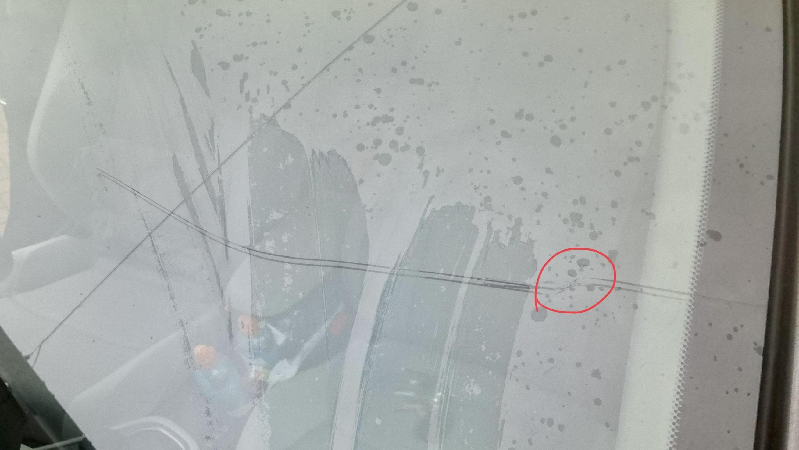

Thanks, but the weird thing about this crack is there is no accompanying chip, just the fracture, so there's no 'dent' to fill in.
I still have no idea how it formed as I've never had a crack like this before - In the past, there's been a chip which the crack then grows out of but this seems to start at the edge and is a clean fracture all the way across!
I can only guess they're using a very tight bonding agent which hasn't let the glass move enough, and it's caused a stress fracture??

I think there is a cheap and sign of stone impact . Here where the crack is bent . On my one was exactly at the corner, and in general the whole car has little holes from stone cheaps, bonnet, bumper, windscreen, roof, roof edge .

Similar on mine. The technician followed the crack with his nail. It was a tiny chip that you could only feel. The reason it cracked was because the impact was about 6 cm in from the edge. Had it hit just a couple of cm further in, the screen would probably never have cracked.
The edges of glass are the vulnerable bit. That's why advice is to hit glass to escape through near the frame, not in the middle.

The stop hole is at the opposite end of the start point.  Couple of points, use some masking tape to stop the drill sliding and mark the end of the crack.  Only attempt this if you can get the drill exactly on the normal.
