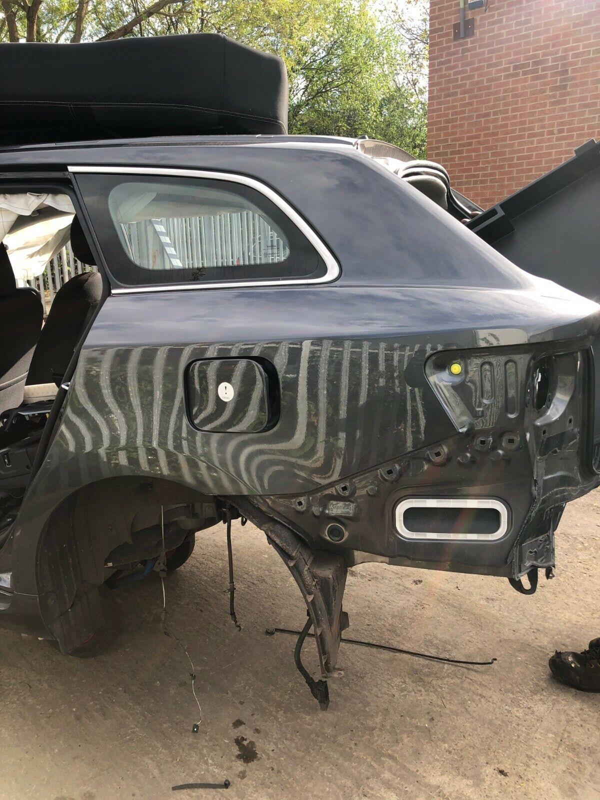

But have just come across an interesting image on the Bay showing the rear quarter panel of a Mk3 estate with the bumper striped off. There seems to be a vent or atleast a drain opening of some sort behind the rear wheel and hidden normally by the side of the rear bumper, the white oblong thingy.
If this has been blocked somehow it could cause a build up of moisture ladden air inside the vehicle allowing water to condense out when the glass cools.

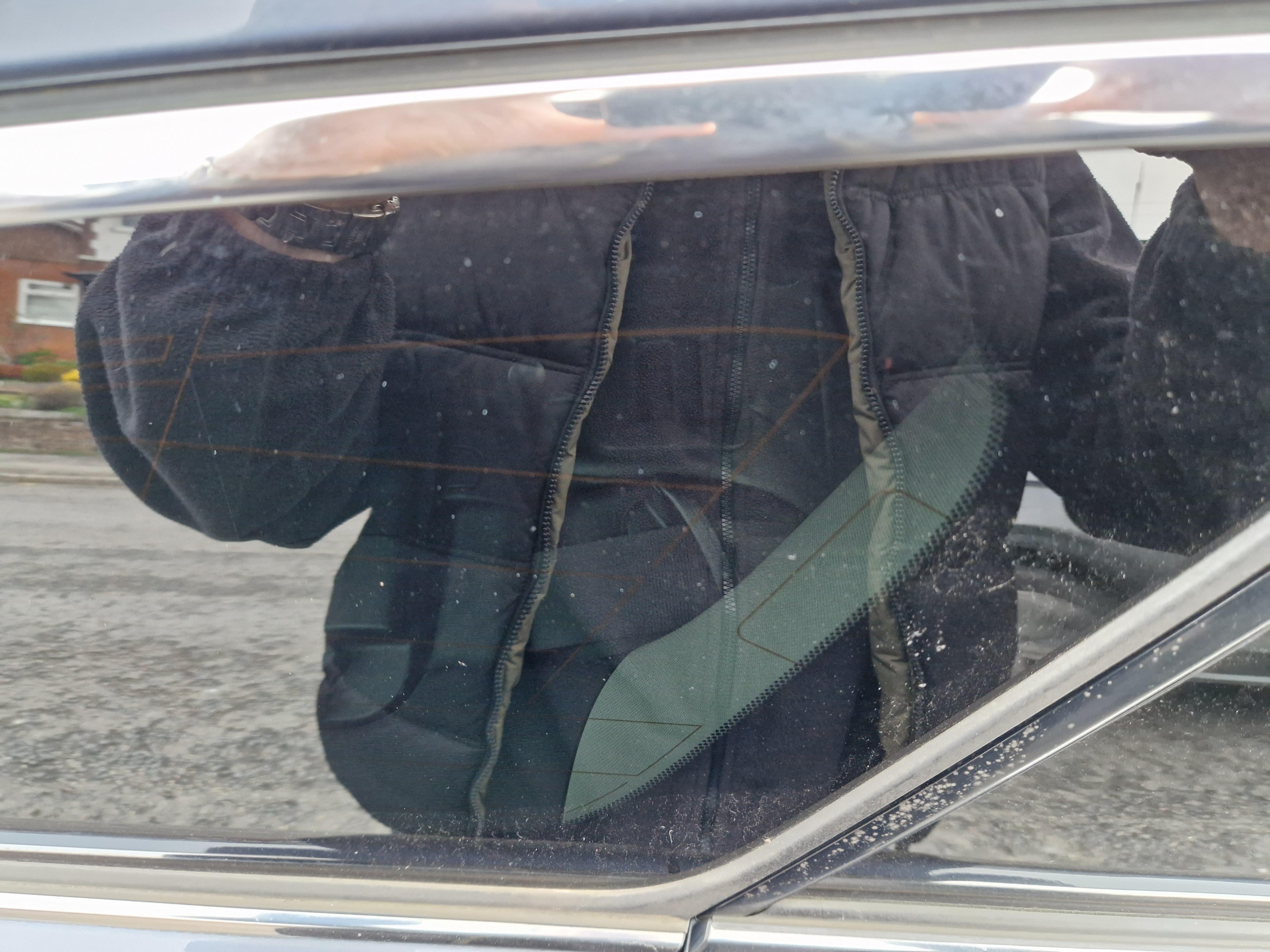

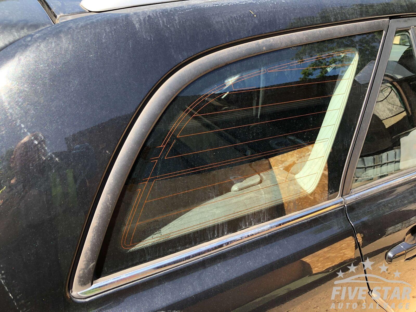

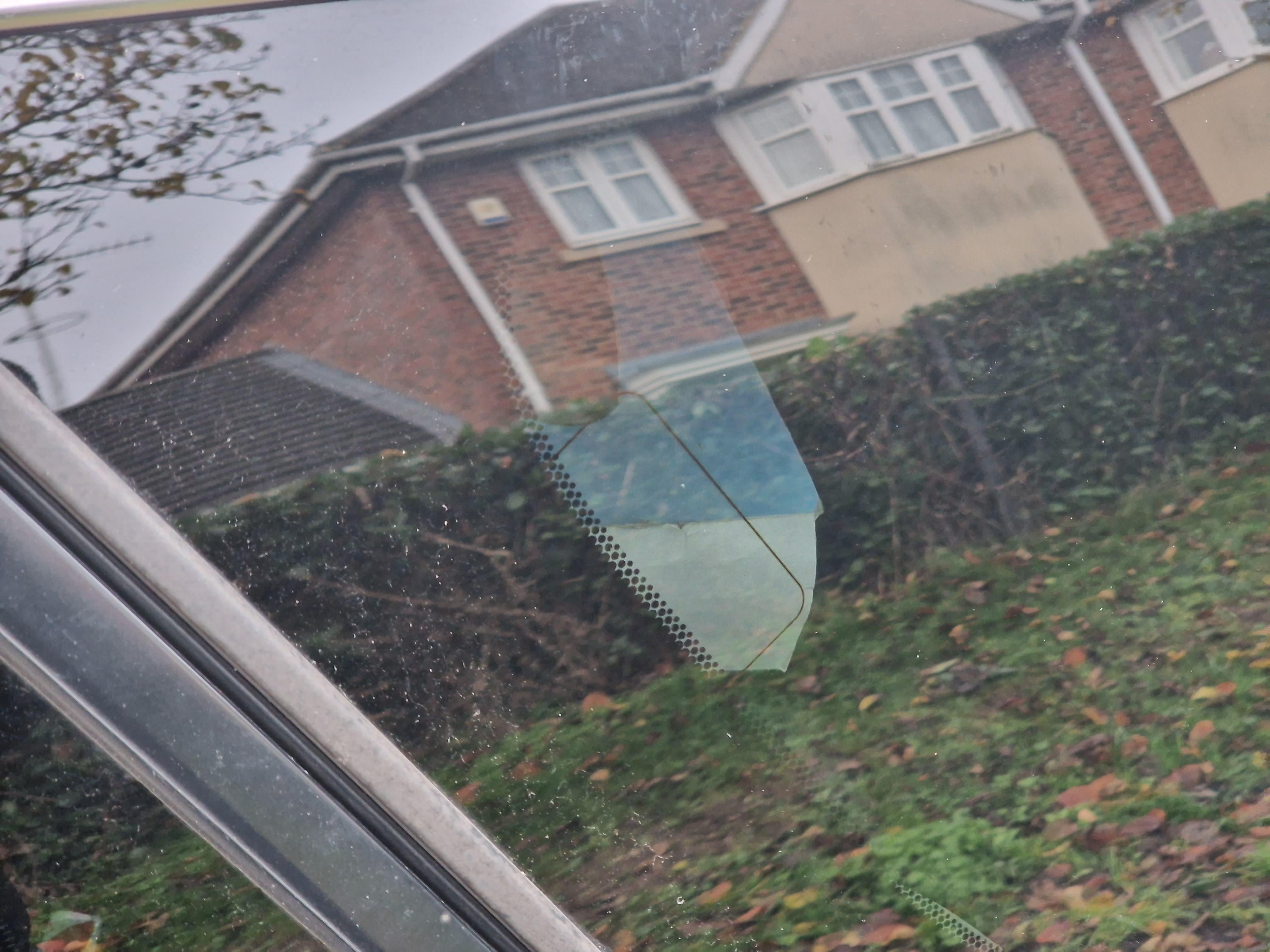

Another question to the group. The rear quarter windows have heating wires in them, but don't demist together with the rear window. Is that an extra that wasn't specced for my car?
Like this
I´ve been told it is a radio antenna? And it should be only in the right window...
At least in my cars (09&12) it is only on the right side.

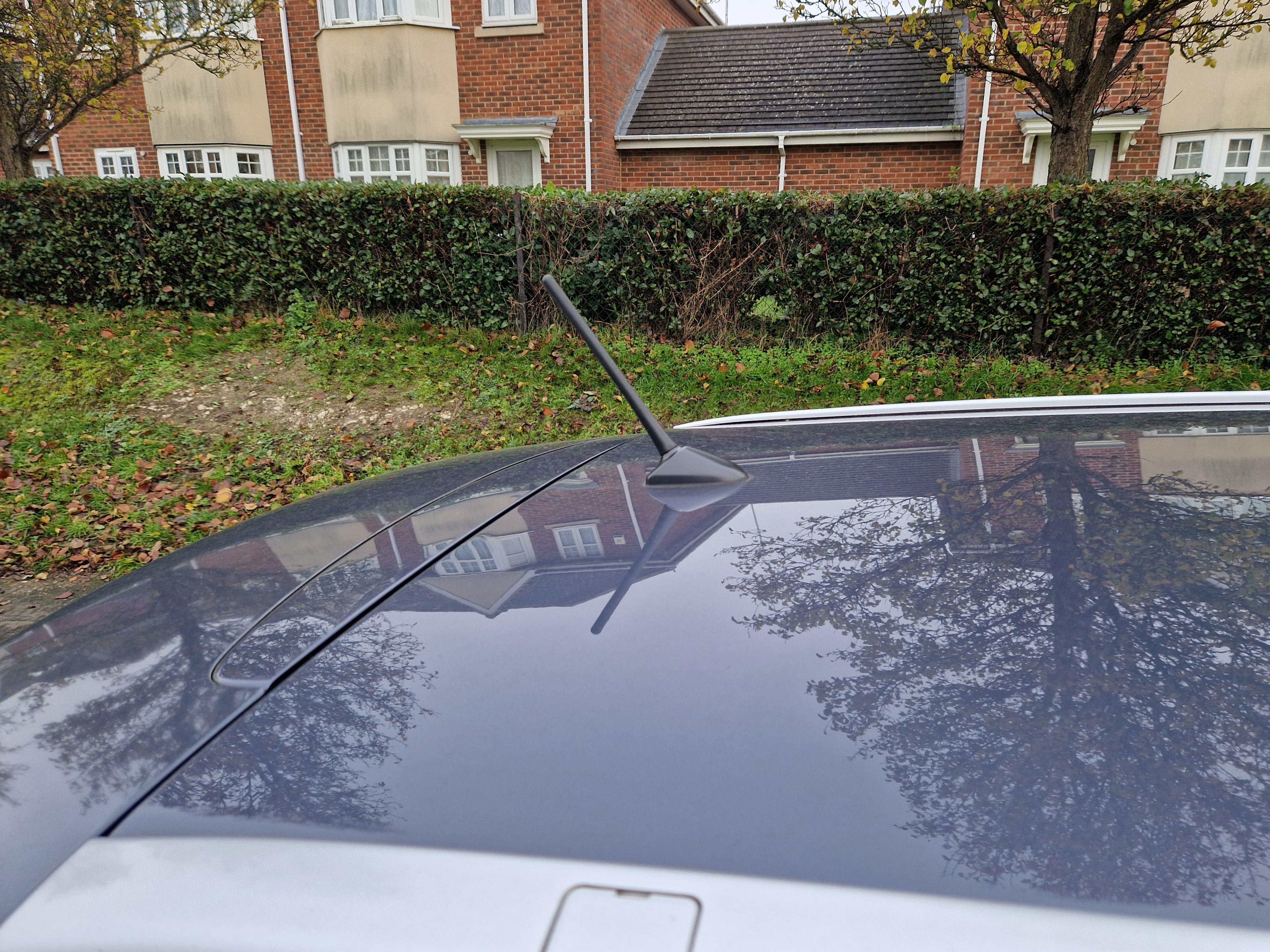

Interesting idea, however I have got it on both windows and there is also a roof aerial. So I'm not convinced that they are aerials.
I have heard of cars where the aerial is in the windscreen around the edges. It makes sense there as it is not blocked by the metal chassis.
I have the radio with the DAB option, but no DAB aerial is fitted. I asked Toyota about fitting one and they quoted me £500(!) in 2020.
Out of curiosity, I looked at the owner's manual, which says that the wagon model has two antennas: one on the roof and one in the rear side window. In the sedan model, the antenna is integrated into the rear window.
However, different countries have different equipment.

A Toyota dealer confirmed to me that the wires in the right-hand rear window of my UK T27 estate are the DAB antenna.
Correction is due. My bad.
The left window does not have the wires all over, just on the left edge. It was bright at the time, the window is tonted and I did not have the key with me to check from the inside 🫢

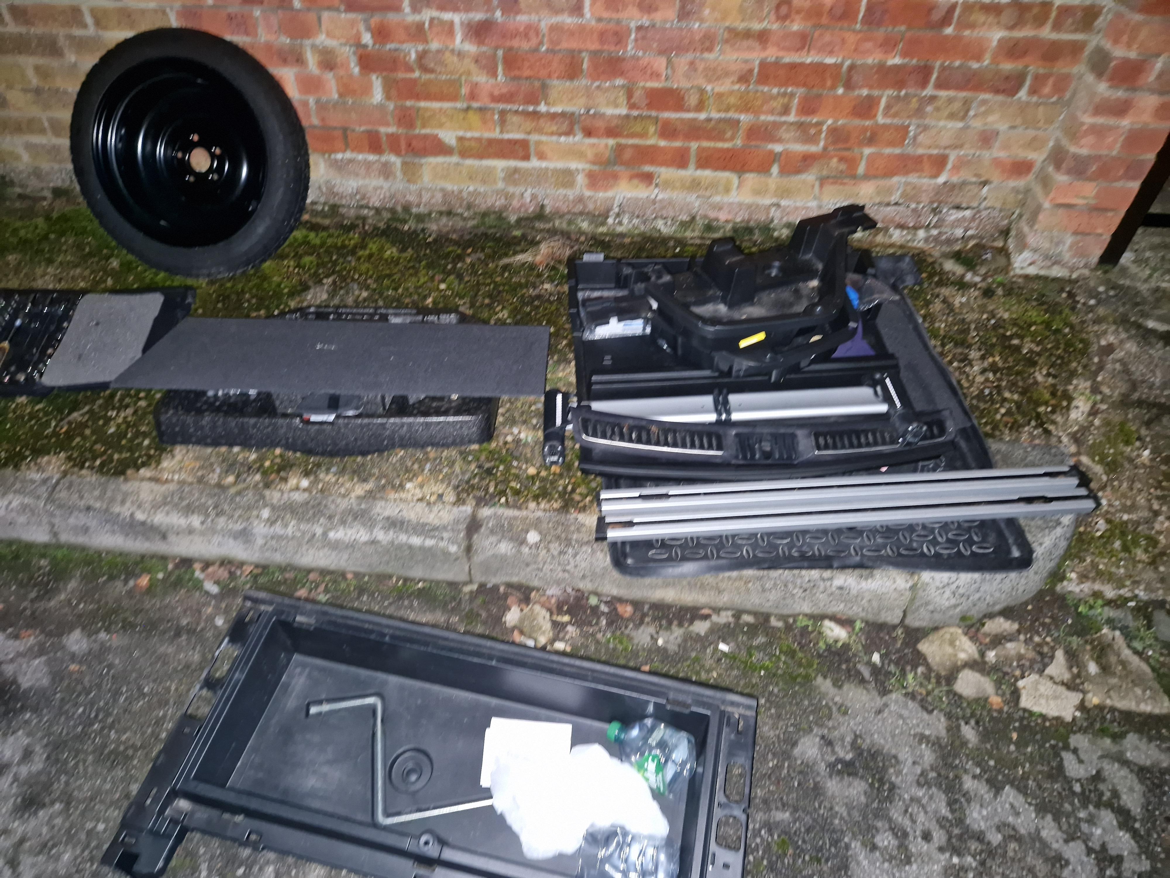

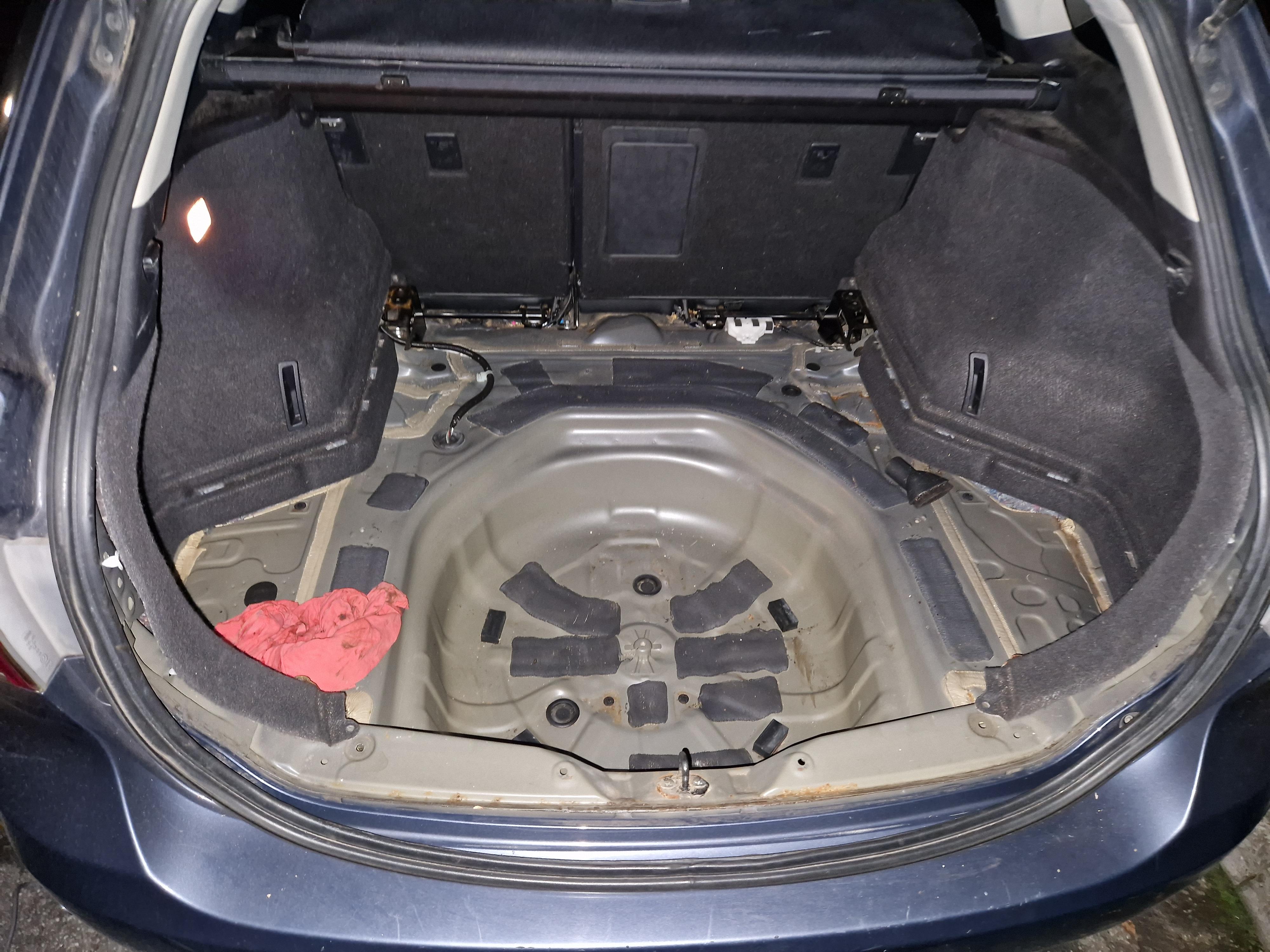

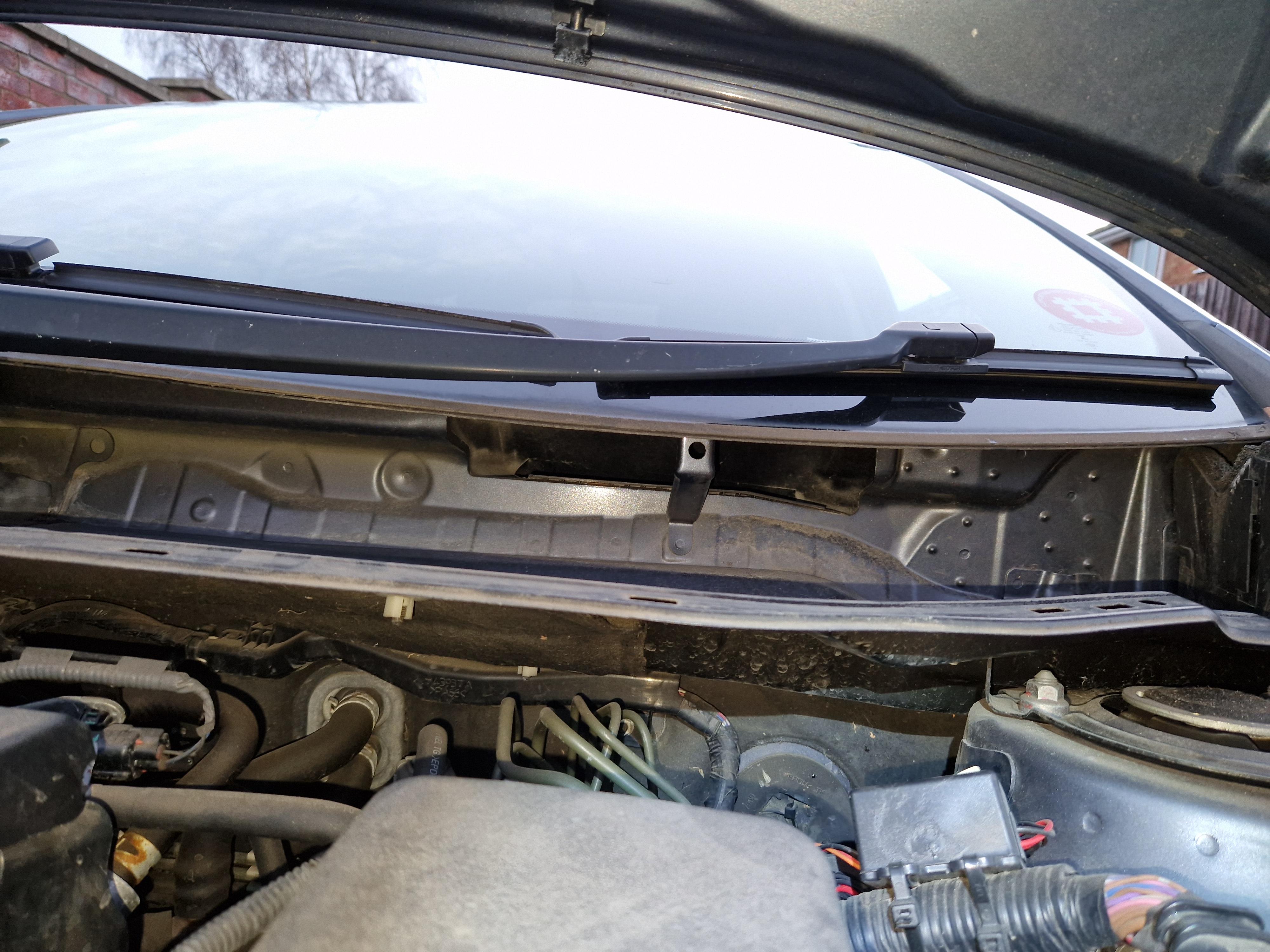

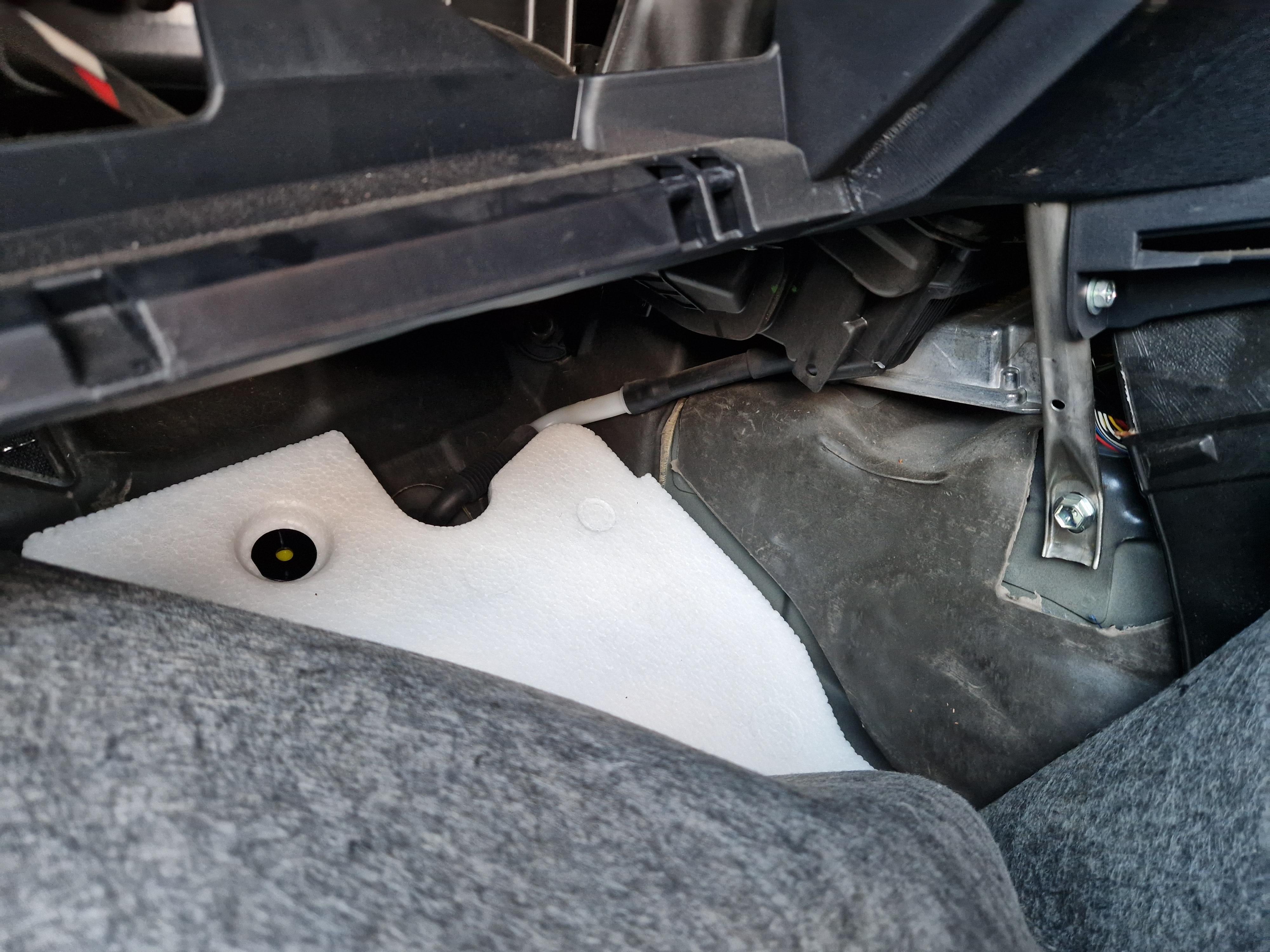

UPDATE
So I had time this afternoon to check things out. Here is what I did and pics of it.
I checked the A/C drain pipe in the passenger footwell. It was bone dry. I ran the A/C for a while, but the air was dry, so couldn't observe it working.
I have removed the left side cowling from under the windscreen, where the blower is taking air in from. It was empty and dry.

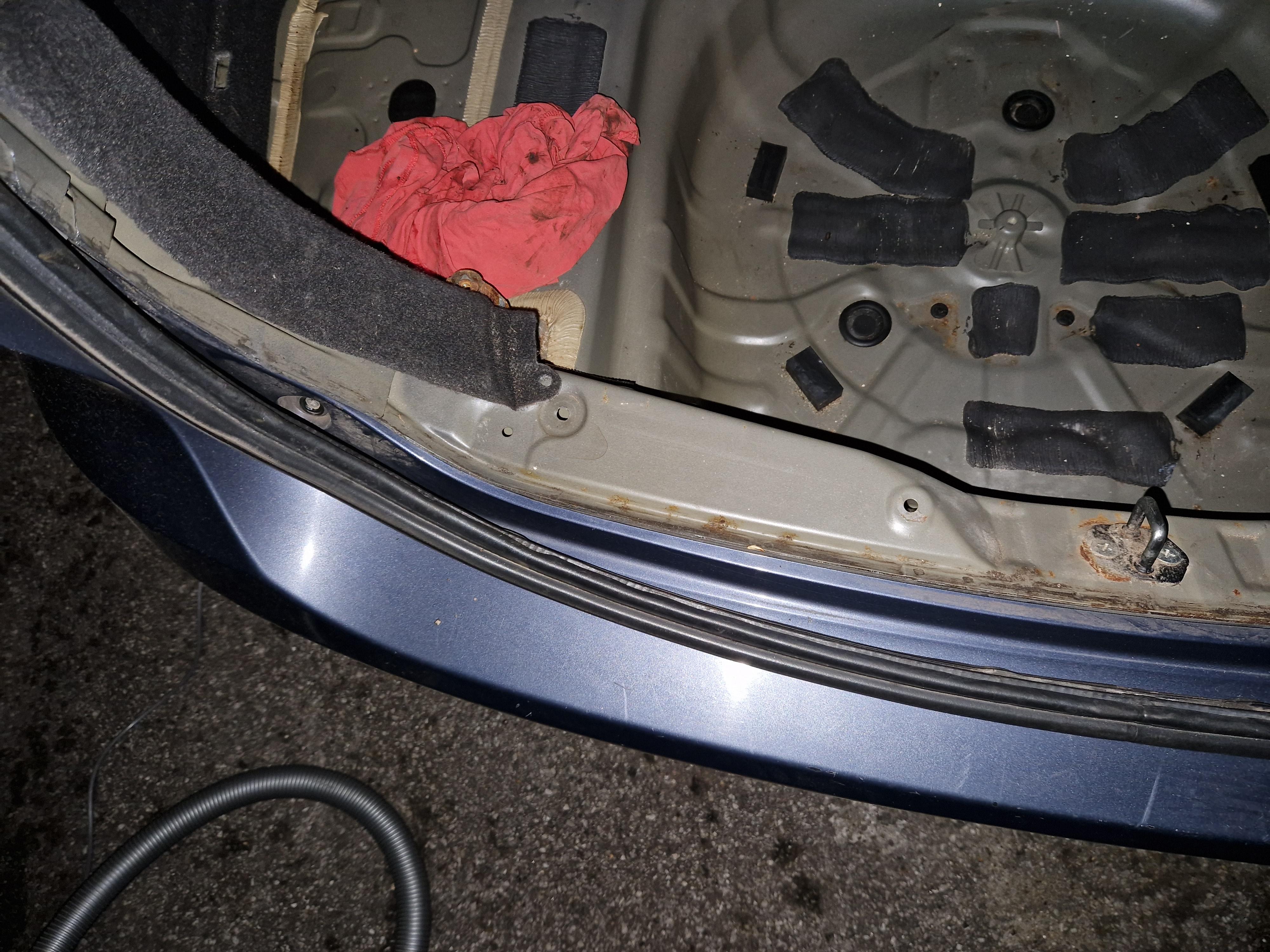

Moved to the boot. Well... Couple of pieces of trim right? Anyways.
The cabin air exhausts are clean on both sides.
However, I have found evidence of water leaking inside by the rear door seal. I think it wasn't it its proper place. Sometimes the door gets stuck and pulls the seal away. Found that the extended outer edge was not in its proper place. At least that what I hope was the reason. Or else the seal is worn or stretched.
So it took most of it out and let it dry.
  • Like 4
Hi Barna,
Just a thought on what you've found. Looking at your first and third images of the lower edge of the rear tail gate opening there is rusting which to my mind would mean water has somehow run up hill to enter the wheel well.
Would suggest before you commit to putting everything back in place, refit the rubber door seal as best you can and then close the tail gate get your garden hose or watering can and douse the door opening with water. Best if you get an assistant to help you, someone inside the rear load area to watch and see where the water is actually coming in. You may well find it's higher up than it seems.
Have just had a close look your third image and looking at the right hand side of the boot there looks to be a stain/watermark on the mastic where the floor joins the body panel just behind the wheel arch. Also just a bit further forward, between your vacuum brush and the back of the rear seat, there's a noticable rusty mark close to the wheel arch. Is it possible the drivers rear quarter glass seal is leaking also?
