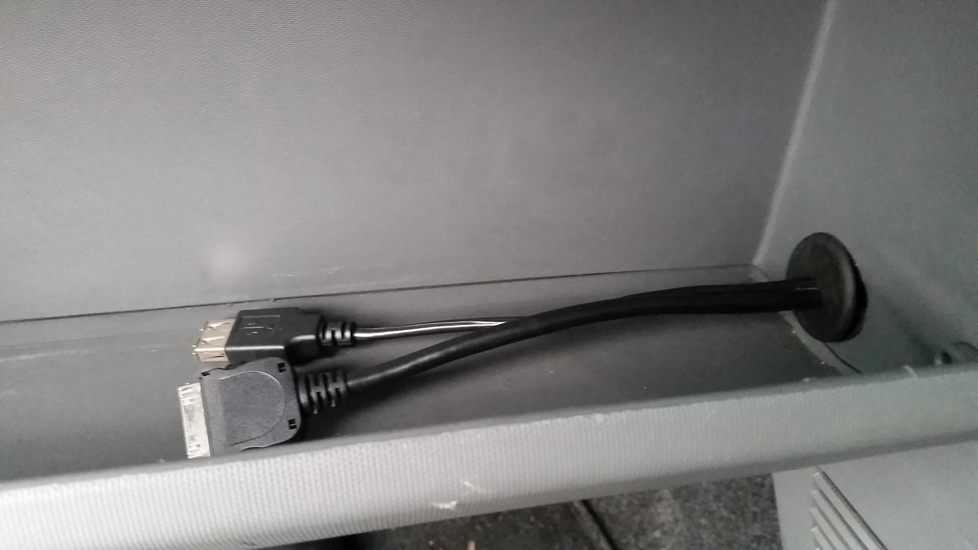

does the cable just come out of a rubber grommet by the shelf/glove box ?

There are two cables that come out of a rubber grommet. One is the iPod cable, the other is a female USB connector for thumb drives. Both of which I can navigate and control via the stereo and the TomTom. Using the TomTom is quite convenient and the only thing I use it for.
When I plug the iPod in, it may light up, so is getting power, but often when it doesn't work, there is no power to the iPod, so I assume there is a problem with the cable. If I bend the cable back on itself a bit, the iPod will come to life.
I have looked online, but not sure exactly what I need, but I'm hoping the cable can be bought by itself.

Ah, it's the media connect option as it has USB as well as the iPod, yes the cable unplugs
PZ49Y- 90330 - 00
Destructions
https://www.toyota-tech.eu/aimuploads/{5FAB63BF-78E8-4150-1EE8-5165CE8578E8}/Aygo_Connect_Multimedia_RHD_PZ49Y_90330_00_AIM_002_057_0.pdf

Thank you for the info. The link is brilliant and will be very helpful. I'll probably get the one I saw in eBay, and hope the cable is okay.
