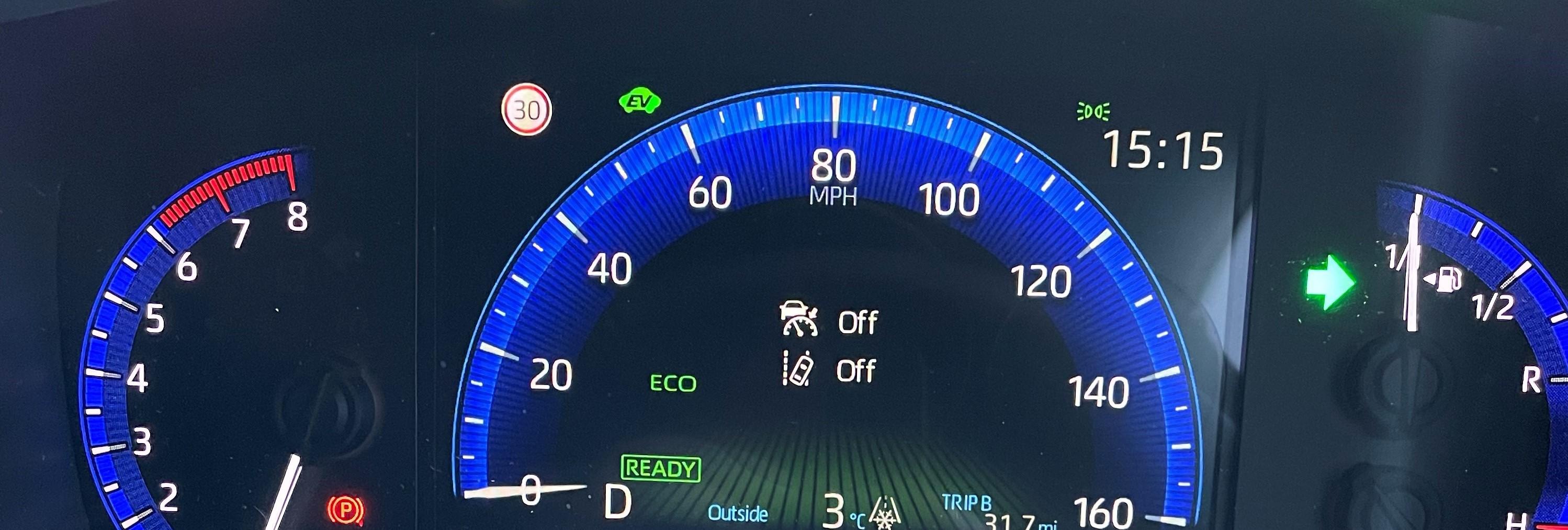

Hi Guys
Shortly after the onset of cold weather my Corolla is starting to throw wobblies. After starting up yesterday for my normal daily run my car starting to misbehave. The first was i could not restart the engine after stopping at a large road obstacle and after repeated attempts the Corolla threw up these "off" messages and decided to restart and i was able to move on. After arriving at home i was unable to lock the car using the remote and had to lock it using the supplied key. This morning i discovered that the problem was not a fully locked rear hatchback door now the warning that this was still open was not displayed on the screen yesterday when i repeatedly tried to lock it yesterday but gave a long beep. I undestand the screen warning indicates "hybrid failure" so can any of you kind gentlemen tells me what that means ? is it Battery failure ? Battery needs charging ? The car display shows the engine charging the Battery. i did have the smaller battery replaced this year in the summer as it had failed.

Perhaps low voltage in the 12v Battery. Not able to lock with the remote because of one door not been properly closed, did the car sound continuously beep to warn you about that ?
The two OFF messages on your screen means cruise control and lane departure warning are off.
That could be because the camera is obscured by snow/ice/condensation.
The long beep when you try to lock indicates a door is no closed properly or a key left inside the car.
Those are messages you can get up by using the steering wheel buttons.

This is correct. You do not have a 'Hybrid Failure'. I reckon it's a weak 12v Battery as Tony has suggested. Get it checked out as when voltage gets low they tend to fail quickly especially in this cold weather we have have now.

Perhaps the car did not recognise the key fob is nearby, sometimes when cold or key fob been placed to magnets or credit cards can turn itself off and stop sending signals to the car. Even when you press unlock the red indicator may not show any signs of life. Just happened two days ago with mine. , been resting my iPhone with magnetic case on the key fob, such a mistake. 👍

Thinking about it, this may be what has been causing you the problem. Rather than a 12v Battery failing it may well be a key fob Battery failing instead. Interesting.
